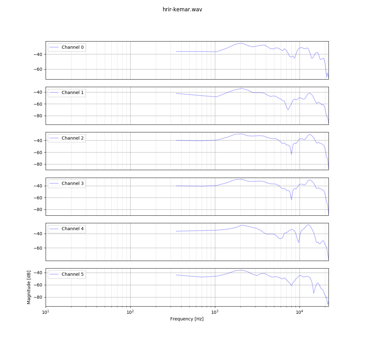

Would it be possible to use the Pulseaudio module-virtual-surround-sink? It's not intended for multichannel out, but as per the code it does support multichannel convolution.

Does the virtual-surround-sink actually support convolution?
I only had time for a quick look through the source, so may have missed it, but it looked to me like a "simple" mixing filter.
Would be grateful to have the convolution aspects here pointed out explicitly. Thx.
virtual-surround-sink folds the input with a multichannel impulse response, normally a HRIR (head related impulse response). Isn't that convolution?
Kindly look for procedure sink_input_pop_cb in the code on github.
Yep, I just missed it (time domain convolution) - pulseaudio/module-virtual-surround-sink.c at f18b0c3402f5e1f7db9d0a42c6e10cfe1f212da3 * pulseaudio/pulseaudio * GitHub
