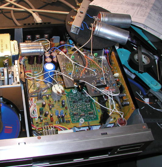

Today I put the whole circuit inside the Marantz player (using the player's power supplies) and I was totally disappointed. The fine detail, relaxed presentation, smoothness, everything I liked about this DAC, was gone.

I tried choosing different points for taking raw supply for digtal (small improvements, but not to the point I remembered from before) . I tried using Kwack clock (instead of Raltron clock) for reclocking (didn't noticed major difference). Connected the outboard supply for digital part of a DAC, improvement but still not what it was in the beginning. I was almost ready to remove the board and use it as a separate DAC, like I had originally, when I decided to try one more option. I connected the external analog supply (for I/V stage). This supply consisted of toroid transformer, best Panasonic caps available and MUR860 diodes.
I put the music on and finally it sounded as I remembered it from previous day, maybe even better

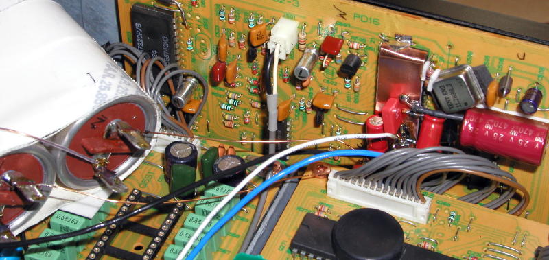

Which leads to conclusion that analog supply in a CD player is pretty important. BTW, those caps were removed from top line Technics transport ($ 8,000) and it says for Audio on them. Those are the only caps I found so far that don't have the plastic jackets on them, but are painted black directly on the aluminum body. Would it be done this way for no reason?;)

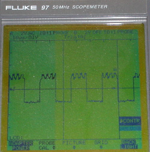

While I was testing I2S signal, this is what I observed on Fsync line coming out from SAA7210. Any idea how to fix it?
After reclocking, the signal is fine.
Hi Peter,
Can you explain the problem? Some parts of the curve are hardly visible

I'm not sure, but I think before installing Kwack clock the signal was fine.

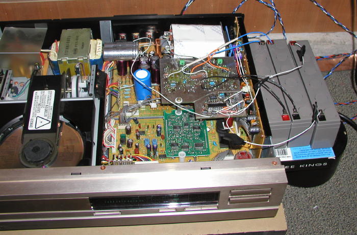

Here's update on my setup.
I managed to squeeze output caps inside player (wrapped in white tape at the back).
I cut the spaces on the board (as recommended by Rudolf) to devide digital section from analog ground plane and the improvement wasn't subtle. The feeling of being there and imaging improved.
As you see, I'm using batteries and I think it is improvement over the regualr supplies. The sound is much more coherent, more detail and better bass (also increased smoothness).
I used three 12V cells. The analog section gets the power bypassing the regulators. I plan to omitt LM 317 preregulator and connect 6V cell directly before low drop reg.
Also, I added 50ohm termination resistors (50 ohm) on the output of SAA7210 chip. According to Pete Goudreau, it was major improvement in his mods on a DAC. I also connected separate clock signal directly to the SAA7210 chip. When I listened after that change, I wasn't sure if it was an improvement. Somehow the sound lost it's immediacy and was more distant, less airy and image decreased somewhat. So I decided to introduce one more change. I disconnected the separate clock (running at 24xxxMhz and connected to reclocking circuit) and connected the main KC7 (inverted output) to reclocking circuit. Now, this made a major difference and things improved substantially.
I got the microdetail, air, space, feeling of being there, immediacy and everything became much more coherent. This seems to be the best version so far and the batteries will probably stay. When I switch back to regular power, it seems like the sound is polluted somehow.
