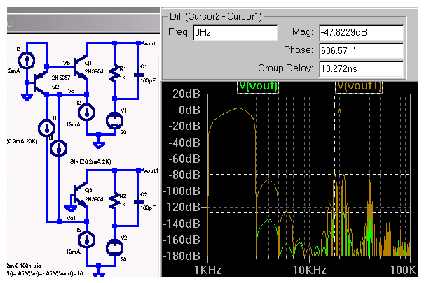

with all the concern about sufficient gain and compound transistor pairs I think the Baxendall “Super Pair” might be worth exploring in this common-base type circuit, I point to several posts of mine about it in:
http://www.diyaudio.com/forums/showthread.php?s=&postid=220909&highlight=#post220909
And scrolling down to post #236 shows the VAS stage application, but is should be easy to see how to use the super pair (I think I’ve seen it called a “complementary darlington” too) in a common base or cascode type application

jcx said:super pair common base "cascode" I/V
2 & 20 KHz 1:1 2mA each
baxendall super pair harmonic & IMD > 40 dB down vs single Q
OK jcx stop showing off 😀
These results will be heavily depedant on DAC OP Z.
For PCM63/TDA1541 around 1k, will challenge things
somewhat.
.... but we get the picture as a current coveyor
*with the right conditions* it is very good. 😎
Terry

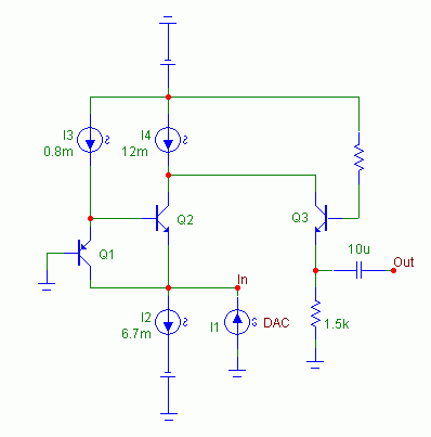

JCX, Terry,
Is the super pair susceptible to oscillations like the CFP ?
Does one need stopper resistors on the bases, like 22 ohms or so ?
Is there a ratio between the PNP bias current and the NPN current, or is Q1 just set at typically 1mA and Q2 whatever is needed for the application.
I might prepare my next pcb I order to try this:

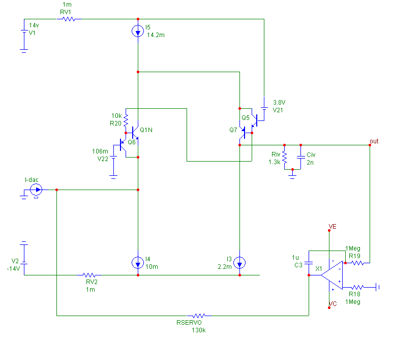

Hello JCX,
I must admit that I don’t know what the Baxendall is, but that circuit is definitely nothing more but the one half of the diamond transistor or, more precisely speaking about this application, the diamond buffer. It is known for decades (Hiraga 20W class A was published for the first time in 70s, Mr. De Groove might provide exact date; the Application Note 227 by National Semiconductor is dated October 1979) and is known not only for the good measuring results (though it indeed measures well), but also for its excellent sonics.
The distortion results you are getting in the simulation will differ importantly when, as Terry pointed out, you take in the account an ugly low output impedance of the DAC (that’s the load), so it will be good to put a few kOhm resistor in parallel with the current source that simulates the DAC’s output. In this case, for the total amount of the distortion (if the H and IM distortion that matters), per se distortion of the circuit might play a minor role and some other stuff might be more important.
Attached another option.
Pedja

i must admit to playing with the super pair more in simulation than hardware but i have used it in several prototypes without obvious problems
Hawksford does some analysis, but i don't recall comment on stability, some op amp designers have hinted at its instability, but all such comments come before the widespread use of complementary bipolar processes so it may be a consequence of the really poor lateral pnp in '70's IC processes
jcarr gives some bias suggestins in the PSRR thread i pointed to in the earlier reference pointer
certainly the "trick" depends on the current division ratio between Q1 emitter and external source impedance but at 26mV/10mA~=3 Ohm emitter R, a 1K source impedance gives a current division error that is only just approaching the uncanceled Hfe errors of the circuit, in simulation the super pair seems useful in VAS stages with as low as 100-200 Ohm emitter degeneration
