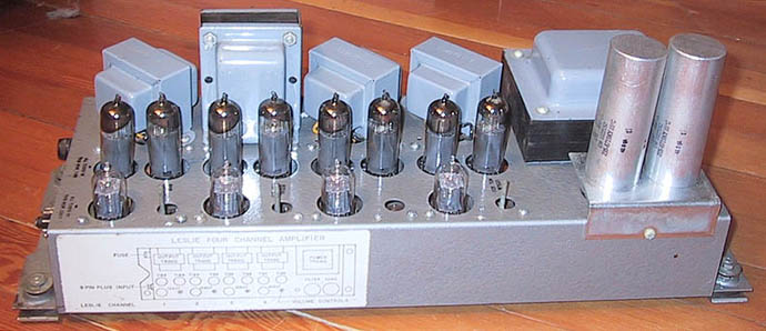

I've been offered one of these but know nothing about Leslies and can't find any info on this model on the net.
Does anyone know what kind of amps are in these. I believe it has four separate channels of amplification.
Also, where does it fit into the Leslie lineup? Is it a desirable model?
Thanks!

The model number means nothing to me, but the mention of a 4-channel amp does.
There are 4 PP 7189 (hi-voltage EL84) amps with a common power supply, 1 of which has a larget OPT for driving the bass unit. Input tube is a 12AU7. Each amp is on its own little circuit board.
The number on the amp is Type 6148-1.
