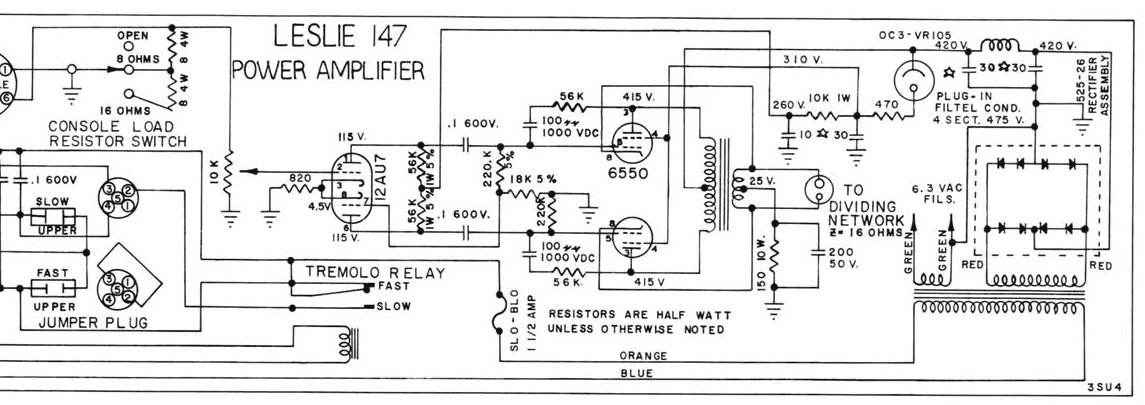

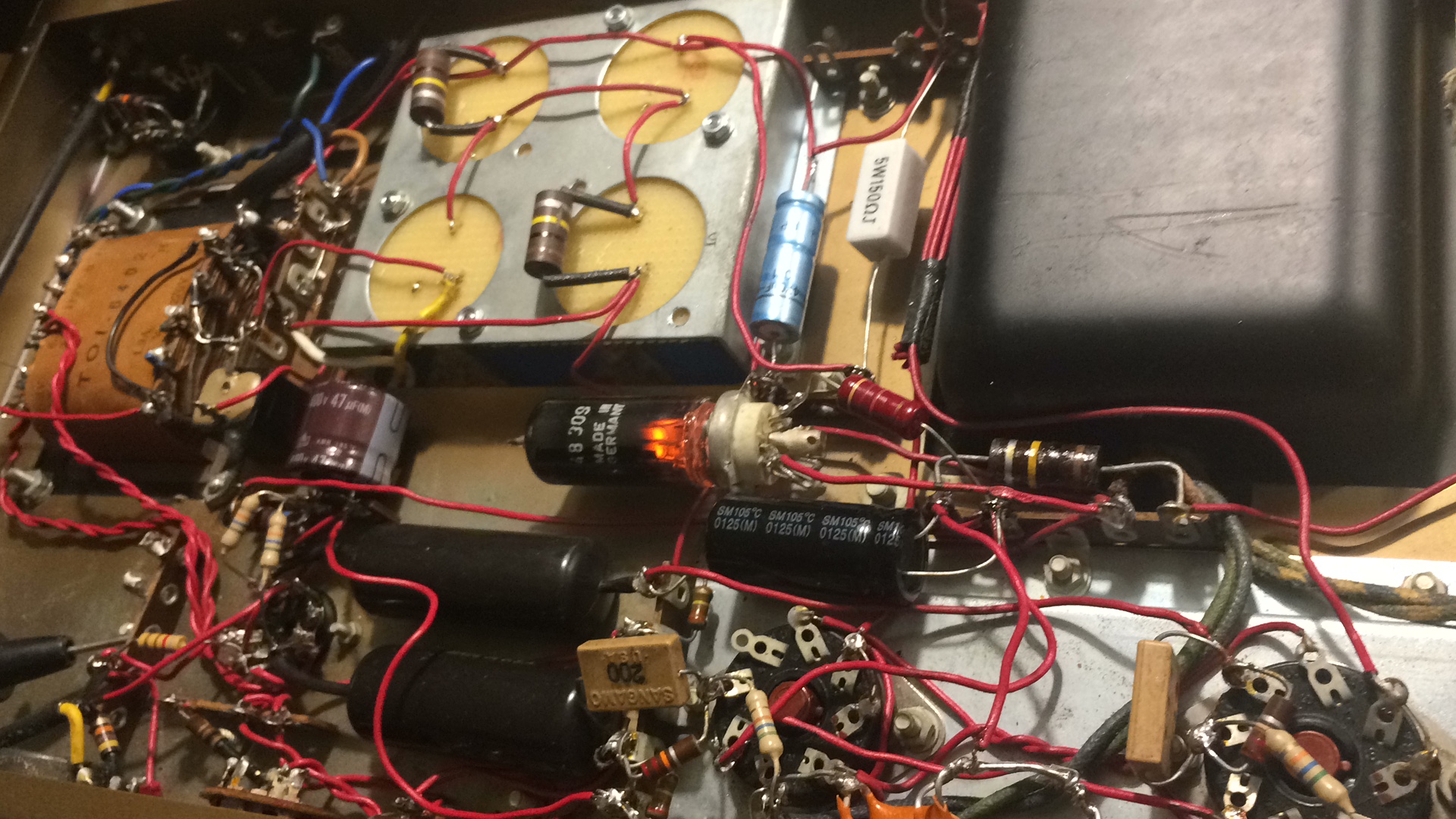

Hi folks I'm new to the excitement and knowledge of this superb forum! I'm a Hammond organ enthusiast, with a lifetime of interest in audio.... I have a organ speaker Leslie 145 -6550s in push-pull, fed by 12au7 - which has distortion badly. I have 398v on the rectifier output (shows 430v on diagram). This gives 23.4v on speaker output to ground rather than 25v. Tried shorting the 470 ohm resistor from the OC3 to the 6550s but no difference. I'm running a non-standard O/P trans and power transformer, but not sure if this matters Valves are all new, with new power capacitors too (very large values - all 150mF for extra smoothing) I only shorted the 470 because it had been missing previously - wired out. It's not worked since I had it - it came to me with no valves, missing o/p trans, filthy. - and no relay, potentiometer, etc.
The output transformer is correct spec - mostly supplied for kt88 style guitar amps like Vox, but right windings and impedance. The power supply transformer which was in it buzzed and immediately got very hot and smelly, so is almost certainly failing internally. I've replaced it with one from a Hammond L100 amp chassis, which has a 315-0-315 secondary, as well as 5v and 6.3v windings.
I've used one half of the 315 side, and the 6.3 for heaters. Heater voltage is fine, secondary measures at 319 for the HT, and then almost 400v after bridge rectifier. I haven't changed any resistors - the ones i checked measure ok. The coupling capacitors are ceramics and orange drops, which i haven't changed. Any thoughts guys? Appreciated

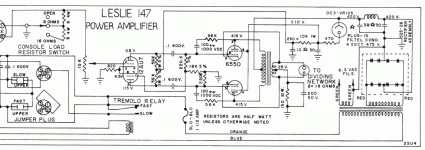

Leslie organs and amp numbers overlap. I found a 147 which may be similar to 145.
The "25V" is actually the self-bias on the 6550s and 23.4V is all the same for now.
The "470" is critical. Without it there is no power to G2 or driver. With a short in place of 470 the gas-tube may oscillate bad.
The OT p-p load should be around 5k, not real critical. BUT the secondary winding on the Hammond is NOT a common 4-8-16 winding. It seems to be 16r CENTER-tap. The centering is vital (a 4 tap may or may not be close enough). The phasing is critical or it becomes Positive FB which is bad.
There is a 8 ohm dummy load on the input which sure would distress any normal preamp but it can be switched-off.

Yes, the amp is a 147 type. The common schematic online is correct.

As the L-100 uses a 5U4GB full wave rectifier or something like that, I'd just convert the 145/147 amp's PSU for full wave. Get two 1N4007's in series from each plate winding end to the first filter capacitor, connect the CT to gnd and you're done.
To keep the final stage's design with your OT substitute, connect it's 4 ohms tap to the cathode bias combination, the 0 or Com end to one cathode and the 16 ohms end to the other one. If the amp oscillates, you need to swap both connections.

You mustn't change the value of any of those four 56k resistors. As plate and feedback resistors, respectively, they're critical, and altering their values also will alter the amplifier's sound. Try my suggestion, I think the DC voltage will be close enough to 420 V.
Does the stock rectifier feature 8 diodes, as per schematics, or just four, as I've seen in a 122 amplifier that I owned until January 2013? Howsoever, as I don't know the stock diodes' specs, get four 1N4007's for just a few cents, and they will do, even without voltage sharing resistors.

He's got distortion "badly". He's within 10% on B+ and on cathode current. While that will give lower numbers on banch-test, "badly" to me implies a deeper problem-- at 10% low it should play fine up to a quite loud level.
Still waiting on pin voltage readings and a proper resistor in line with that gas tube.
I don't know why the factory 56k resistors were changed without checking voltages *first*.

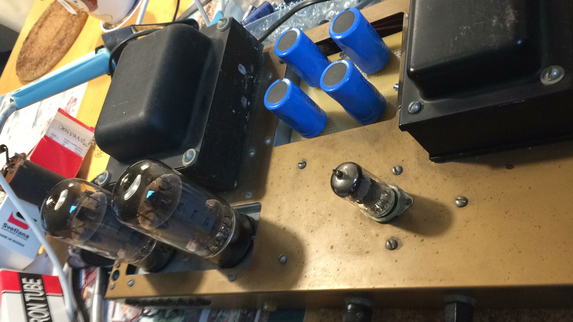

I did indeed convert to full wave rectifier, just to use all of the transformer winding. Slight improvement, not dramatic. DC voltage is 405 where should be 430 on B+
I can play in treble register softly without much distortion, but adding a bass note makes it fuzz up like a guitar amp.
Max volume, distorted as it is, is around half what a normal Leslie 145 would do.
So I'm feeling there must be more. I've replaced all valves... Checked all resistors and replaced a couple. I think it's in the output push-pull pair of 6550 valves, because I have modified the resistors on the 12au7 to give correct 115v (easily changed back, and it did make a 30% improvement to problem distortion)

Could you solve the issues you had with the amp yet? In case not , do you have a schematic with ALL dc values you have measured in yours? It could be that the input tubes are getting overloaded already and not the output stage. Is the speaker anywhere grounded?
Attached my Leslie clone (Heathkit donor amp).
