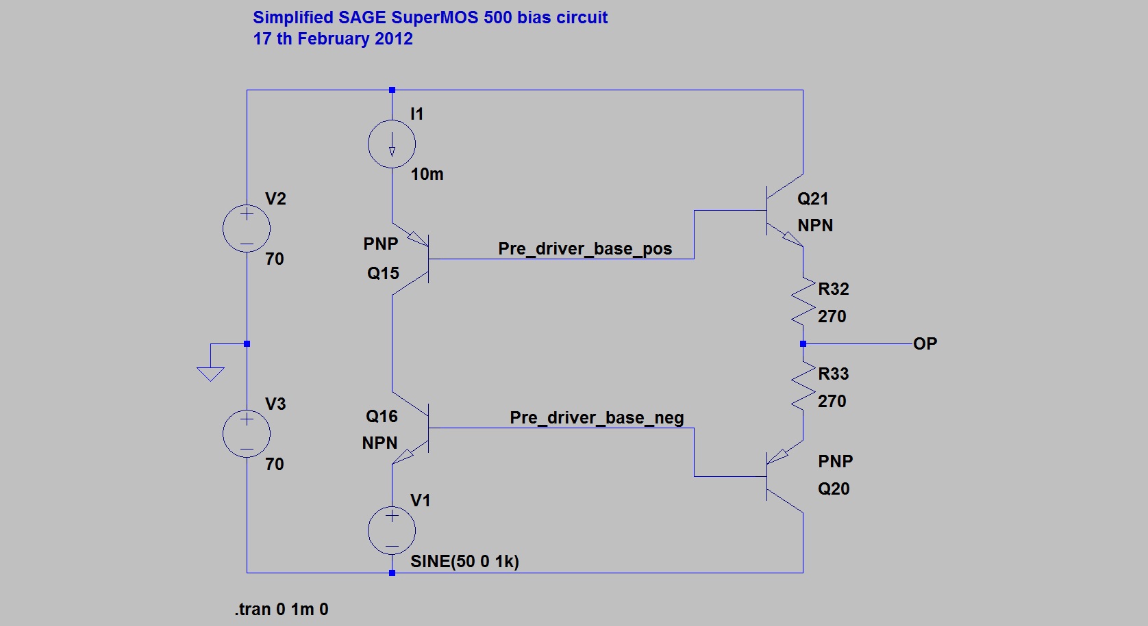

I'm not convinced that the SuperMOS 500 will be stable in real life because my crude calculations show about 40 dB of gain at 20 kHz. I would like to see some simulation results such as a Bode plot or ideally a family curves at different operating levels.
I think that the bias circuit relies on HFE ratio matching that's why selection was necessary. I have attached a picture showing my interpretation of it.
I'm sorry I didn't really explain my thinking. No I don't think that the Vbe of Q15 and Q16 is setting the bias. I think that the bias is set by a current source and some transistor current gains hence the requirement for measuring and matching components with RV2 allowing a minor trim.
I am referring to the SAGE SUPERMOS 500 schematic. My explanation is that the current source formed by Q13 and Q14 shown as I1 in my diagram (I could have labelled it better) sets the current through Q15 and Q16 to about 10 mA.
R24 and R25 and the preset RV2 have quite a high resistance so have less effect and I omitted them from my simplified circuit.
The base current of Q15 (labelled Pre_driver_base_pos) and the base current of Q16 (labelled Pre_driver_base_neg) are then defined by their collector currents, collector to emitter voltages and temperature and should be relatively stable.
The base current of Q21 is defined so it's current gain sets it's collector current. Q20 is similar.
Any imbalance in base currents between Q21 and Q22 is corrected by the overall amplifier DC feedback loop.
The output MOSFETs Q22 to Q27 bias then depends on the voltage drops across R32 and R33 caused by the bias currents through Q21 and Q22.
I don't understand how the 'Active Class A' is supposed to work though.
Alternative explanations and / or simulations are welcome.
