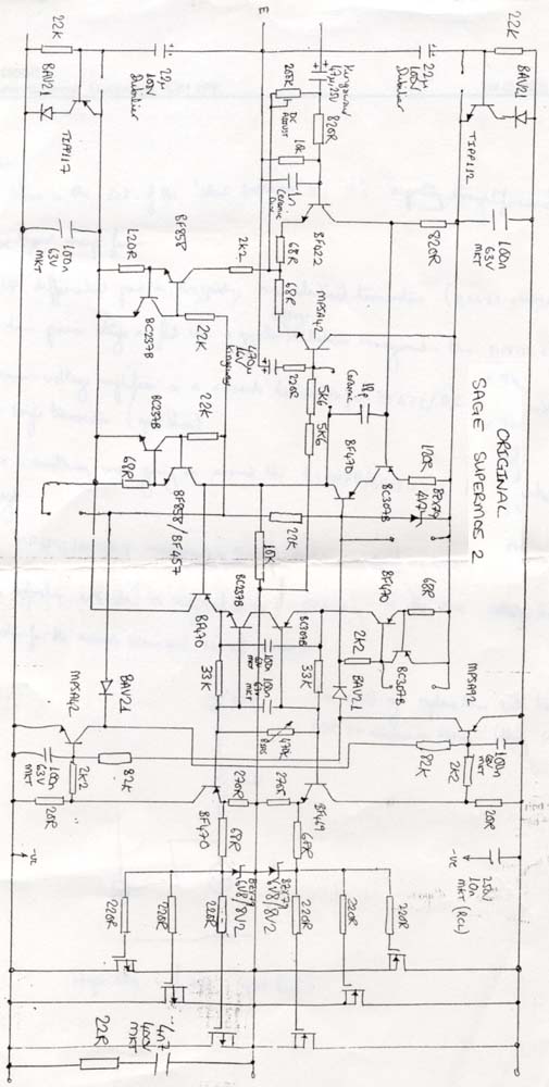

Les Sage amp circuit here for analysis
Hi eclnj,
Excellent. Thanks for posting.
Well, at last we can see that Les was talking out of his ***, even on his top design.
Pity really. His idea of a "hyperbolic function non-switching driver block" would be the holy grail for me.
I can't believe he so blatently had a zobel network & and an electrolytic input cap! shame.
How did your amp die ?
cheers
Andy

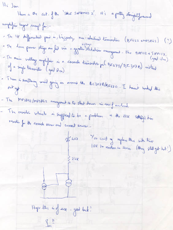

  • A Schematic for the Supermos 2 amps from a friendly chap who has ‘de-potted’ the module
  • A short letter from the same guy which includes a brief description of the design and possible causes for premature failure

Thanks for the info. I too loved the sound of my amps. I think that the very compact layout possible with encapsulation allowed him to get the best out of a traditional class AB design.
My anger was more from an engineering standpoint as I am a designer and wanted to see that someone had managed to make a neat non-switching configuration. (Hill Audio managed non-switching but needed coupling transformers to drive each transistor bank, they too sound great)

3) A short letter..........a brief description of the design....

Now I look closely my handwritten schematic looks identical to that posted by eclnj earlier.
Scematic:

No surprise to me that the circuit is pretty much the same as the 'bog standard dsign' supermos500 posted earlier.
The comments letter from your friend reflected that.
The letter from Les had no technically useful comments but I have to agree TOTALLY with his comments on the hi-fi press.
