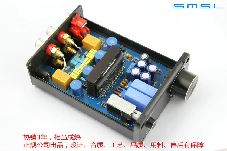

consider avoiding these inductors
See the blue inductors, those ones are not good. If you do not connect amplifier to speaker, just play some music, you can hear those inductor making sound, which is a bad indicator for extra nonlinearity. I replaced them and the sound improved.
Those of you who are not good with soldering and assembling but prefer a high quality Tripath TA2020 amp can consider the SMSL SA-36A.
Not to get too off topic but do you know if there is any common consensus about the inductors used in this YuanJing board with a TA2020.
They seem to sound better than the ones that came installed in the LePai TA2020A+ that I have, but I wonder where they fall in the list of inductors from worse to best.
See the blue inductors, those ones are not good....
According to SMSL specs, those blue ones are TDK inductors. I thought TDK makes some of the better inductors.
