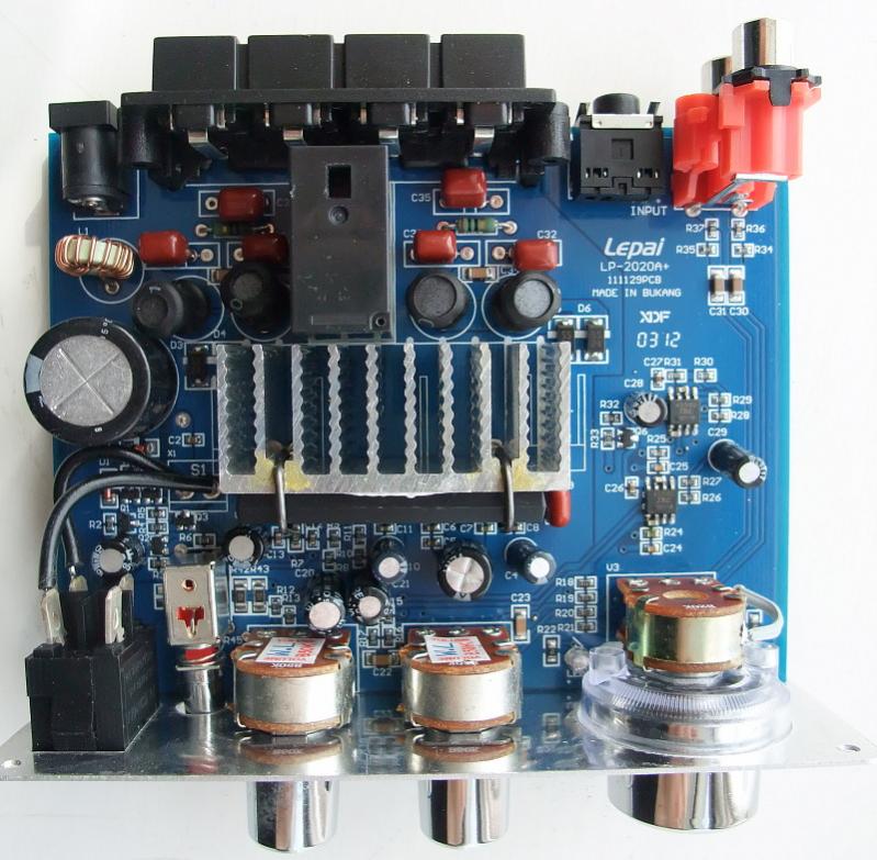

Just received one of these. Using it with old Kef Coda III speakers that I was using with a Nad 3020 before it stopped working. I didn't get a power supply with it so I am using a 12v 4A ps from an old tft monitor.
So far I can't make my mind up over the sound. Sometimes it doesn't sound too bad but other times it sounds quite poor. Quite a harsh sound but can be 'muddy'. Some tracks sound good however.
I thought I would put a pic of the board up as it differs a bit from the one on the wiki. I know very little about electronics but there are some differences I have noticed. The inductor after the power input has been changed as have all the output inductors. The opamps look to be the same but there are now 2 resistors soldered across the legs of each one?
Perhaps someone with more knowledge will spot more changes.

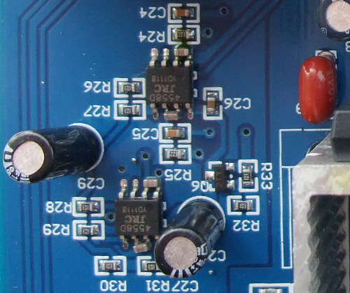

Why do you think they have soldered extra components across the legs of the opamps on mine? I couldn't see these on the photos posted of the earlier version.
I don't know for sure, but they've tweaked the feedback response of the op amp, maybe to improve the low end or "soften" the highs.Why do you think they have soldered extra components across the legs of the opamps on mine?
Or to try and avoid any high freq oscillations with all that RF flying around in close proximity.

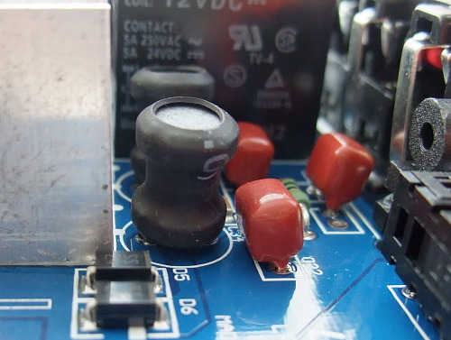

I was thinking of doing the input capacitor mod and maybe the output inductors as those seem to be the most recommended and look relatively easy but I think small surface mounted chips will be beyond me.
I would do the capacitor mod (both the electrolytic power capacitor, and MKP sound input capacitors change), is cheap, easy and provides a huge improvement in sound quality. But the inductor mod is more expensive and difficult to do, and personally I don't think that the difference worth the money.
Anyways, the components quality on Lepai amps, vary from one to another... if you have weak inductors probably you will notice the difference a lot, the same occurs with other components...
