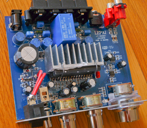

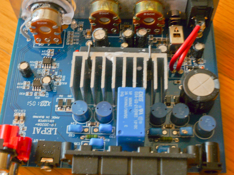

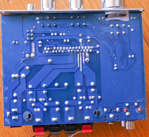

Yes, that's the Lepai version I have. I only replaced the op amps with LM833s and repaired the RCA input ground pin that I accidentally broke when it was out of the case. It got rid of the worst distortion I was hearing so it was a mod well worth the time for me. I've seen stuff like "the output coils aren't big enough" but they're the same as the ps input coil so there must be more to that story. Upgrading caps certainly couldn't hurt. Or increasing the values of the 3! coupling caps. Some of those might even be replaced with jumpers, but I would double check DC measurements and tolerances before attempting that.
I basically working from the assumption that the schematic posted a while back would apply to this version, less the tone switch. I didn't ohm out the switch or much of the board. I chose not to spend too much time and money on a $20 amp.

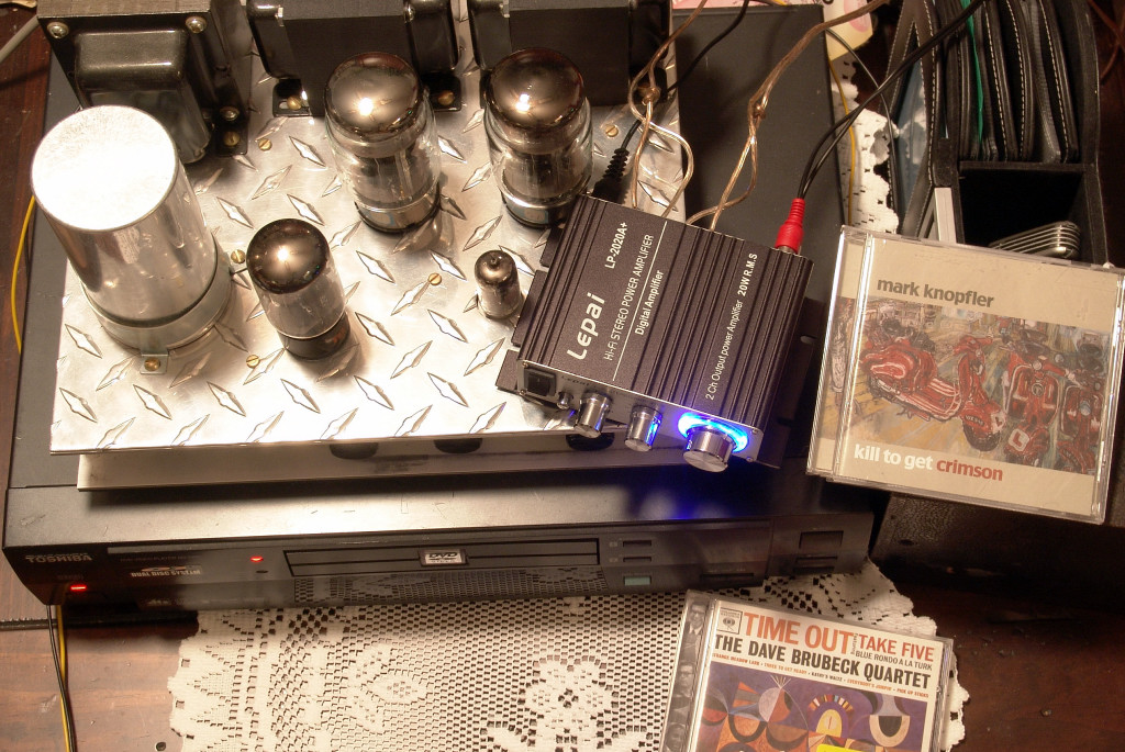

I got one of these little amps from Parts Express.
I needed some Tolex and a few other parts to finish some guitar speaker cabinets that will be seen in the Hundred Buck Amp Challenge thread.
http://www.diyaudio.com/forums/instruments-amps/190738-hundred-buck-amp-challenge.html
Parts Express wanted $13 to ship my order, but If I spent $18 more I would get free shipping. I guess that made the amp cost $7. SO.....
I brought a chip amp to a tube fight. I have been listening to a Tubelab SSE running KT88's in single ended triode mode making about 8 WPC. For really annoying the neighbors I have Pete Milletts red board making 125 WPC. The speakers are Silver Iris 15 inch coaxial drivers mounted in old Zenith console radios. They are 96 db efficient making them loud enough to hear across the street with the 8 WPC SSE. The 125 WPC amp is rock concert in the living room loud.
I hooked up the Lepai and cranked it up. It sounded much better than I expected right up to the point where the sound instantly turns to mud.....Digital Clipping sucks. "20 WPC" of digital amp is not as loud as 8 WPC of tube amp because you can run the tube amp into clipping without putting your fingers in your ears. Unlike some other posters I have plenty of bass with 15 inch woofers. I played with the tone controls trying to match the tube amps sound at a volume level well below clipping. I wound up with the bass knob at 10 o'clock and the treble knob at 2 o'clock.
For $7 it is a keeper, and I would probably buy one for $20. It will wind up as the amp on my PC for those times when I don't feel like pumping 100 watts worth of heat into the room. Here in Florida, that is 90% of the time.
I don't know why, but my unit came with a Vonage power supply that has obviously been used, very used. It seems to work OK and the LED doesn't blink even when the amp is heavilly hammered into clipping. Wonder what will happen if I play my guitar through this thing.

The parts I replaced are U1 and U2, the two 8-pin surface mount ICs just above the volume pot in your first picture. I had LM833s handy so that's what I used. Popular audio op amps like the NE5532 and OPA2134 ought to work also. Here is the 5532 page from Digi-Key, but these parts can be obtained most anywhere finer electronic components are found. I didn't take time to measure but just went on the supplies being the split 12VDC input. There's lots of +/-6V op amps to choose from these days.
I've posted some other tips and caveats from my experience going back in this thread a month or so. Nothing too involved, challenging, or expensive. I think it's established that with a good pair of speakers, this little amp can provide quite satisfying listening. Good luck with yours and keep us updated on your progress, questions, and listening opinions.
