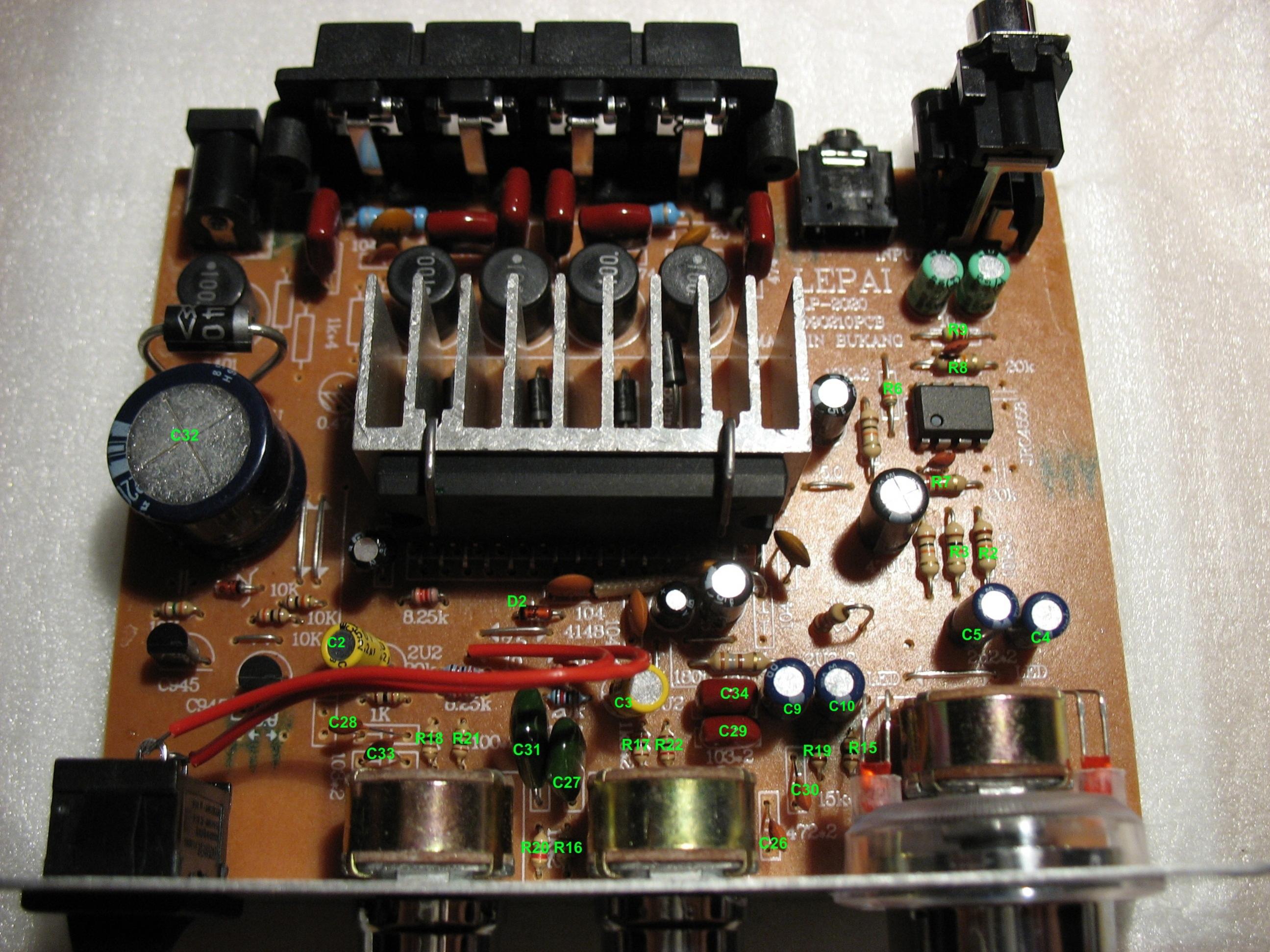

I would like to start modding one of these to make the SQ better. I saw some pics of modified boards, but they're not the same PCBs. Anyone have a parts list what they can replace on these lastest PCBs?

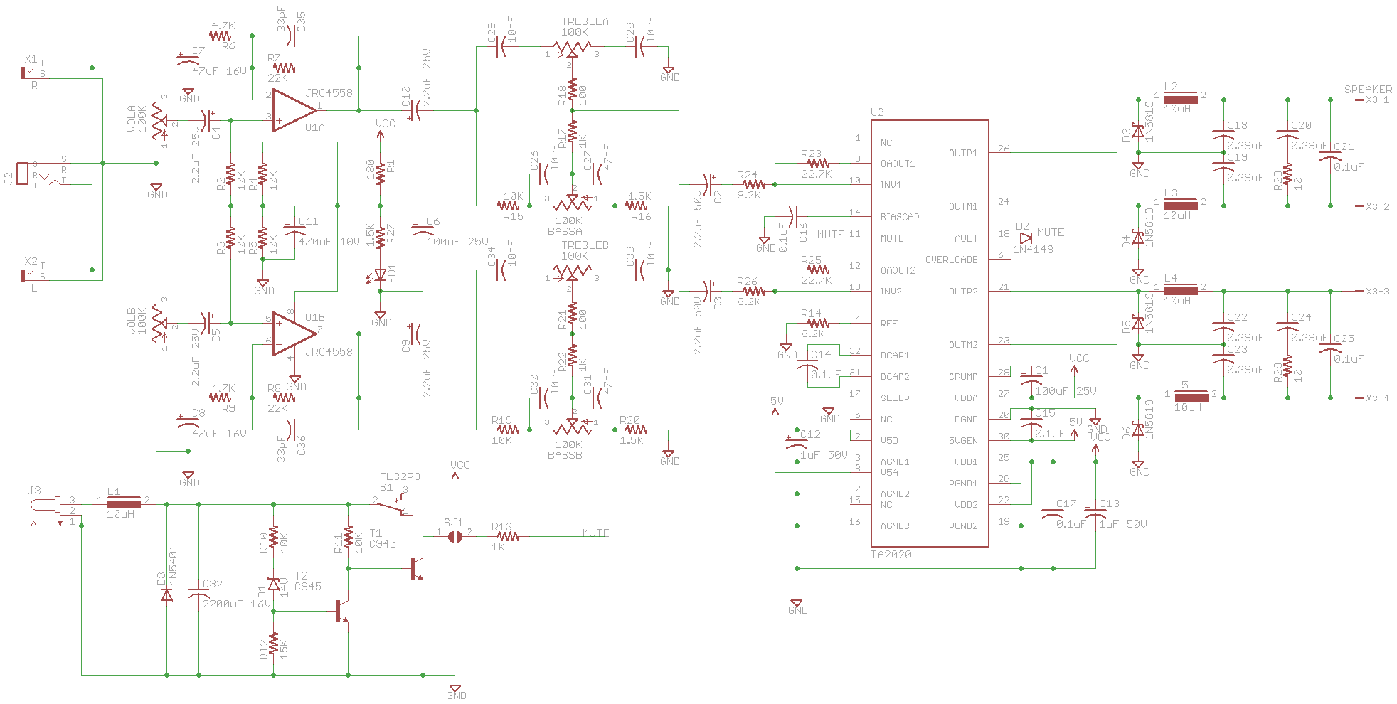

Hi. Last week I bypassed the preamp/tone controls on my Lepai. Replaced it with simple ELNA electrolytic capacitors between the volume pot and R24 + R26. Really simple mod and yes it was a big improvement 🙂 Next up is upgrading the pot
Regards /Bo
PS. Im including a schematic
