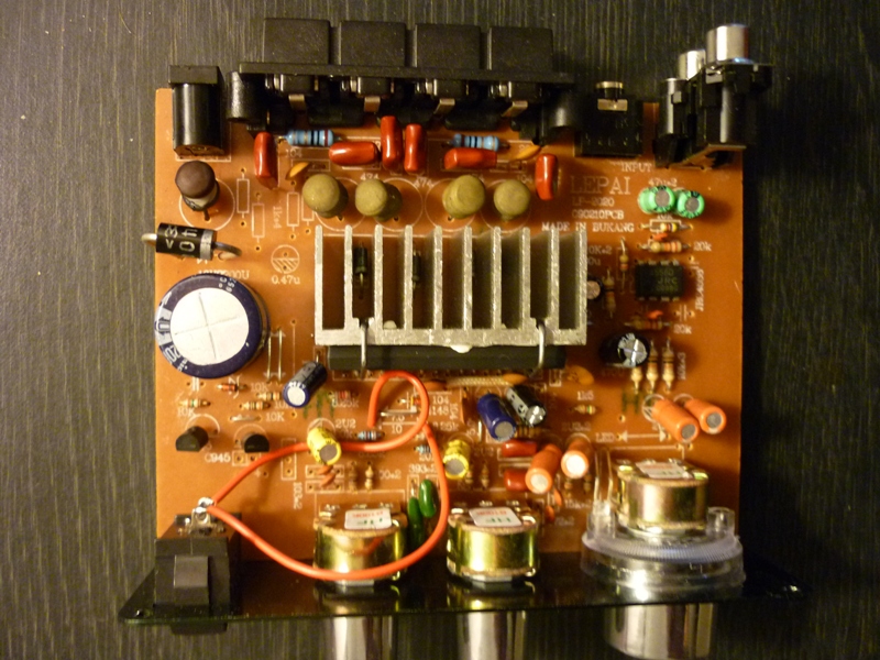

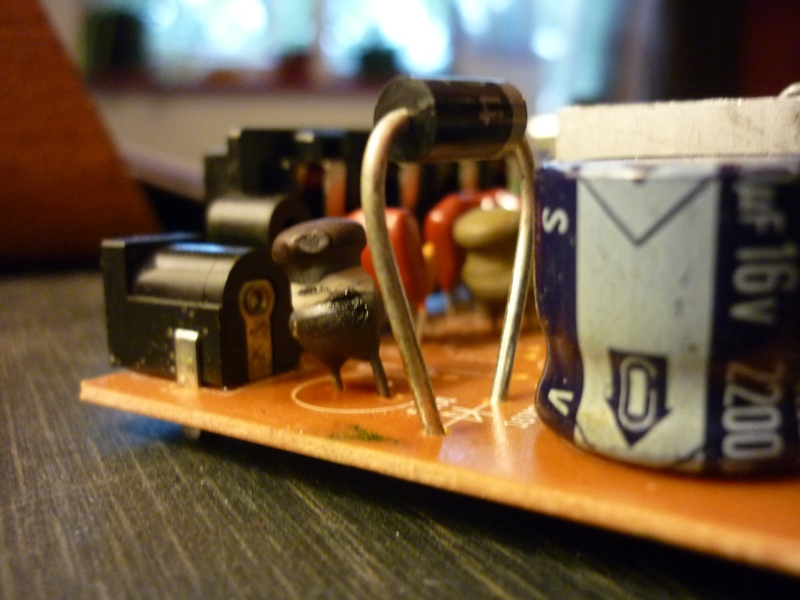

I plugged a 12V "AC adaptor" cable from an old Creative speaker system into a newly delivered Lepai LP-2020. The brick on the cable reads: PRI. : 230V~50Hz 320 mA; SEC. : 12V ~ 4.2A. The unit then started smoking, quite badly, and still stinks, several hours later. I am for now assuming I pumped AC into a DC-requiring input, and fried at least one if not more of the components
I have opened the case up to look for damage. So far the only visible damage I can see is to a small cylindrical (pointing up) brown component (that narrows in the middle, like a tall Oreo) nearest to the power input, standing on two 'legs'. It has no markings but the board has '5401' written near by.
I would really appreciate someone detailing my options here... how do I investigate / fix what's wrong?

Guys, i have received my new amp as i upgrade the resistors it's giving me a dc offset of 95mv for the right channela and 12volts on the right channel!!! what would cause this to happen? bad capacitor? bad resistor? also i have another 1 that humms as soon as i turn on the amp.. amy help will be much appreciated.

Have a look at this schematic
http://www.diyaudio.com/forums/class-d/90500-lepai-t-amp-ta2020-60.html#post2258949
You might want to check all the components shown in the lower left corner, T1 and T2, the zener D1, etc.

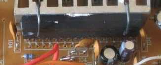

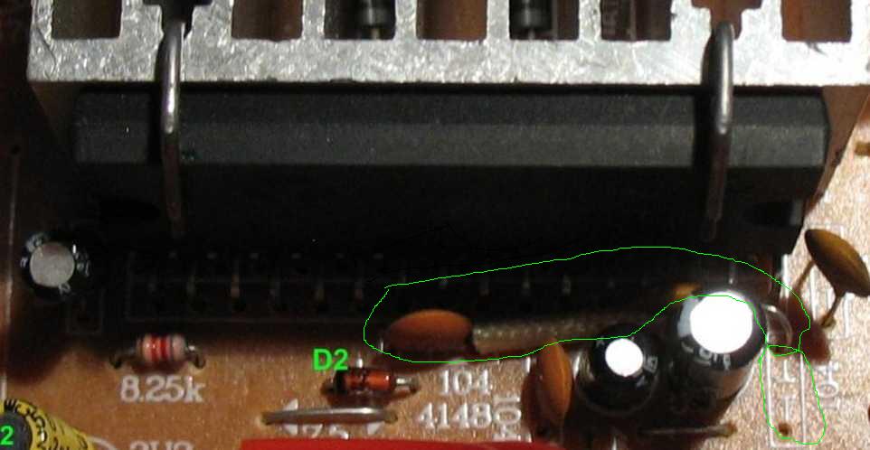

Hello everybody.
Sorry for my poor english !
I'm actually realize a tweak for my lepai.
I sought tips and images and i noticed this : (see pics)
Apparently ,all amp lepai do not have this strap between the two ceramic capacitors .
Someone has an explanation?
