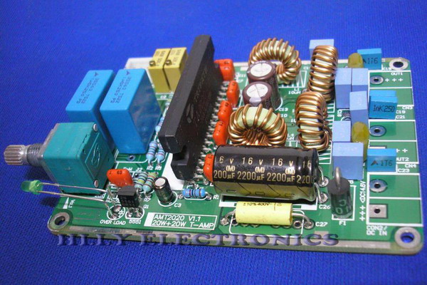

Nice mods Mike. Not sure about the 2p coin though. I think it's illegal to drill holes in coins of the Queens realm :bigeyes:
What did you end up doing with the Inductors? Can't see them from your photos.Can you upload a shot of the rear panel?
I hope I don't get busted for treason! 😱
I'm still using the stock inductors right now, I've put an order in at RS and am waiting for some higher current ones to arrive.

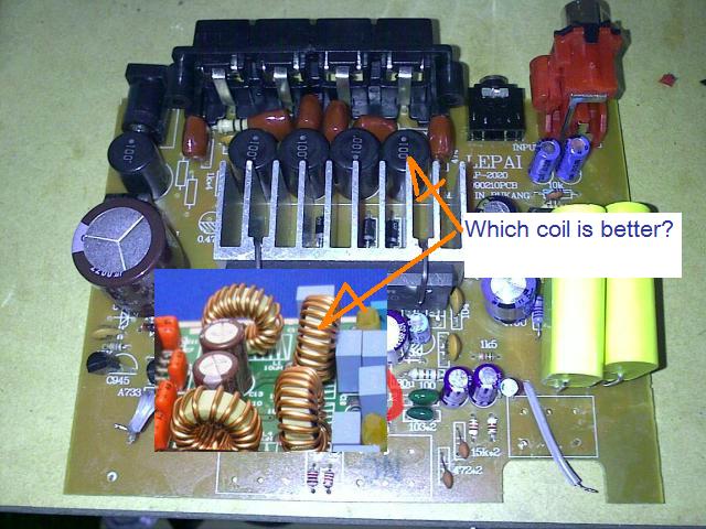

Panda: The toroid inductors are the better ones. 🙂

Panda: those Toroids are green. They are the wrong type, they should be red. There are different types/density of powder cores. If you are looking for a different board to a Lepai you could try the HiFi Audio one. Iv'e recently built an amp using one and they sound great, reasonably priced and very well implemented. Or there is Arjen's stuff which is also supposed to be very good.

Mike, maybe on your new Lepai they have used 2.2uF decoupling caps. All the Lepai's I have had have all had 10uF caps in. You can see the 2.2uF replacements I have put in here:
http://pix.minirig.org.au/main.php?g2_itemId=1069
The white ones with 2u2k written on the top 😉

you need to replace the input caps too. In my photo that is the big yellow ones, although 2.2uF MKTs there will do. They are also 10uF on the standard Lepai.

This thread is for Lepai. I think there is probably other threads dealing with Charlize 😉
That said, I don't like the idea of no input decoupling caps, neither do I like the idea of aircore inductors. I have too much other gear around and the less RFI flying around the better. Especially trying to listen to AM/FM radio.

Col,
I don't want to off topic.
Anyway, thank you for your comment.

They've done something funny so use no input caps however, don't bypass them on the Lepai otherwise you'll get loads of DC offset I imagine.

Mike,
It seems the coil must be changed into toroid to get a better sound.
