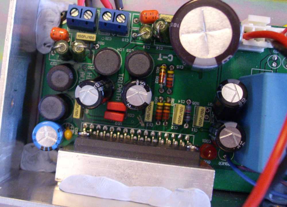

Just bought 41hz toroid kits. Thanks. Did you noticed a real improvement in sound?
Yes, a definite improvement in sound, especially when playing at high volume levels 😉
Be careful with soldering/placement, they MUST NOT touch anything metallic, they arc out. I used TO-220 adhesive sil pads to insulate the bottom from the diodes and also to hold them in place. I might add some heat resistant adhesive later.
col.

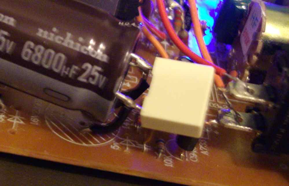

Calamaro said:I've replaced filter capacitor.
Removed diode and replaced inductor with a ferrite bead to gain more room for bigger (and better) Nichicon, bypassed with 100nF film cap.
Calamaro,
I am not sure how to solder 100nF film cap.
Thank you.
Calamaro said:panda, just bypass the electrolitic with the 100nF film cap: solder its legs on electrolitic legs. The film cap (100nF) is non polarized so you don't have to pay attention to + and - legs.
If you prefer you can solder the little film cap under the board
Calamaro,
I understand now. Join in parallel.
Thank you.😀

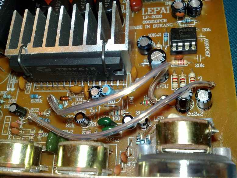

Has anyone else apart from Calamaro tried bypassing the tone controls? What difference does this make, does it sound bassier than when the tone controls are set to 0?
I was wondering, does this disable the volume control also?
Finally, if I was to use a 0.1uF capacitor instead of a 2.2uF cap when bypassing the tone controls, would I then have a HPF of around 100Hz? I'm wanting to try this out in the car, up to the front speakers, and I already have a sub for everything below 100Hz and I was wondering what the easiest thing to do here is.

Mike, just turn the bass down, instant attenuation 😉
If you look at the TA2020 datasheet you will see 2 lots of 4 diodes, one lot is the undershoot and the other is the overshoot. I checked on the Lepai board and the overshoot diodes are not there.
There is a 14v zener after the power supply, so this might protect the chip from overvoltage but I don't think it would sound so good.
The volume control is next up after the RCAs bypassing the tone controls won't affect it (i think).

You're right, bass all the way down = no bass (yet treble all the way down seems to be normal level 😀 )
I've just tried it in the car, works great, even with the engine running no alternator whine, I guess a zener must be cheaper than 4 diodes, I'll have another look at the datasheet when I get time.
I'm not going to bypass the tone controls, as they are acting as my crossover right now, but if I get time I'm tempted to swap out the 4558 op-amp, I've only got a TL072 handy tho, I guess this may improve things a little?

That is a good idea, I don't think it would be that hard to put a switchable tone bypass on this Ta2020 amp tho, if you just used a dual gang switch and put it inline with the bypass cap and resistor, then you should have a switchable tone control bypass shouldn't you?

1. I swapped cap in the PSU to a high quality Jamicon 4700uF 35V. Its physical size is just enough, so I didn't have to remove diode/inductor.
Immediately after the change, bass became fuller, richer, better controlled.
Could you please tell me why you connected 100nF film cap alongside with the big cap? As far as I know this additional cap shouldn't make any difference..
2. I bypassed tone controls according to your suggestion. Wow! What a difference! I can't believe this amp is sounding ever better! Sound is now like a crystal - very clean, almost analytic. However, for me it is lacking bass a little (previously my bass knob was set at 2 o'clock).. but there is no problem if you use eq 😉
I couldn't find such a big (2.2uF) film caps in my area, so I got 2.2uF 100V Jamicon electrolytic caps. Also, used audiophile-grade OFC wire for routing the signal.
3. Has anyone tried replacing bulk capacitors? Is is worth?
