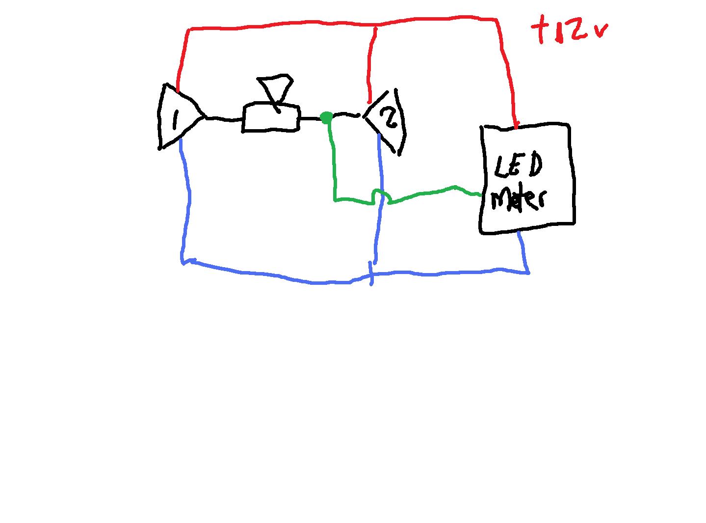

I've been working on adding a pair of 11 LED VU meters to my DIY Boombox. I built up the kits and tested them on an old National Boombox external speaker outputs and both kits work fine. I powered the led kits by the DIY box SLA battery.
The problem I have is that soon as I connect the kits to the Lepai speaker output terminals, the Lepai cuts out like it's sensing a short.

Quick guess.
The amp uses a bridged output stage and you are attempting to connect the meter 'across' the speaker which then shorts the one side of the amp out via the common ground connections.
You need to connect the meter input to one side of the speaker only... either side it doesn't matter. Do not connect any other wire/s to the speaker.

I think you will find that the power supply negative (or ground as you might call it) for the LED meter and the negative or ground meter input are one and the same point.
So when you wire it all up you are placing a dead short on one of the amplifier outputs.
What you need to do is wire the LED meter power supply as normal and then connect just the positive meter input connection to either speaker terminal. Doesn't matter which.
That will prevent the short circuit. Assuming the meter input is AC coupled (with a capacitor) it should all work. If it doesn't then we need to see the circuit details. You might have to add a cap to block the DC voltage that is on each speaker terminal.

Your amp has two power amps per channel. That is 1 and 2 here (the speaker IS NOT ground referenced). When you connect your meters input ground to the speaker that is why it shorts it out. So leave the input ground floating.
It all runs off the 'red' supply (I assume), that is to say amp and meter share the same supply.
Blue is ground. Your meter connects via one wire, the green.
If it doesn't work as it should then we would need to see diagrams for it. It should work.
If the input sensitivity to he meter is wrong (all or not enough LED's lighting) then you would have to look at altering the gain of the meter circuit.

That looks a pretty basic circuit and not really suited to what you want. The diode D1 is a simple rectifier. That means the circuit needs at least 0.4 volts to overcome the volt drop of the diode and so light the first LED. Both speaker terminals will have around 7 volts DC on them. That will cause the LED's to light.
You need to AC couple the input with a series capacitor. Try a 47uf 25 volt cap with the positive end to the speaker.
So its wired like this.
1/ The 12 volt supply connected to the two points marked -12 and +12.
2/ A single wire from the input at D1 wired to the negative end of a 47uf cap. The positive end of the cap goes to the speaker terminal.
So just three wires in all. How well it might work is open to question. Its not ideal as an audio power meter.

Ok, just tested with the cap as instructed and it's now working! The only issue is that with the trimmer pot at max, the LEDs don't dance until the volume is above 11 o'clock. If you turn it up to the 2 o'clock position, I can get all LEDs to light with a bass hit.
Is there a way to increase the sensitivity slightly?

The only way to make it more sensitive would be to add a gain stage to the front end of the meter. You would also need to know some idea of the meters basic sensitivity to get an idea of what was needed. You could do that by trying this.
1/ Starting with the trimmer on its least sensitive position.
2/ Connect the meter input to the 12 volt supply.
3/ Turn the trimmer up and the LED's should all light in sequence.
4/ When the top LED just lights, measure the DC voltage on the trimmer wiper (middle leg).
That will tell you how much voltage you need to light them all. Knowing that will tell you if its achievable to get them all to light with this amp.
The circuit really needs a proper front end and precision rectifier. Look at post #62 here which is a similar kind of issue.
