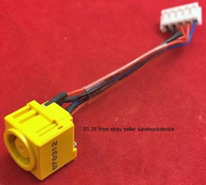

Hi I'm trying to adapt a Lenovo IBM Thinkpad 20v 90w power brick to run a TPA 3116 Amp. To my knowledge the Lenovo has a round tip 7.9 x 5.5 mm jack. The amp power in is 5.5 x 2.1 mm. I've spent hours looking for a suitable adapter. Has anybody tried this on a Lenova? Can anybody help me out here please?
Get a pair of matching male female plug/sockets, which can't be reversed, and use those..
Cut off the brick plug about 2 inches away, so that can be reused if needed.
And put a big diode on the amp positive input as a protection against reverse polarity. Or a bridge rectifier, then it will better protection.
This use of a laptop brick seems to have been done earlier, a good thing, instead of scrapping a good supply.
Do check it is working properly before use.
You can probably buy a replacement Lenovo jack off Ebay but would need a PCB to mount it to.
Easier to buy a plug to match your amp and cut the Lenovo cable as previous posters have stated.
Heatshrink over the plug body & cable makes a really secure boot to prevent cable pull out or kinking.

Search ebay for thinkpad t60 power jack. The power cable assembly has the jack you need. Just cut off the white connector and install the plug you need for the amp. Red wires are +20V, black is ground, and blue is not connected for your purpose.
