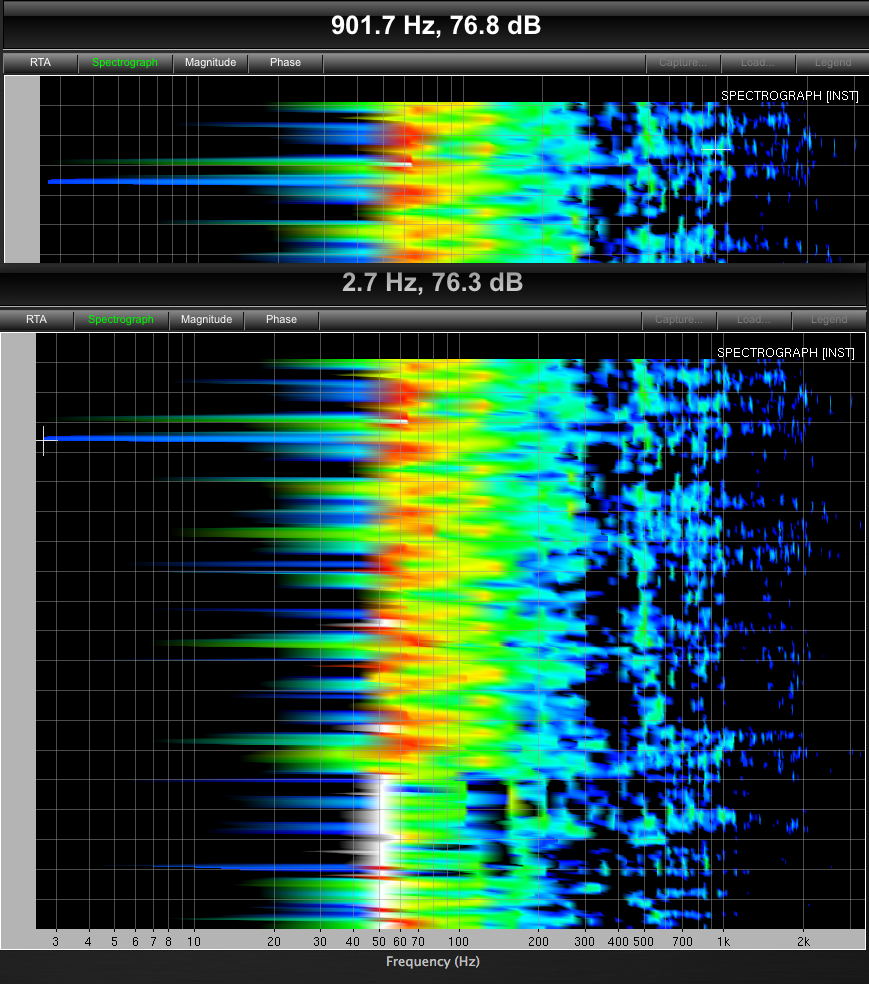

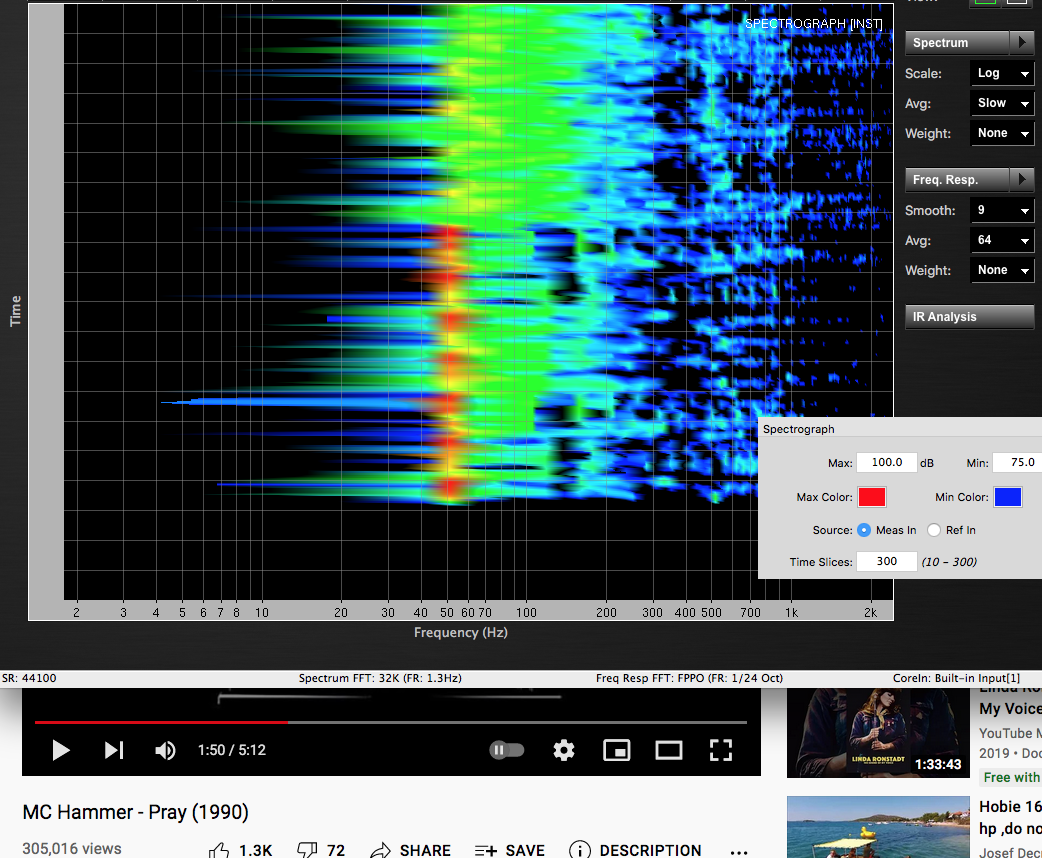

I’ve posted screen prints of spectrographs (and an RTA with a 3-second "peak hold") of some portions of the song below. The music progresses vertically, most recent being at the bottom of the graph, amplitude displayed in color red being loudest, fading to yellow, green, then blue 25dB below the red level. When the music is stopped, the spectrograph goes black, indicating what is on screen is “music”, not noise.
Whatever you want to call them, the loudest sustained notes in “Pray” are in the octave from 35-70 Hz. Though the average level generally drops off steeply below 35 Hz, there are some glissandos tones with content even below 2Hz, an example below shows one of those with level at 2.7Hz equal in amplitude to the spectrum at 900Hz.
Whether your system can reproduce those frequencies adequately to hear or feel them, they are there in the recording. Boost the lower range with EQ enough and drive your speakers with enough level to exceed Xmax, and you’ll hear the harmonics of them ;^).

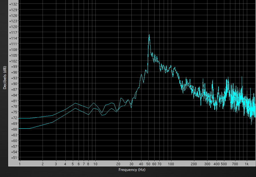

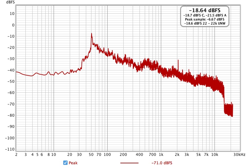

The dull repeated note is pure 51 Hz and there's not much below, as Art posted previously. This kind of booom-booom shown in the RTA below (all the peaks in the entire Pray clip) is typical of pop music and is routinely mistaken for low bass. Actually, the folks playing loud music in cars might be getting their bass thrills from 80 Hz, not 51.
Self-aggrandizing Golden Ears may not have a clue how lousy (almost) all of us are trying to be analytic about sound, mistaking treble boost for bass cut and vice versa. And you can see how few DIYaudio members were willing to stick their necks out with a guess (prolly smart on their part).

....Though the average level generally drops off steeply below 35 Hz, there are some glissandos tones with content even below 2Hz, an example below shows one of those with level at 2.7Hz equal in amplitude to the spectrum at 900Hz.

Nah, nothing brave about it.
I'm just smart enough to have bothered to check what I thought I was hearing with an analyser before posting...
