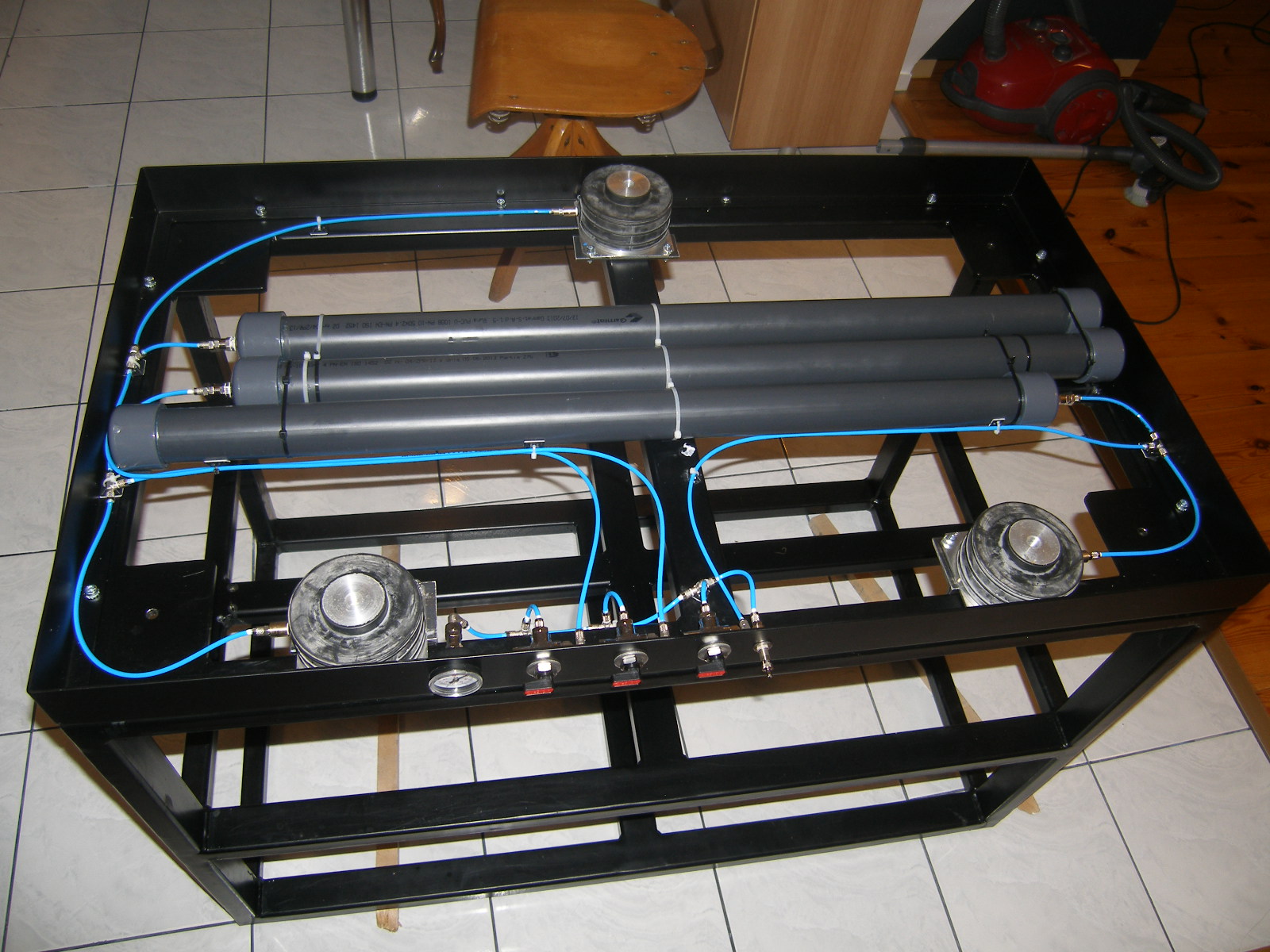

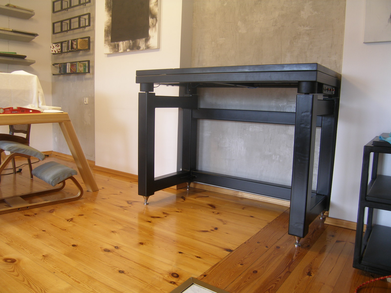

This is always the problem when using industrial pneumatic components for isolation. A very high performance equipment rack using similar isolation has a monstrous slate shelf on top in order to lower the isolation frequency within a useful range.

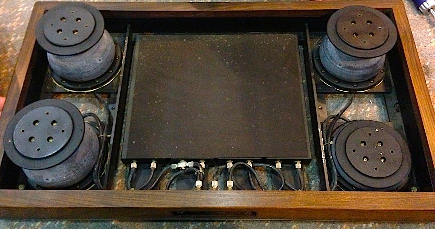

The only sensible option is to create your own pneumatics, similarly to what Micro did for turntable plinth isolation in the 80s.

May I ask you why they shouldn't work ?
Without a sufficient load those are too stiff to offer any degree of isolation. You can just as well use some solid blocks.
You should start experimenting with very lightly filled golf cart inner tyres and see how well you like the effect and how loading changes the resonant frequency, isolation and perceived bass.
