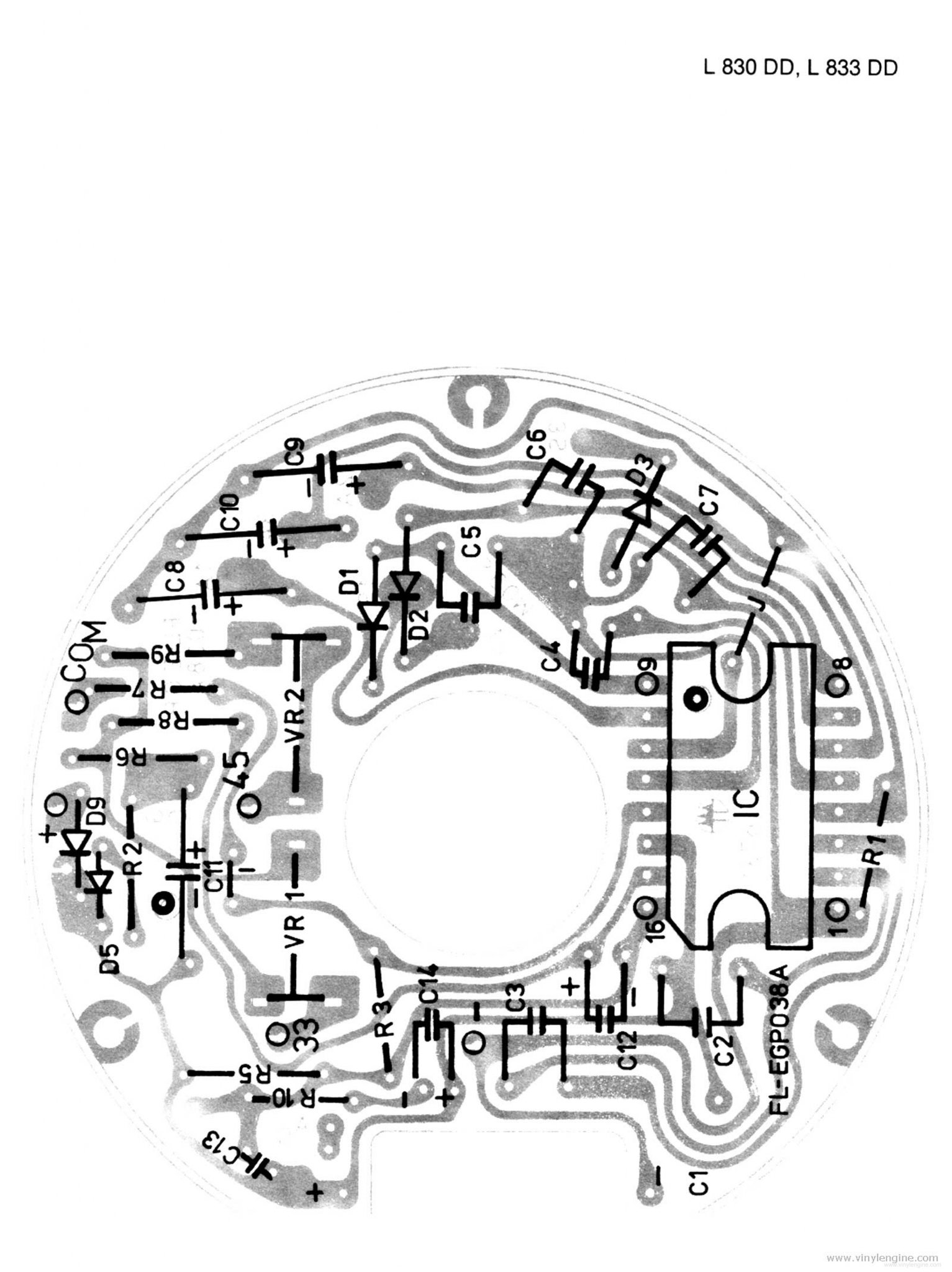

The motor control drive circuit isn't that big but it has the AN620 Matsushita chip on it.
It tried to clean the trim pot, but that did not solve it.
I swapped it out for a new one but that did not do the trick either.
With noting that I have a basic understanding of elec. I want to ask for help with this.
Could it be a faulty AN620 or maybe a resistor gone bad?

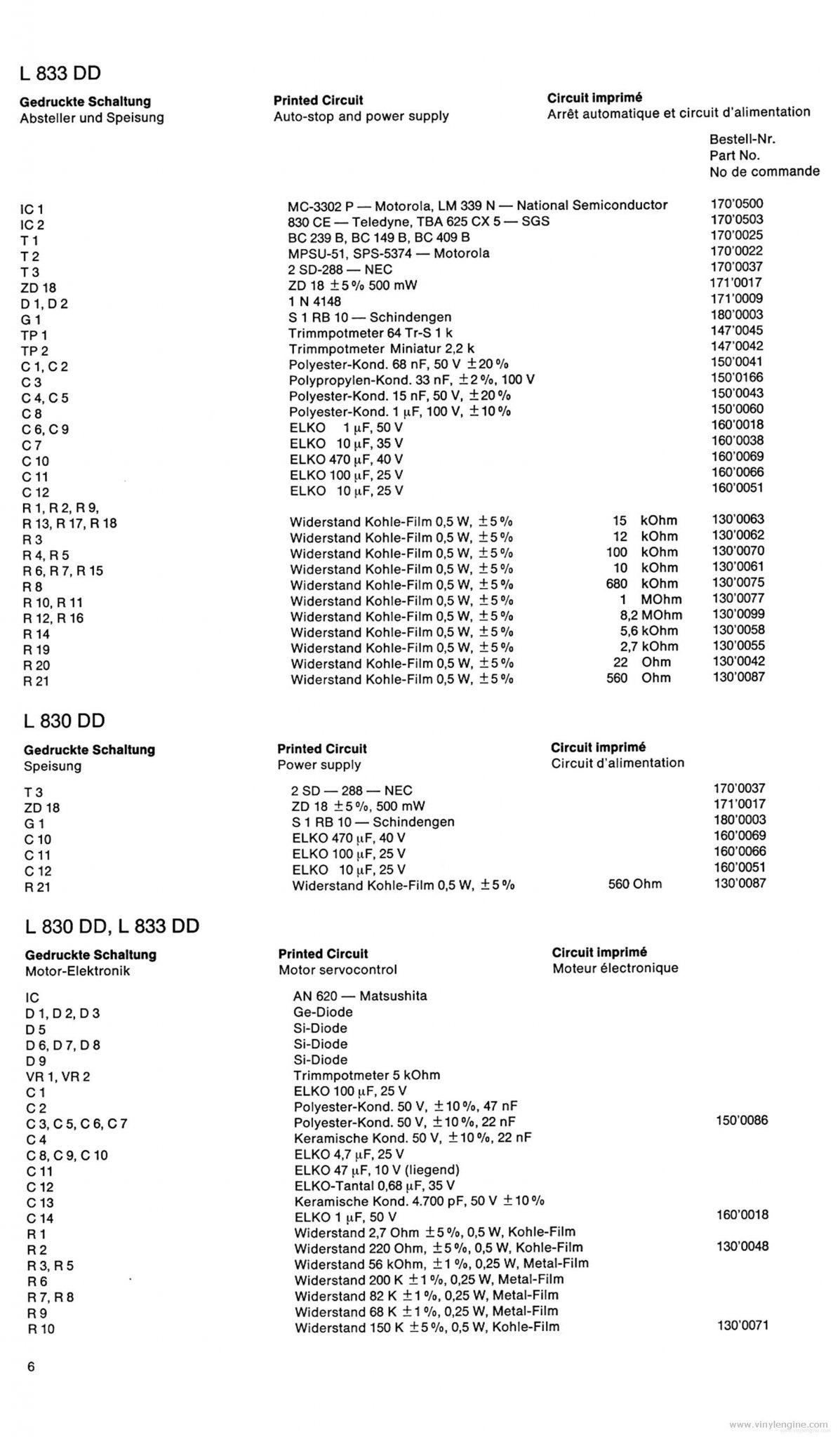

The servicemanual I managed to find on the net has a fault in it also, in the parts section it shows that the VR 1 an 2 are both 5K Ohm pots.
The diagram shows 20KOhm, but what's in there are 30K if I am correct. (303 code on both of them)

I already had the SM as I described, that's where I saw the fault in the values of the trim pots, and it´s uploaded here.
There is a controller with the AN620 IC
And the caps are just being replaced but made no difference.
I also swapped the resistor that connects to the 33 RPM trim pot, resistor R8, 82 KOhm and replaced that with another, but that resulted in spinning at high speed on only the 33 rpm mode.
45 runs normal
Swapped the new back for the old and the speed is normal again but with the problem.
The SM says it is a metal film resistor I could only find a carbon lying around at the moment, maybe that is why it spun at high speed, adjusting the trim pot
had no effect on this.
Update, both the trim pots were replaced as one fell apart (age?) They were replaced by 2 15K Ohm.
The R7 and R8 should be both a 82K Ohm resistor according to the SM but the actual ones that were in there was the R8 being a 75K Ohm, and the the R7 a 82K Ohm. I replaced both ones for 100K Ohm. The set up seems to be stable now without fluctuating speed after switching off power of swicthing between 33 and 45 RPM.
The only thing that could be better is that the 33 RPM is difficult to get to speed. The timing is very precise, it really is precision adjustment, a tad too far and the speed is either too fast or too slow. Don't know if that is the reason that there was a lower value resistor on R8 in the first place.
Maybe the C12, tantal capacitor was an option to check / replace too, did not notice that it is in the path of the VR's to the IC AN620.

That's good news but try the original resistors value for R7 and R8 to see if the speed adjust improves.
Tantal capacitor don't age very well replace with good quality electrolytic capacitor if you can't find any 0.68uf use 1uf they have +/-20% tolerance on a good day (tantal)
