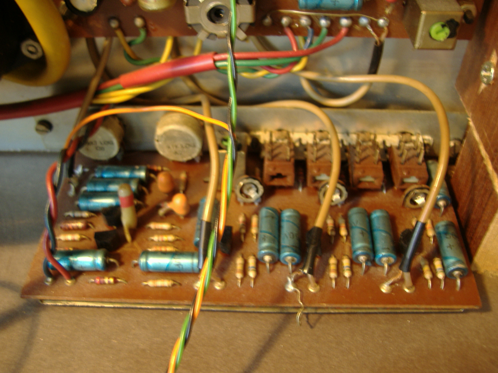

On the two pcb's attached to the tape unit there is a bridge rectifier + smoothing caps and at the moment im feeding it 12V AC. I replaced the old tape in the cassete with fresh new tape, cleaned and demagnetized the heads and the unit is recording en playing nicely untill the tape completes its cycle..the old recording is still there in full effect...
so no erase...hmmm
Bias is present everywhere on the heads and i get about 1 ohm on the erase head..continuity test on erase head is also okay..
So what i would like to know is what kind of AC is the tape unit expecting? And im guessing that with the correct voltage the bias would work within its specs...

From memory I think you could expect to see around 20 to 50 volts AC at a frequency of anywhere from 60kHz to perhaps 100kHz. Cheap ferric tapes get away with a lower voltage, chrome and metal need much higher erase fields and consequently higher voltage.

you are absolutly right..i just switched the transformer to one whom gives about 30V AC and yes its erasing now...actually it seems to work flawlessly..
Ive hooked it up as an aux on my Sony MX-P21 which has volume controls on the in and out of the aux...
The only thing i cant get my head around is why the echo isn't repeating...no matter how much i turn the repeat knob there is no repeat effect.
I will check the potentiometer first since the volume pot is crackling to...old machine and corrossion....

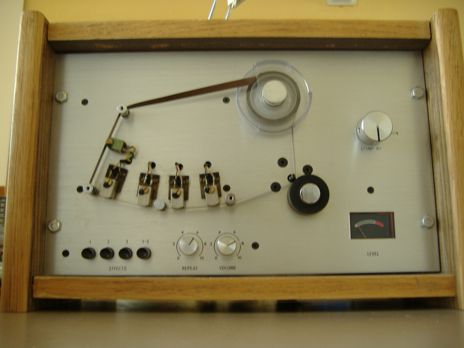

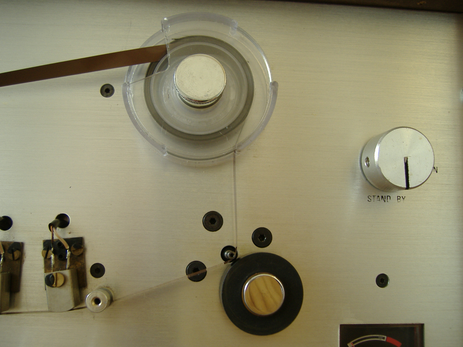

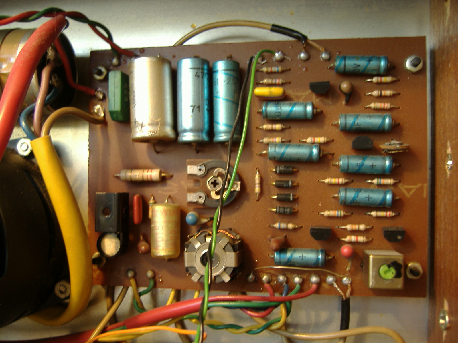

As promised some pics from the LEM tape echo..work in progress, still need to make a back plate etc..the case is made from oakwood :)
Actually its similar to the LEM EC10.

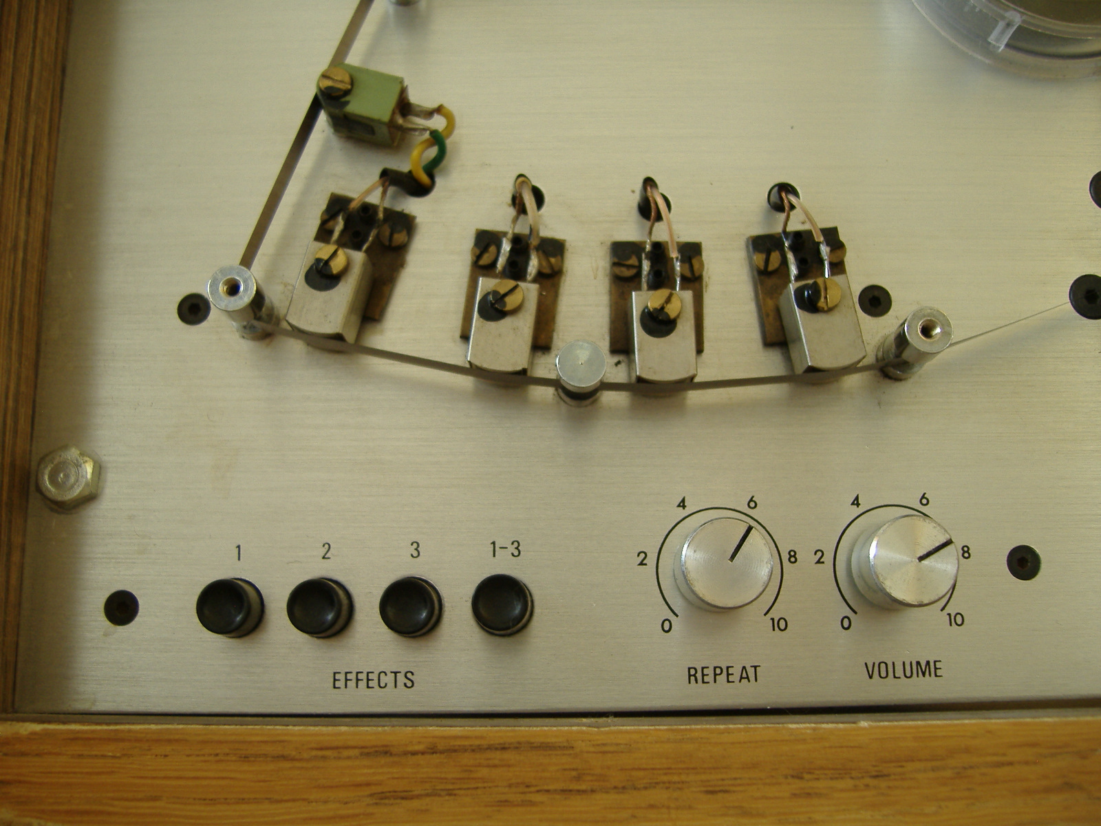

As you can see there are three recording heads, one playback head and ofcourse the erase head.

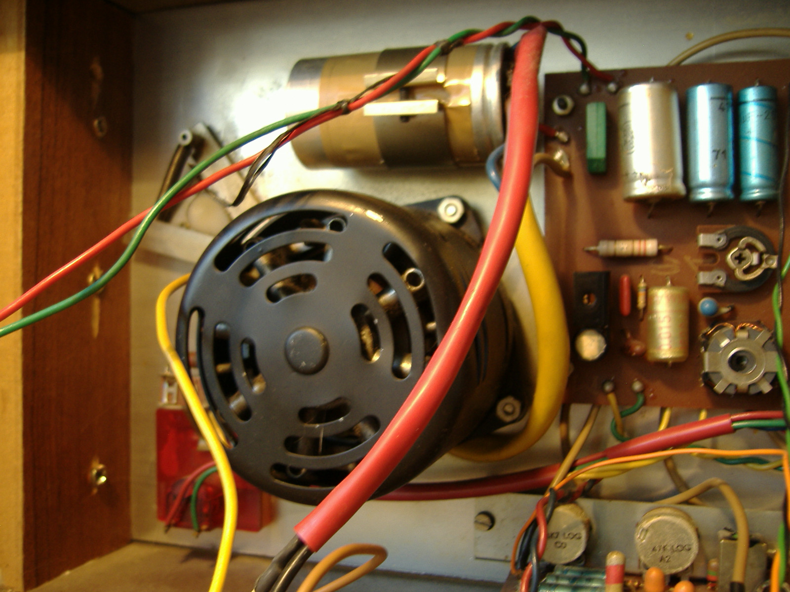

Motor is from Pabst and runs on the AC mains at 220V.
On the front you can engage every rec head separatly or in one go all three...

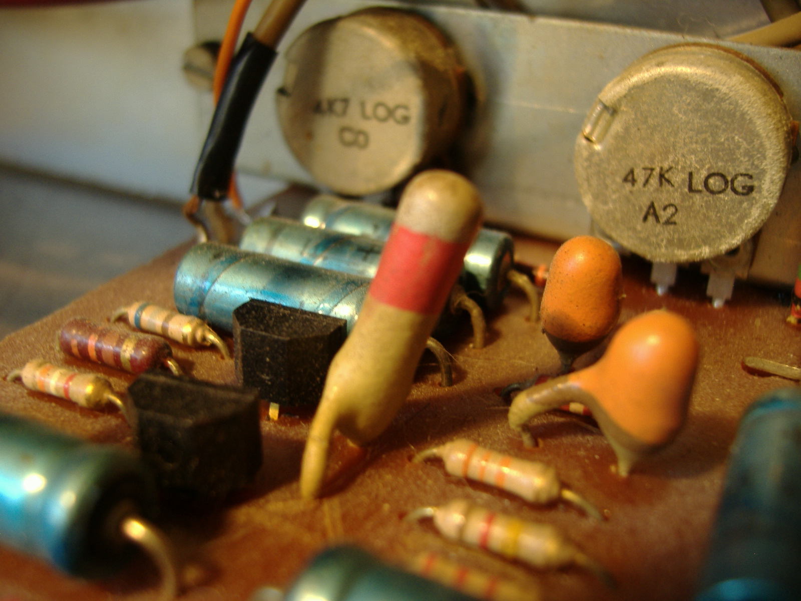

And about the repeat....im thinking about trying 36V AC maybe the caps arent being charged enough to make the transistor work in the repeat circuit....any thoughts?

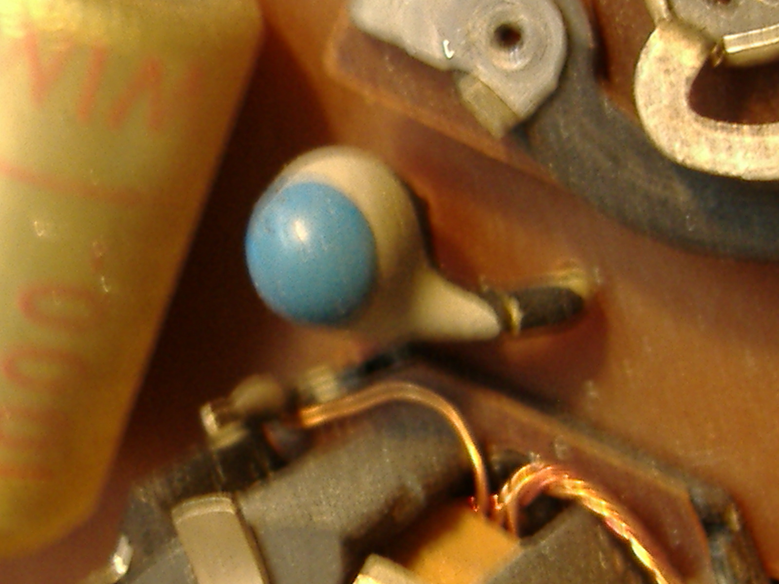

Or maybe those tropical fish caps arent charging at all...can some identify the cap on the last pic? ive never seen one like that....

This might help with the caps. I'm out of my comfort zone on those older markings and would have to look up how they are derived. We had a similar discussion here part way through the thread though,
http://www.diyaudio.com/forums/solid-state/258614-can-anyone-id-transistor-me.html
Your project looks great, and it all looks clean and in good condition. I'm not sure what to suggest over the repeat issue. Its very much a case of needing to be sat in front of one to get a feel for what is going on. Some of those axial caps could be way past there best by now... might be worth looking into.

Incidentally, the blue axial capacitors are probably Philips ones?, and as such have been EXTREMELY reliable - but I see a number of tantalum capacitors, and historically they tended to be VERY unreliable (usually going short or leaky).
those are not tantalums but strangly formed tropical fish caps, but i think one of the Philips caps is bad...even by touch a hum is audible...will change that one..
But ive changed the AC input from 30V to 36V and im getting faintly hearable repeats...but its more like a decaying sound.
When engaging rec head three (farmost of the playback head) with repeat down the echo is immediatly cut off, with repeat full open i can hear a faint repeat....so closed and open are sounding different which is good.
My hunch is that maybe one of the transistors is dead which should amplify the repeat signal....this will need further investigation....but im almost there :)
Now to identify the tranny...there are no markings on them as far as i can see....but first let take some measurements....
Regarding the motor...
Unfortunatly this is an AC motor and not a DC one...i own a Klemt Echolette S NG51 which indeed has two speeds but those motors have different windings to control the speed of the motor by adding or extracting a winding...so it wont be possible to add speed control in the way of the Klemt.

According to this link http://frank.pocnet.net/other/Philips/ColourCodeRC1966.pdf
the ones looking like tantalums are actrually "pin up caps" sexy!
