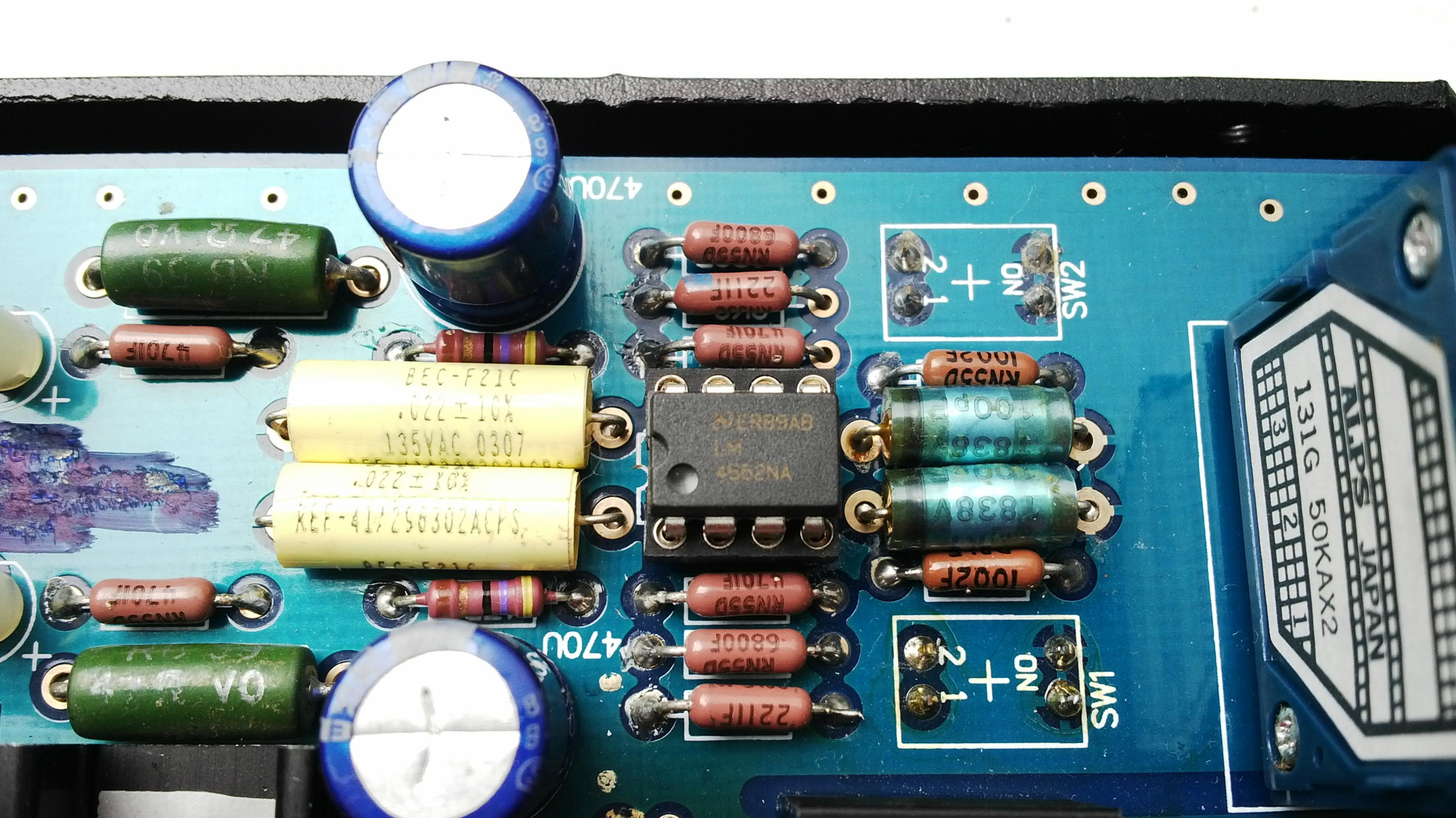

I got a built clone that was purchased from AliceMagicBox called the Lovely Cube Premium. I've replaced the opamp with a Burson V5 and it made a noticeable difference, much like changing tubes in a preamp.
My unit is dead silent with HD525 (150 ohm), and some other full sized headphones I've tried. Sound is very nice, to my ears it is natural sounding and the mids is very sweet. Tested out with an AK240 with HD650 in a meet about a year plus ago and the sound was quite remarkable. Definitely scales up well with better sources.
If your builds has buzzes, hums, or other problems then its probably PEBCAK.

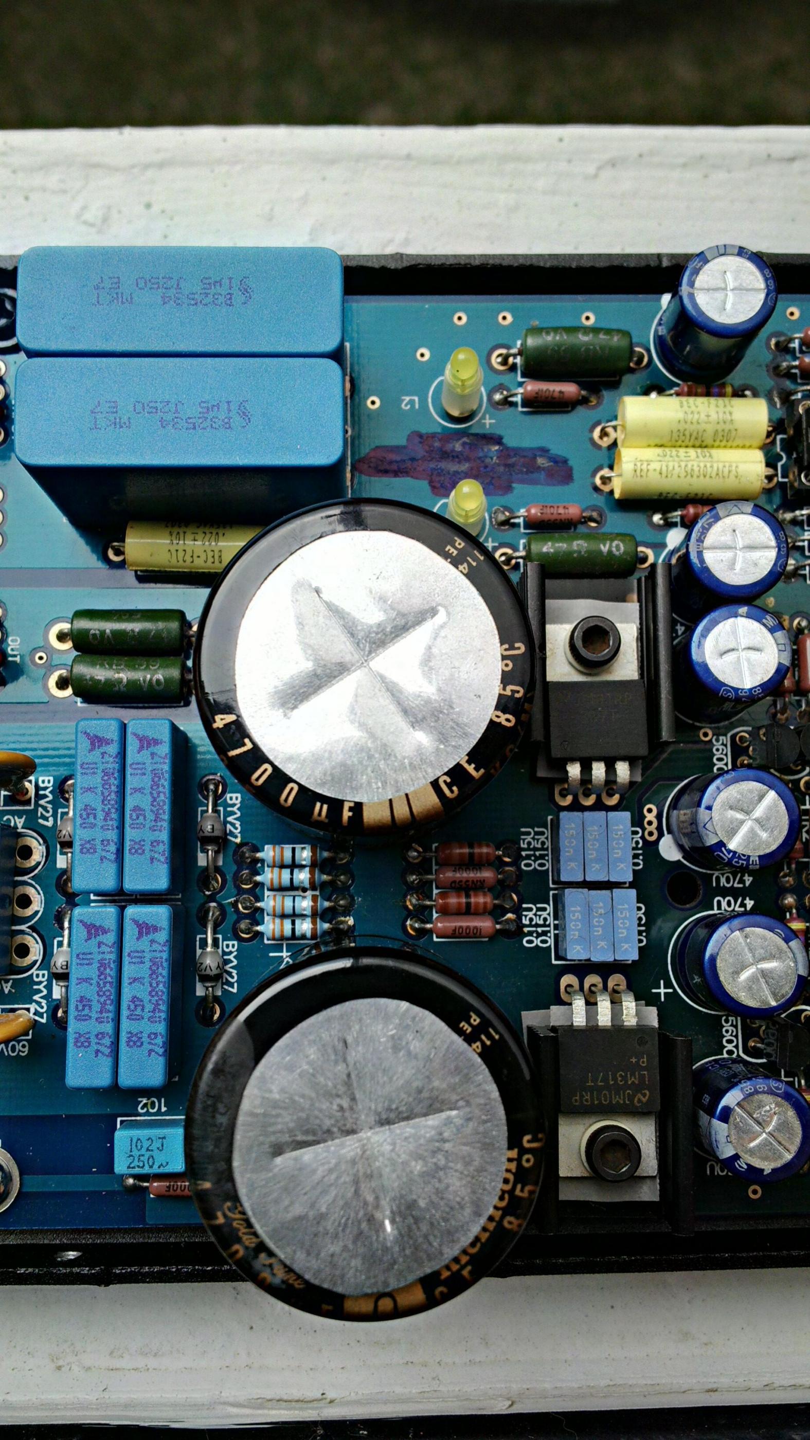

Matrix M-Stage amps had originally used the Lehmann topology as well but as they've progressed they've made improvements to it. Newer models now come with several options such as balanced input+outputs, selectable sources, and built in DACs. However the basic topology still remains.
One thing I noticed different between the Matrix unit and the Lehmann clone is the PSU section has 2 trimpots instead of the usual 1. I assume this is because the Matrix allows their builders to use less matched parts so they can adjust both +ve and -ve rails independently, while the Lehmann clone only has 1 so parts selection/matching is more stringent as you can only adjust one rail to match the other fixed output rail. Mine however has no trimpot, which I assume the designer of the clone had sourced matched parts for the power section.

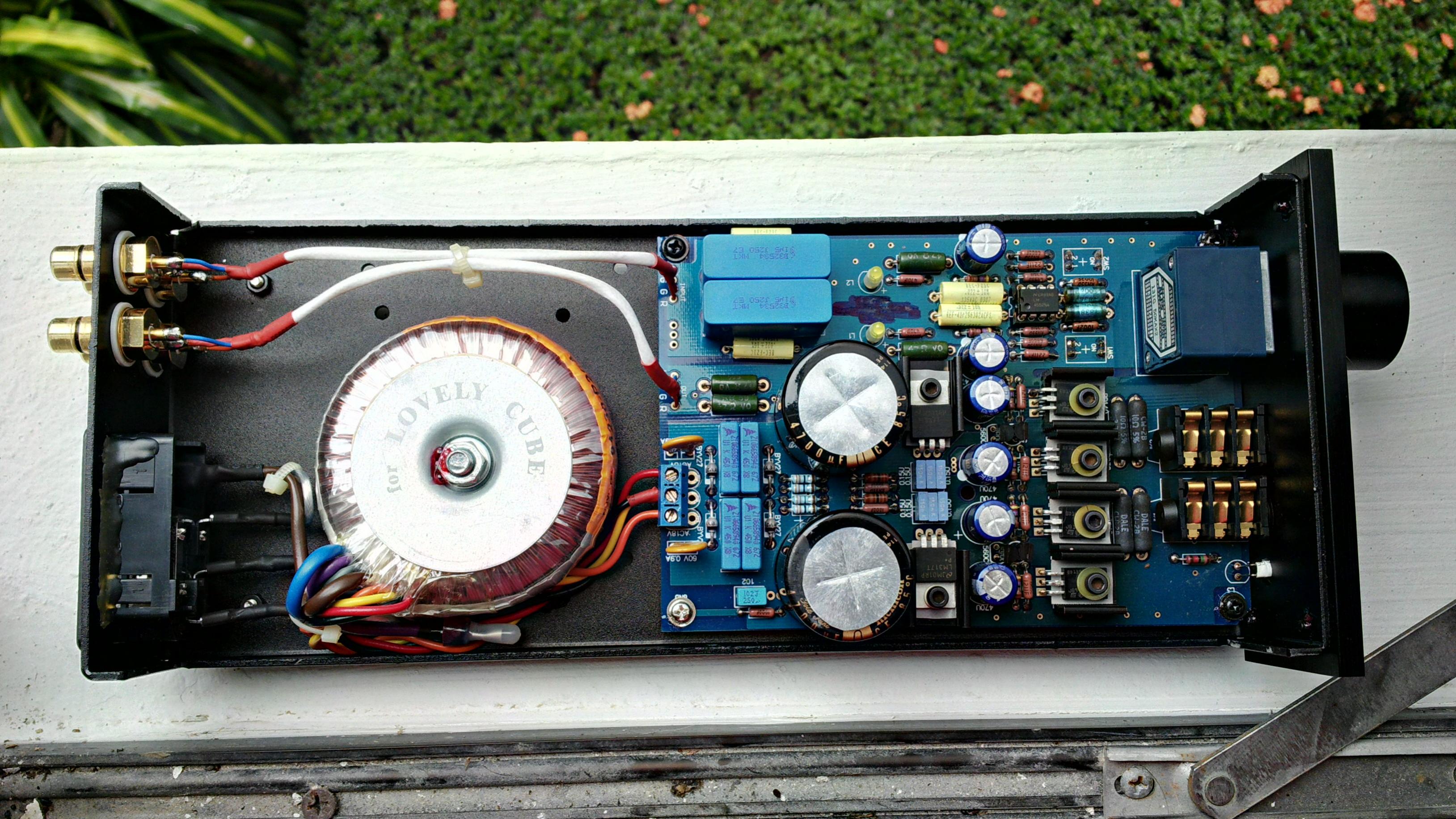

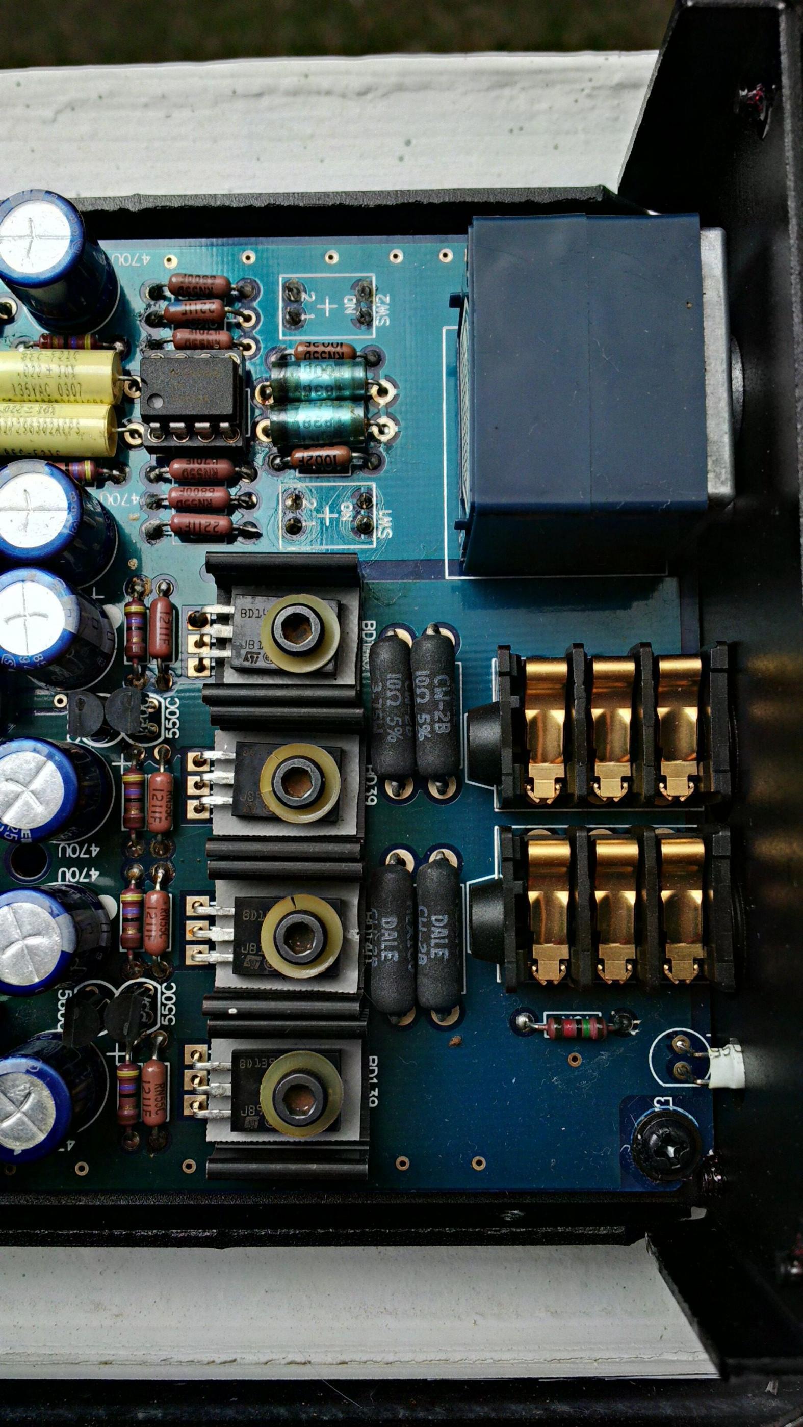

These are the internal pictures of my amp. As far as I'm aware of it is accurate to the Lehmann Black Cube. Also note that it doesn't have the Burson V5 opamp, this is an old photo set.
One thing for sure is I do agree this is a relatively simple amp to build and beginners could try building one as a starter amp. Either this or the clone Beyerdynamic A20.
My unit now has more of a preamp duty as compared to headphone duty, it is paired with my Naim NAP200 power amp clone. The sound is ok, still neutral and sweet, but compared to a NAC52 clone my friend brought over the NAC sounds a lot better with better dynamics and wonderful tone. Just all around better to listen to.

Congratulations on your dead silent clone build.😱
Even though it's blue in color, that's still a different(more recent or updated)board than I used for my build.
The original Lehmann used Wima caps, not the blue Arcotronics and Siemens caps I see in your example.
I'm also surprised that you didn't opt for 1% 10 ohm emitter resistors instead of 5%.
Still a very nice build.
