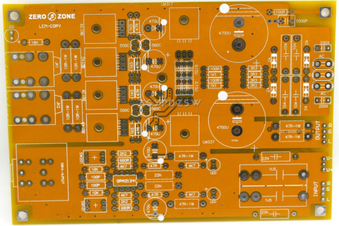

Lehmann headphone amp clone on aliexpress
what do you think ?
attachment.php
component placement looks like the original
aliexpress link
what do you think ?
These "Lehmann" clone boards have been discussed many times here before.
Having personally built a couple of these "Lehmann clones" in the past, I would forgot about this sh_tty sounding design and move on to something else!
Utilizing a dual op-amp(OPA2134 or whatever dual JFET op-amp you prefer) for the VGS is one of the limiting factors here vs. using a single op-amp for each channel.
Look for a JLH headphone amp PCB if you're determined to try one of these Chinese clone headphone amps.
The all discreet JLH desing sounds MUCHO better IMHO, but will require a DC servo to keep the offset from possibly "frying" your headphones.

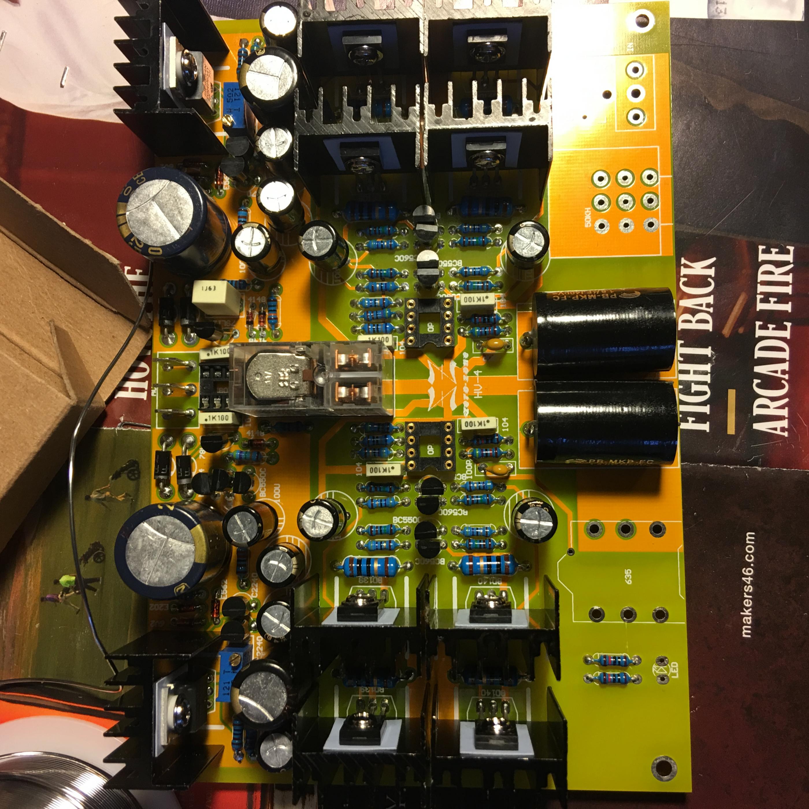

i got another board from the same company i believe and the seller claimed that this circuit is also based on lehmann :
GZLOZONE Lehmann HV-4 Headphone Amplifier Kit With ALPS 27 Type Potentiometer
i put it together with its all crappy components, the only thing i changed was the coupling caps which i replaced with solen ones and man it surprised me, it sounds fantastic, no noise no hum , dead quite and looks like a good design overall, so i got lucky you think ?
From my limited experience of browsing (but not buying) amps Zerozone is one of the better guys. The full kit is only about $5 more than the bare PCB, a real bargain. To protect your precious cans I'd AC couple the output rather than rely on trimming the DC offset though.
i got 250ohm, so about 300uf ?
few more questions :
- does the cap have any effect on the sound, i read it effects bass., is the brand effect the sound character , like solen, m-caps ... ?
-is there any more general solution ? like if i want to switch between different impedance cans without worrying about cap value ?
Yeah, 250ohm would suit 330uF (nearest standard value).
There are plenty of guys who hear differences between caps, I'm not one of them (yet). So I use a bog-standard electrolytic. Preferably not a low ESR one unless that's all you have as lower ESR normally means higher leakage.
You can size your cap according to the lowest impedance 'phones you're going to use. The only downside is a bigger (longer) switch-on 'thump' with the higher-Z kinds. This can be minimized though by fitting resistors (say 1k ohm) across your jack outputs to provide the ability to charge the cap with nothing plugged in. Then only plug in your cans a few seconds after powering up.

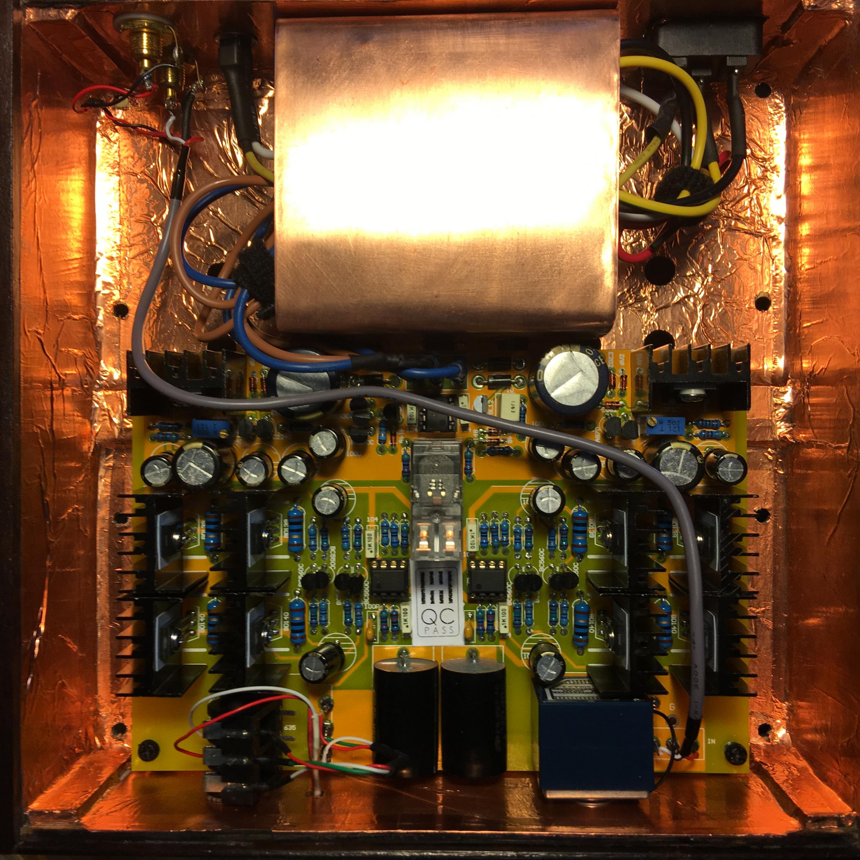

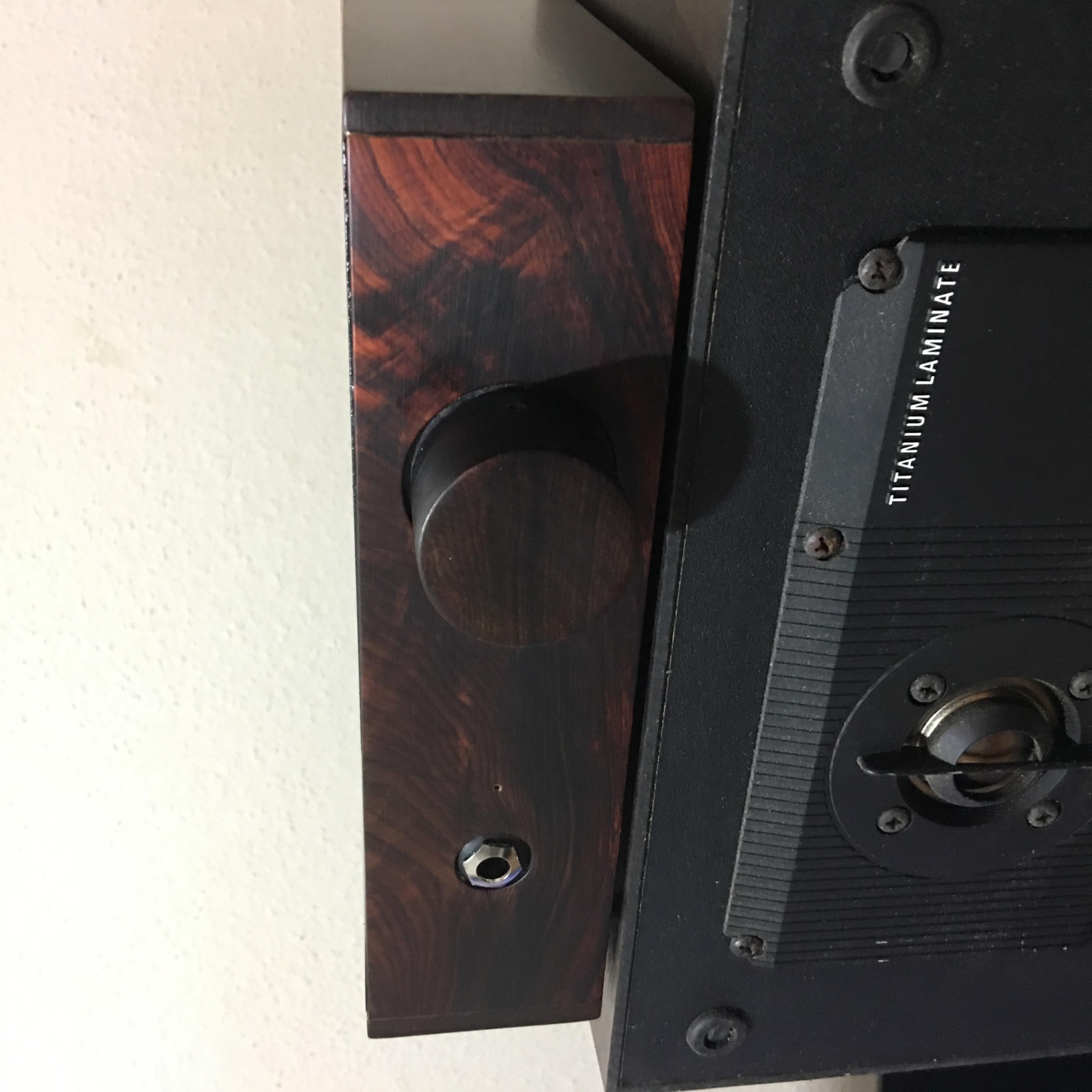

pic from finished GZLOZONE Lehmann HV-4 amp :
I believe Sennheiser chose the Lehmann BCL amp to power their HD800 headphones at the launch. You might think they know a thing or two about headphones and amps, so surely the BCL can't be that bad??
Like most kit they can be tweaked to some extent for better sound, primarily the power supply.
Curious - why would Sennheiser 'know a thing or two' about amps? I used to work for a fairly well-known speaker manufacturer, we didn't know too much about amps. The choice of amps for demos was more often than not made based on commercial considerations, not SQ ones.
it does not mean if they manufacture speakers/headphones they know everything about the amps or the other way around, if you are a painter it does not mean you know how paint was made or how to make it ! but as a experienced painter you know what paint to choose.
Lehmann has a good reputation and i m sure guys at Sennheiser tried different amps before they choose one , or it's like a contract or something.
