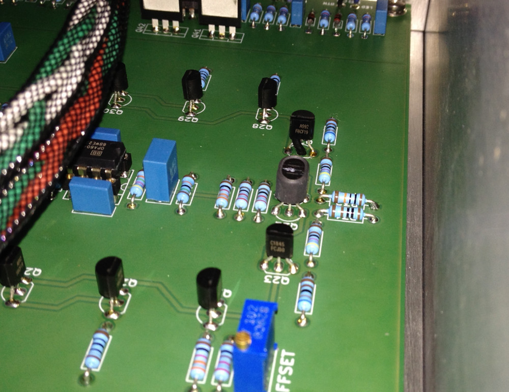

She wants to build a phono pre amp.
This is a rare case of building, not designing.
Here's the amp I'm building. It's the QSXM2, by Per-Anders Sjostrom.

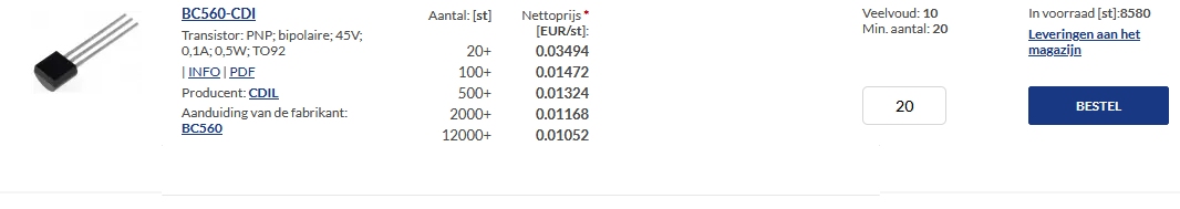

Today I ordered 1000 x BC550C at RS and 1000 x BC560C at Distrelec. In total less than 50 euro, to arrive in some days. Are you interested suzyj?
Did you seen the <<no brand>> notification at Distrelec?Today I ordered 1000 x BC550C at RS and 1000 x BC560C at Distrelec. In total less than 50 euro, to arrive in some days. Are you interested suzyj?

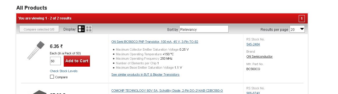

RS appear to have BC560 on back order. Maybe they have an order placed with ON Semi for the last purchases as they are obsoleting them. As Ian mentioned TO-92 are going. Seems industrially only SMD's are going to be used in future. Pity, because many of us started out with thru-hole devices as they (still are) were easy to build with. SMD's not so much fun. but you can make much smaller circuits with them (if you are prepared to use tweezers and fine solder tips).
Origin PRC, I'll ask them tomorrow to name the manf as round is the oem name used by Distr. If no good I send them back.Did you seen the <<no brand>> notification at Distrelec?

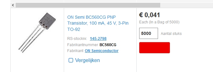

If you can get by with the "C" variant on tape reels, Mouser has 2,000 BC550s in stock and 40,000 on order for February delivery.
560s? That's a different story altogether. DigiKey will source them for you but there are only 39,000 available.

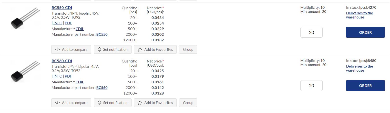

- Legit sources of BC550/BC560? Aliexpress? Ebay? TME/CDIL?
