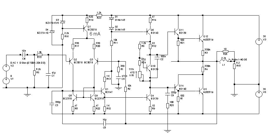

legend master amplifier by boraomega
I don't see anything special in these circuits. They look like standard class A-B mosfet designs to me. Is the lack of current sources to bias the differential pair and VAS in the first circuit a deliberate design choice or just cost cutting?
Sekhar this is what Bora has mailed me

to meanman1964,
i desperately need to make an amp as u suggested Stagemaster for its simplicity...........I do agree to u........... did u make the stagemaster .............i am uploading a schematic is it stagemaster if so will assembling it exactly according to the schematic will make it work without any problem ........ plz help

is it safe to connect 4ohms speaker??
Virtually any class AB amplifier output stage with just 1 pair of >110W output transistors will be considered "safe" with 35V rails and 4R loads.
Amplifiers only become "unsafe" when builders use higher rail voltages, less quantity or lower rated output transistors than specified or inadequate cooling. i.e. no clue what they are doing.
You need safety circuits such as limiters, compressors etc. where amplifiers have no other means of preventing accidental overdrive, causing the amplifier to operate unsafely. That is a condition applying to any amplifier with any realistic load and is one of the few practical means of ensuring safe operation.
Safe power ratings are a relative term and most DIY amps would never be called truly safe.
