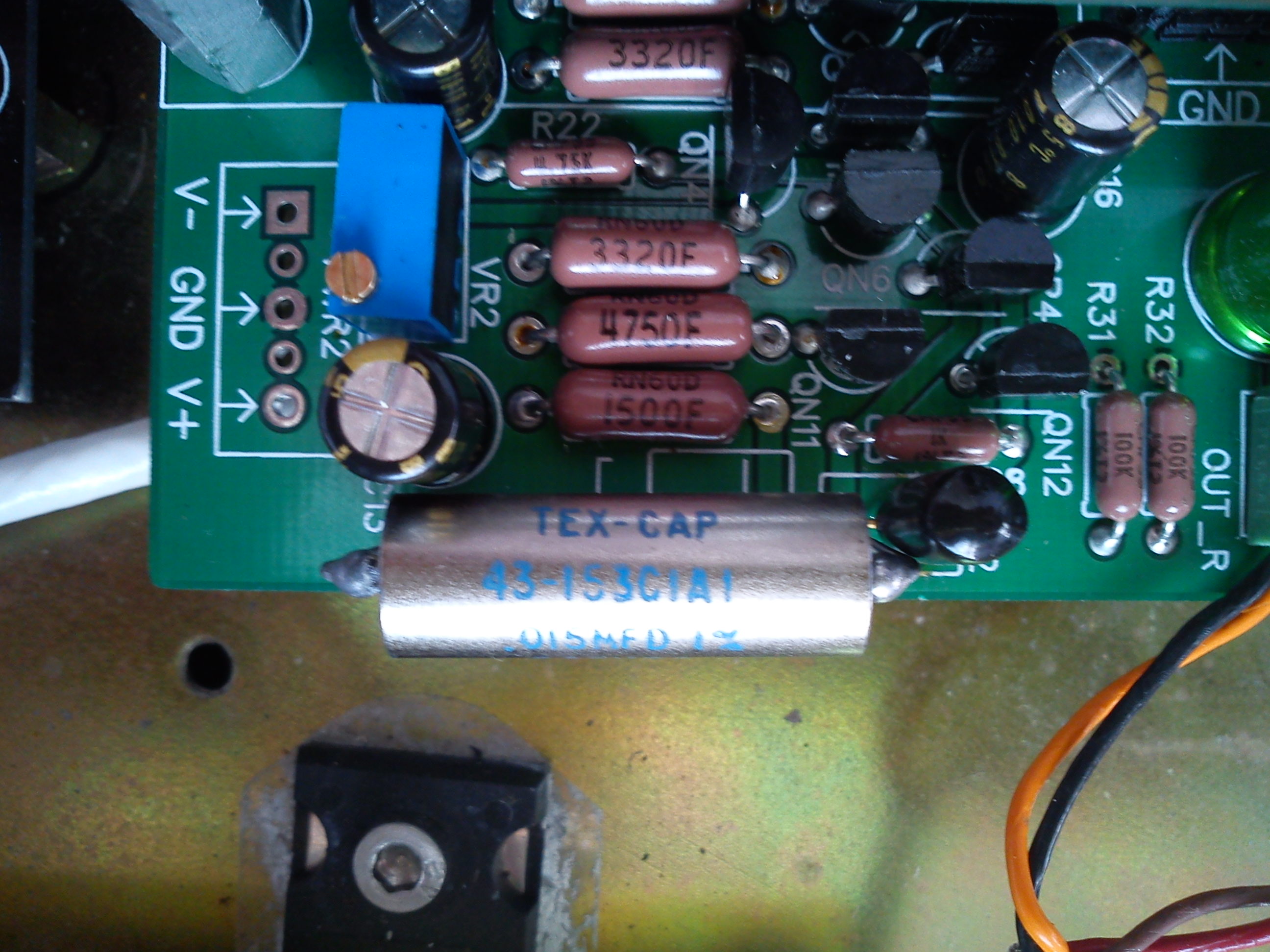

Russ I was greatly impressed how sounds the Legato with the standard parts. Possible the 15nF teflon film & aluminium foil 1% caps are a big upgrade so I start to look for other possible critical parts like are the resistors, which are the others resistors not rated 1W more criticals? or do you have another idea to upgrade the Legato?

i think my legato have wima and panasonic z caps.
Teflons are USA NOS
Yes your Legato have Wima & Panasonic
