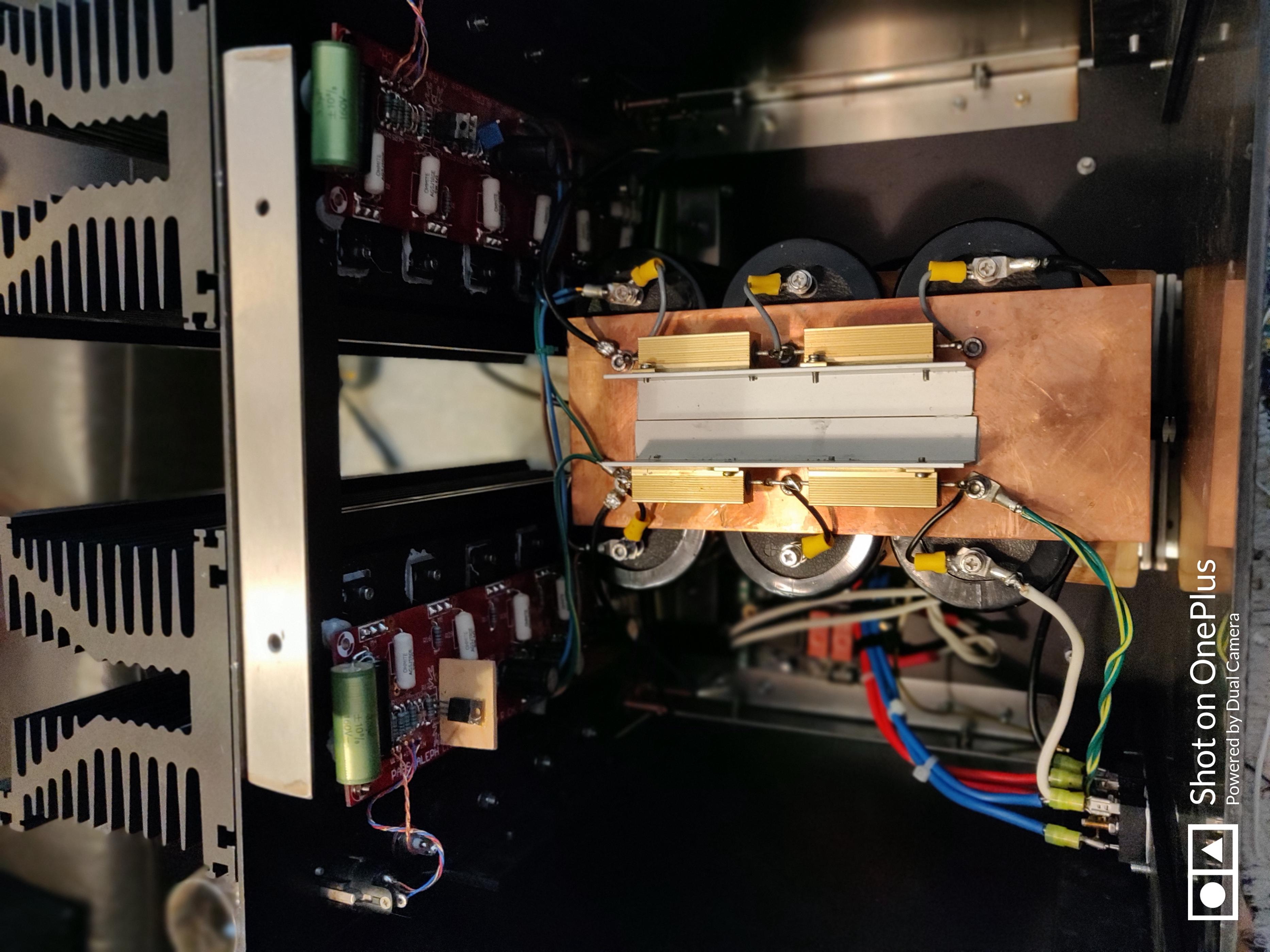

The build I'm planning would feed into a fully discrete, 2-board AMB β22 amp. There's a great appeal to me (call it dogma) to having the entire analog chain in discrete class A. No op-amp rolling necessary. So when earlier Brian responded to me by e-mail saying the Legato's should be back in stock in a few days, a Legato build is what I'm considering.
When I say no opamps, that means going balanced out into an unbalanced amp. Also with DC offset into a DC-coupled amp. So as interstage I'm thinking of doing a 10K:10K input transformer. Matched to a 10K volume pot. The transformer having the benefit of negating the DC offset on the amp's end, and accepting both balanced and unbalanced inputs.

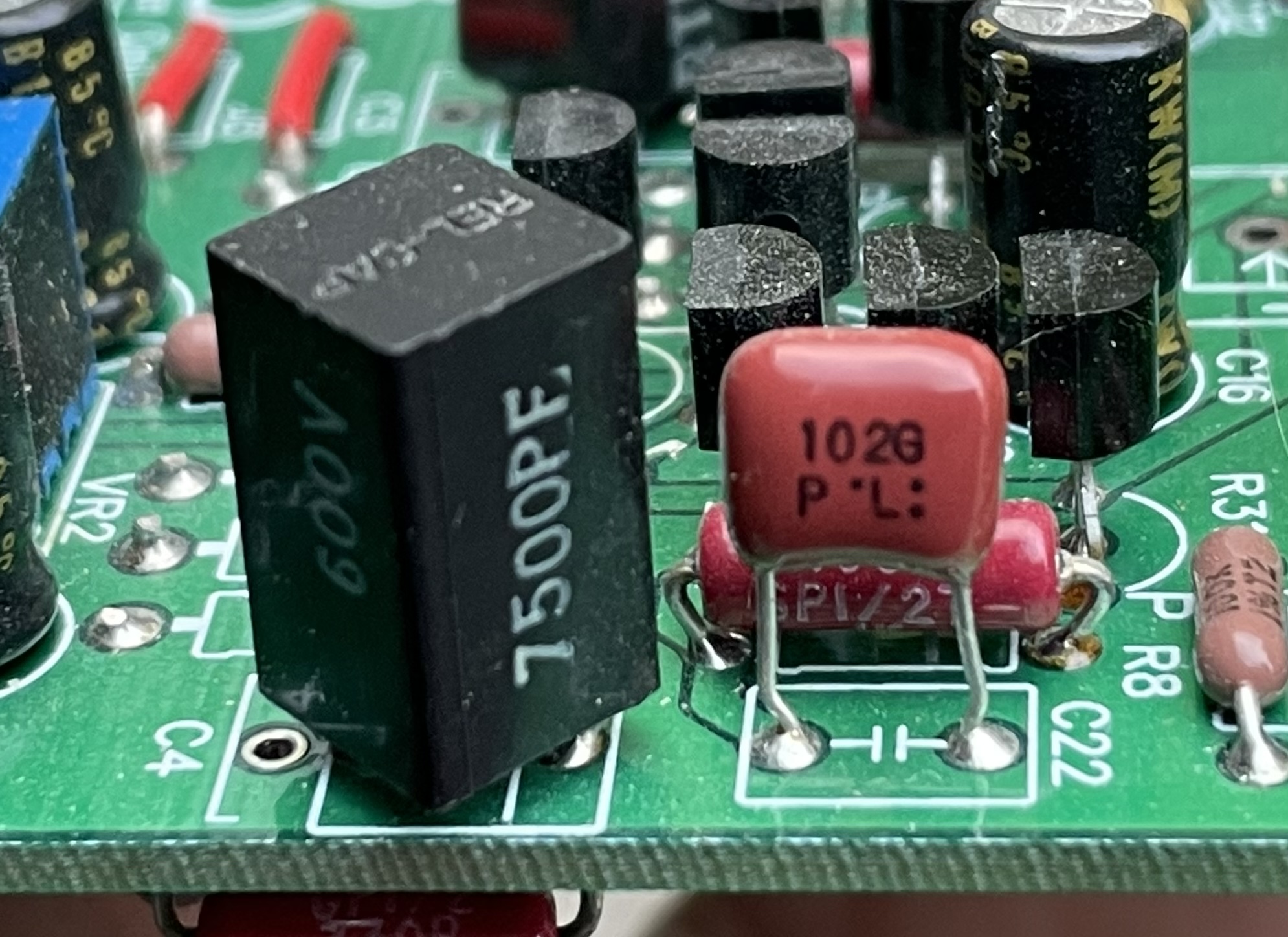

Which caps have you rolled and with what?
Joined 2007
A generation earlier - board version 2 - I had nice ceramics in C19-22 and it was very pleasing. But for the version 3 boards I couldn’t find that particular cap so went with what I described. I have generally used non-kit “fancy” resistors for 1-4 and 9-16 but I don’t think they are lower noise than the Vishay that Brian sends. That’s more about “audiophile angst”, and part of the fun of DIY. :)

It just occurred to me - the Sparkos discrete opamp that I put in (for headphone use only in my case) is set up for class A output, and will supposedly drive up to ~3.5v before gain is decreased. So it might compete favorably with a transformer solution and remain within your preferred dogma. ;) Analog volume? I still love the Twisted Pear relay-driven stepped attenuator. It sounds great and is lovably funky.
That's a great suggestion! I'll give it some serious thought. You got me on my class A vibe for this build :) Upsides: cheaper than two transformers, none of the transformer issues with ringing, slew rate, and the like.
Downside: paraphrasing Bruno Putzeys, "never waste a good balanced input". Having an input transformer provides much higher CMRR and so dynamic range. Though that too, is something of a numbers game with a short, quality interconnect.

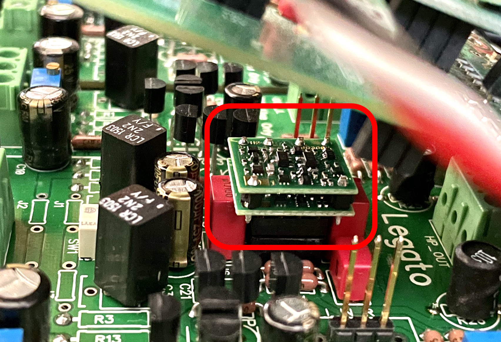

When placing the Sparkos -- was there enough height clearance to still stack the Buffalo on the Legato? Or did you have to place them side-to-side and connect them with e.g. a ribbon cable?
Joined 2007
If you look at the attachment in post #665, you will notice the tall black rectangular polystyrene caps toward the left side. To fit them I used 16mm standoffs between boards plus longer header pins (visible in front). There was clearance for the opamp at 16mm, but just for a bit more safety I added a ~1mm nylon washer to the standoffs. If you are working with a Legato already having shorter pins, its easy to heat the short end of each pin and pull the long end out through the black plastic strip. If you're starting with a new board, Brian can add the longer header, maybe taller standoffs too. I certainly would not add a significant lengh of wire. Adjusting the stack height is much better.

Yes, I have placed numerous components below the board where you are free to use whatever height standoffs you like. If you move the red Wima caps (#17-18) to the bottom, then there is ample room for the SS3602. Space for a dual SS2590 would probably require soldering the base adaptor directly to the Legato - no DIP8 socket. Even then, according to online mechanical drawings, the adaptor is 16 mm high plus you would need about another 5 mm on top. Also there remains the question of how much heat you are producing right under the DAC chip above.
Have also been looking at a Staccato OSH. Said to sound less analytical, more natural than the Sparkos. But seeing how these are oriented vertically, with heatsinks attached, I'm thinking that might be a bit too much trouble.
I suppose there is another possibility. You could route the pins from the Buffalo out the 'bottom' of Legato :eek:. I assume output phase wouldn't matter, nor would it be any problem to reverse Legato's right vs. left output connections. Research the power requirements of the op-amps to be sure your caps in positions 11-12 are adequate, and think about the position of the 4 variable resistors to which you will want access...
