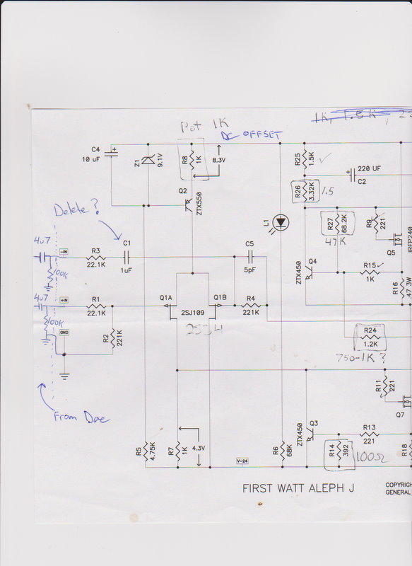

Just wondering if the common mode DC on the outputs of the Legato(Dac output stage) would be a problem for my Aleph J. Voltage between signal ground and +/- out is 7vdc. Voltage between the +/- out is 0vdc. Would it be better just to add a coupling cap to the + in on the Aleph J? Thanks for any help. I'm really looking forward to hearing these togeather 🙂

Wow that was a fast reply 🙂 Thanks. Caps it is. On the negitive input to the Aleph J the cap is after the 22.1k resistor. Do you think I should copy that on the + side?

and , yes - short instead of C1
those CR cells are intended to be on Legato side ; that's why resistors are on outer side , to prevent any cap leakage/discharge during re/connecting procedure

- Legato 3.1 balanced out to my Aleph J (Common mode DC)
