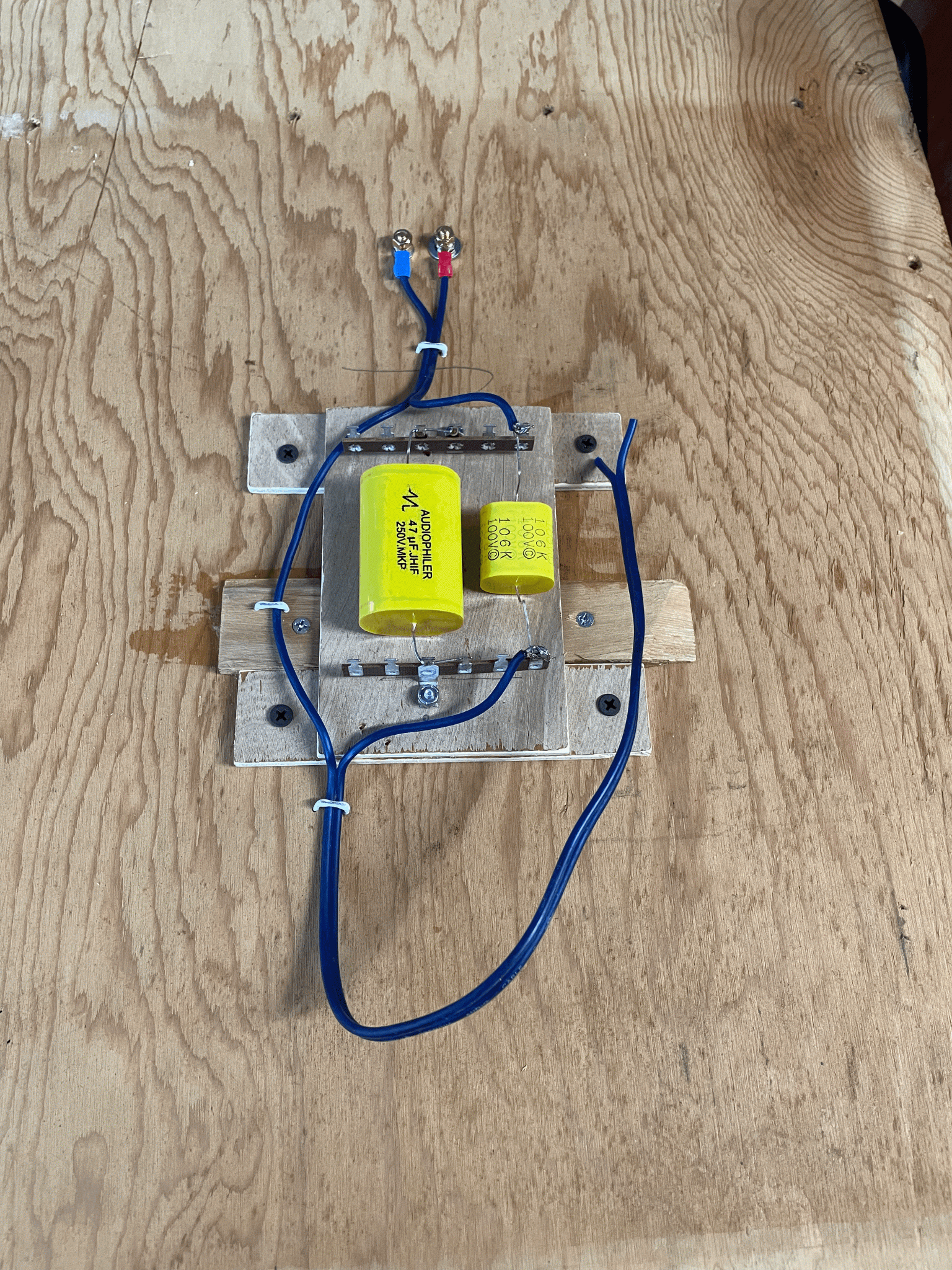

I also added 57uF of blocking capacitor ahead of the CDs to protect them from user error. These were some film caps mounted to tags I had in the parts bin.

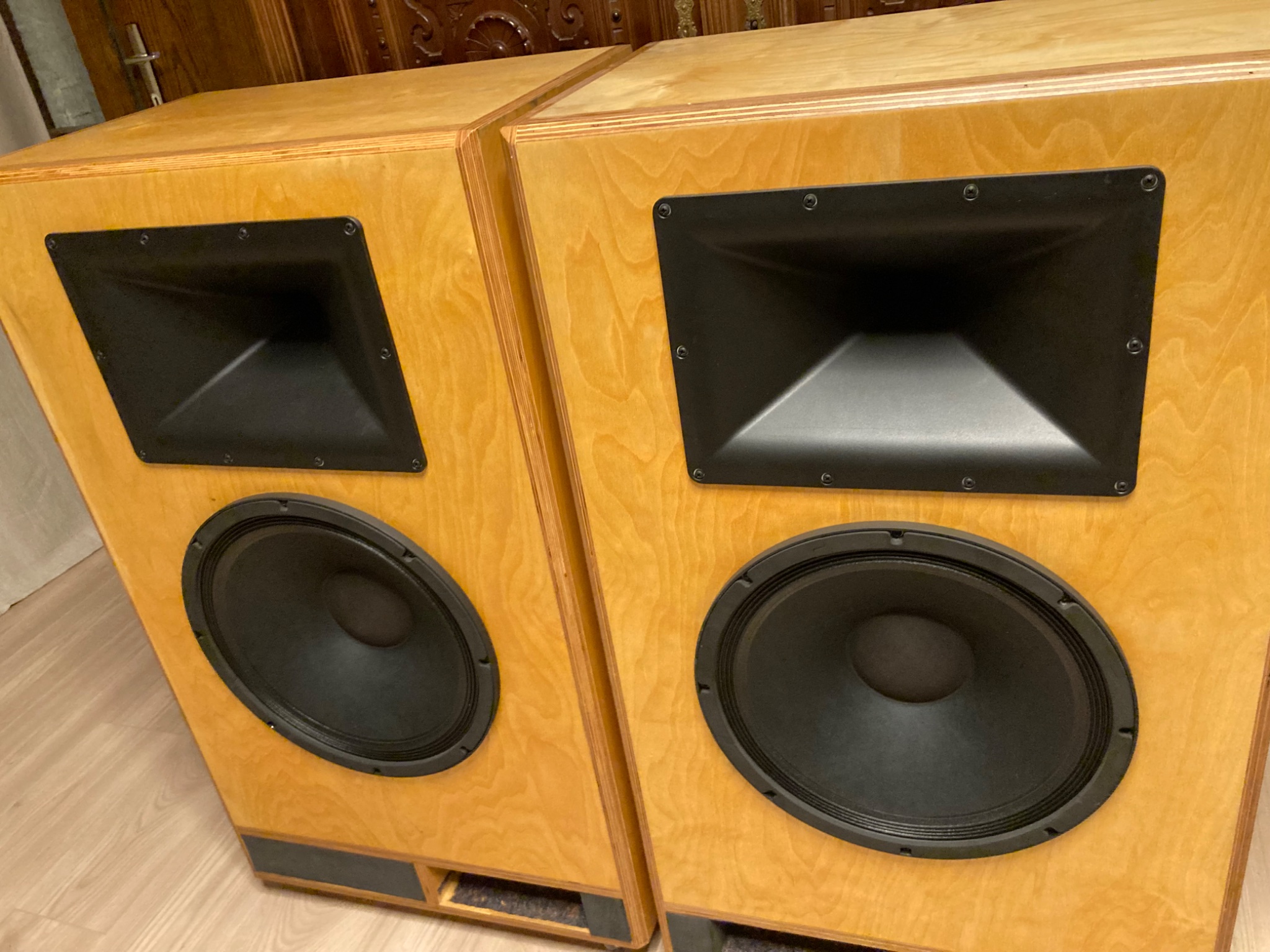

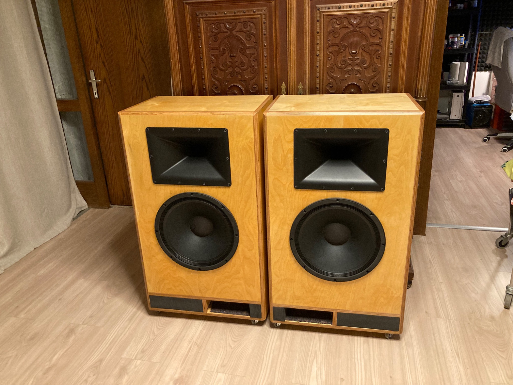

Faitalpro 15pr400
Same waveguide as yours, with a denovo Audio DNA 360
Good driver choices. If I had to go out and buy drivers for this build, I probably would have gone for a 15" driver (most likely a JBL 2226). I almost bought a pair of DNA360s long ago. I'll be they sound great.
