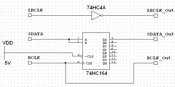

Left-justified I2S to Philips I2S Converter
I would like to convert from left-justified I2S to an I2S format compatible with TDA1541A(let's call it Philips I2S)
Please see this datasheet, page 6:
http://www.analog.com/UploadedFiles/Data_Sheets/AD1852.pdf
(conversion from the format in figure 3 to the format in figure 2)
The question is whether the attached schematic would do it in a problem free manner. Also, does anyone in here prefer some manufacturers over the others when it comes to these logic chips?

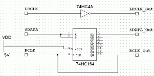

You should check the timing relationship between BCLK and DATA.
You should also consider setup and hold time of 74hc164 and compare that with the source signal. See attached image and refer to datasheet of your 74hc164 for the limit of Tsu and Th.

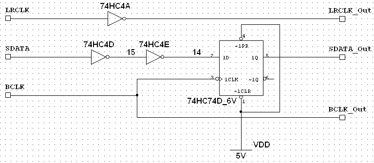

So what about this? Double inverting for delay than flip flop
How much delay would you expect from 74hc4d and 74hc4e? I see no effect in addition 74hc4d and 74hc4e before 74hc74.

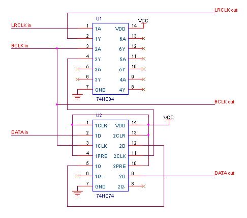

You still have the same problem of timing relationship between SDATA out and BCLK. 1Q is updated right after rising edge of BCLK. This mean that DATA out is only valid after rising edge of BCLK. Your desired format require that rising edge of BCLK is somewhere around the middle of DATA.
To deal with this problem, you may see that I recommended to invert BCLK for the 2nd half of 74HC74 in the schematic. Each half of the 74hc74 cause a delay of 1/2 BCLK cycle. I am pretty sure about the logic but I have not tried it therefore ...
Yes it may work if you are lucky.
Why?
In both schematic, data is delayed by 1/2 BCLK cycle plus the propagation delay caused by the logic chip. Propagation delay time is given in datasheet as max limit only. In fact propagation delay time is normally shorter than max limit and also depends on brand of logic IC so we do not know exactly whether the propogation delay time is long enough for the receiving IC to work.
