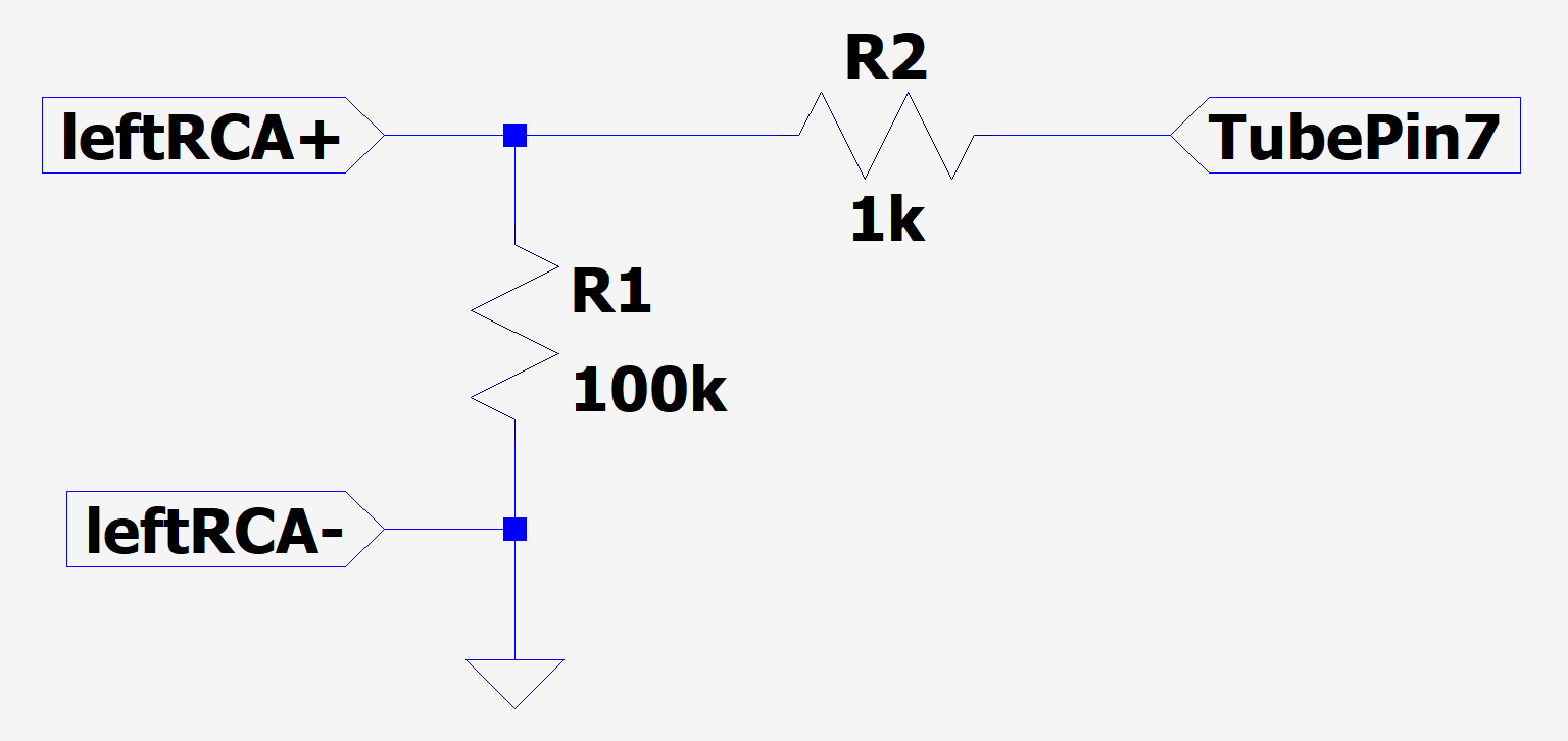

Currently:
Left RCA (-) to ground, left RCA (+) to 1k resistor to input tube pin 7. 100k resistor across left RCA (+) and RCA (-).
Right RCA (-) to ground, right RCA (+) to 1k resistor to input tube pin 2. 100k resistor across right RCA (+) and RCA (-).
Basically your input should look like this
So from your description, this should be right and you will have 100k input impedance.
Is the ground of the leftRCA- ( and rightRCA ) going with a separate wire to a low noise ground connection?
Thanks, what your image shows is what I have currently wired. Yes, the ground from the (-) has its own independent wire running to star ground.

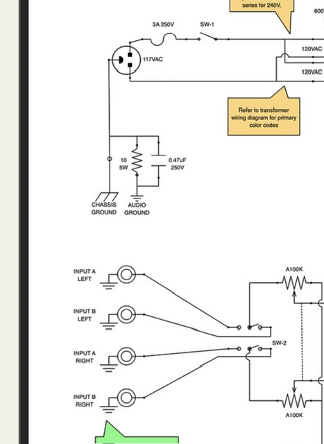

The star ground for circuit and PS grounds both tie to the IEC’s earth ground. Again, it’s in a wood chassis so a chassis ground like would be used on a metal enclosure isn’t an option.The grounding scheme is very strange. All signal grounds, including power supply, should go to a single point, and should float from the chassis. This point should ideally be at the lowest signal potential of the circuit, that is, the input. AC ground goes to the chassis for safety. Remember that power supply decoupling caps for a given stage are part of the AC signal return for that stage. Separate them and you've created a much larger AC loop for the circuit. For example, the 3.3uF decoupling caps for the 6N1P should be grounded to the same point as the grid resistors and cathode resistors for that tube.
If you need shielding from the top plate or chassis, you can link the chassis to the signal ground at one point, but it is better to leave it floating, IMO.
In your case, I think the problem is one of proper grounding of the input grid. Your source is acting as a ground reference for the 6N1P grids, and when you unplug it they are left floating somehow and causing the 6N1P to oscillate.
It could be the circuit ground tied to IEC that's a problem. Also, if there's not metal plane at all, your transformers may not be saftey grounded. I've used wood and Delrin material and I tie all the transformer shells to IEC ground and let the circuit ground float. Just a suggestion.
We're only assuming that the symptom is motorboating (VLF oscillation) but it sounds like it could be squeeging (VHF oscillation in repetetive bursts at an audio rate) instead. "Star" grounds encourage this with their long multiple ground loops. They're problematical in a stereo amplifier, at best.
I'd like to second grovergardner's concerns about PE/safety ground wiring. Something as inherently dangerous as a wooden chassis requires extra attention to PE concerns. You might want to investigate the bridge diode // 10R method of isolating signal ground from PE (for low voltage) with failure protection at > 1.4 Volt +/.

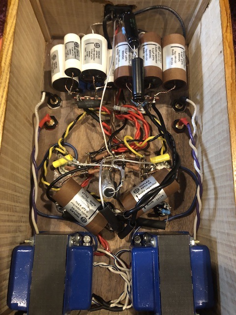

care to share a picture of of the wiring ?
A picture is worth a thousand words!A picture of the amp internals could be helpful.
Following up on some previous posts, without the input tube in I measure 100k resistance between the input (+) and ground.
For interest’s sake I put a 2 prong adapter on the power cord to lift the whole ground. With that in place the right channel still motorboats but the left channel did not. I reinserted the left RCA, removed it again, and it MB’d too. Then re-inserted left RCA, removed it a third time and no MB. So I can’t explain what is happening but it is likely ground related.
I don’t have time today but this week sometime I will tie the transformer to earth ground and remove the rest of the audio circuit from the earth at the IEC connection.
Unless someone has a better suggestion after seeing the photo.
