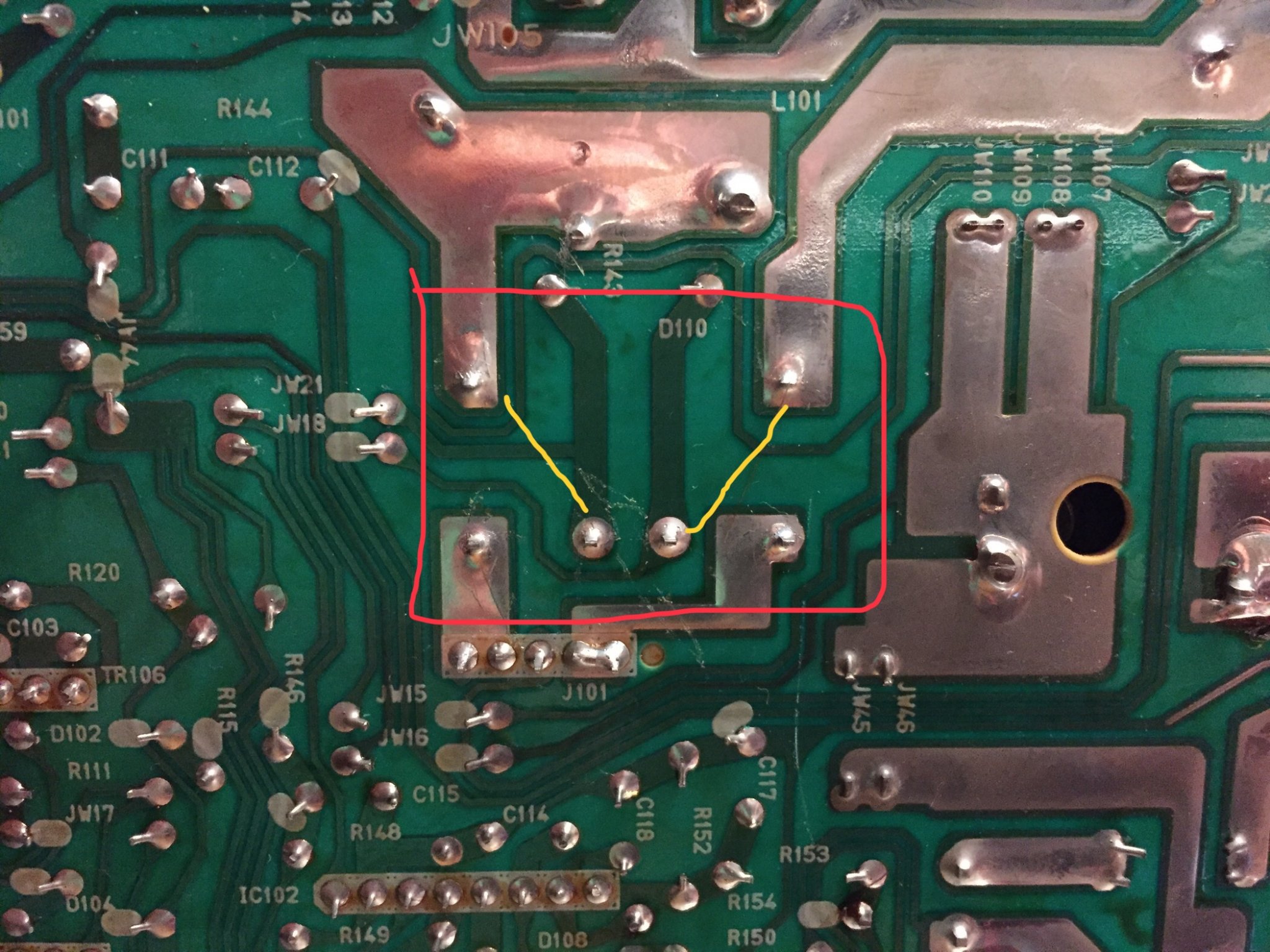

Hey,
Thanks for you replies ! 🙂
I am still a little lost and have quickly noticed that my seemingly lack of electronics knowledge is becoming much more evident. ._.
Just to confirm would this be the component sitting at RL101 ( https://www.benl.ebay.be/itm/2x-Omr...-24V-DC-Made-in-Japan-24VDC-NOS-/263588363215) it seems so. Ive attached a photo. On the top side of the PCB it is labeled with RL101 Are you able to help me through the diagnosis of the component, if i have the identified correct one ? Is it possible to diagnose with a voltage meter without desoldering the component?
Thanks for the help !
Hopefully I can save its life hehe

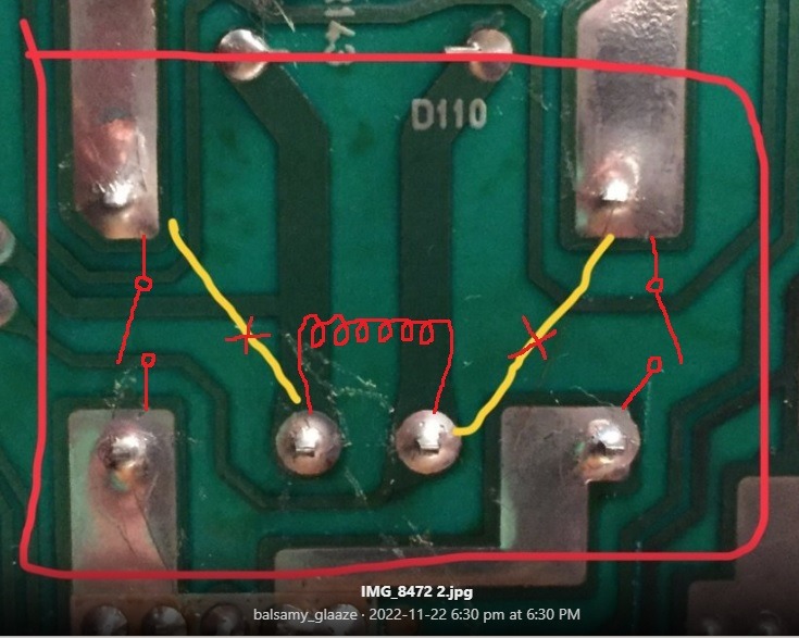

Hey,
Thanks so much for your response. I believe I have identified the RL 101 component of the DC Relay. Attached is a photo of the region and the yellow lines are the pins i tested the voltage. The reading was around 65mV, does this indicate failure?
Apologies for the lack of knowledge but hopefully i can resurrect this amp 🙂
Thanks for the help

Try to resolder the relay. The power soldering seem to have a breackage. Simply apply a small amount of tin with rosin (or flux) to recover soldering points. If the fault persists, try to short the relay contacts with a piece of wire. If its ok, then replace the entire relay or (it depends of your skills) may clean the relay removing the plastic cover and using sand paper of very very fine grane (800 or better). Clean with isoprophyl alcohol and let it dry. Thus re-place the relay in its place. I did such a task several time with industrial relays no longer available to replace.

I was suggesting you measure DC voltage from L101 to ground (eg. speaker ground binding post); this is essentially the amplifier output prior to the relay contacts and is a quick clue about health of the power amp. 65mV re ground is a bit higher than I would have expected, but not alarming. If your measurement was in fact Output to ground, you should observe the same 65mV on both sides of the relay output contacts and at the speaker binding post. (You should also find energizing voltage across the relay coil.). Osvaldo's advice is excellent if there's anything amiss re relay continuity.
This looks like the likely connections. If one channel is still working, there's no point in confirming energizing voltage on the relay coil -- the usual first check.
The traces to measure are across the contacts, one pair for each output. Anything over a couple/few millivolts with a speaker connected would be suspicious. You can measure on the AC volts range if there's a low signal, or DC Ohms with the volume down; if the latter, measure in both directions (polarity), so that a few millivolts of DC offset doesn't masquerade as the desired low-resistance indication.

I continue speaking with myself, but I managed to repair the other amp too.
The issue was the relay. When tapping relay cover with pencil the left channel worked and not. I desoldered the relay and opened it and wiped it genly with 800 grid paper. Soldered it back and it works like a charm.
I write this if someone in the future have same problems.
