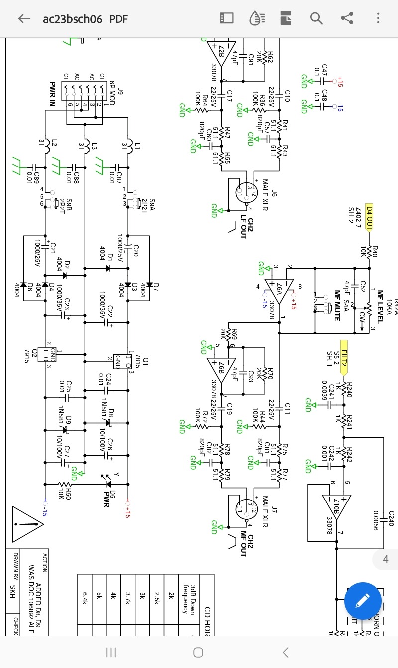

Here is a guy who gets help and reasoned facts and he refuses to believe, preferring something he has no clue of but only because he saw a schematic from a company he misinterpreted. Mind you, Rane is a respectable and competent company.

https://www.ranecommercial.com/legacy.php
I think it was a language barrier here - meaning to say “rose colored glasses” having nothing to do with people’s color.
But all the technical people are RIGHT about the function of the diodes. I have seen first hand what happens if they are omitted. Under just the right conditions a pair of +/- 3 terminal regulators CAN misbehave and it does eliminate that particular failure mode. Which takes out the LOAD, not the regulators. Rane has a good reputation, they don’t want products failing in the field if ten cents added to the BOM can prevent it.
