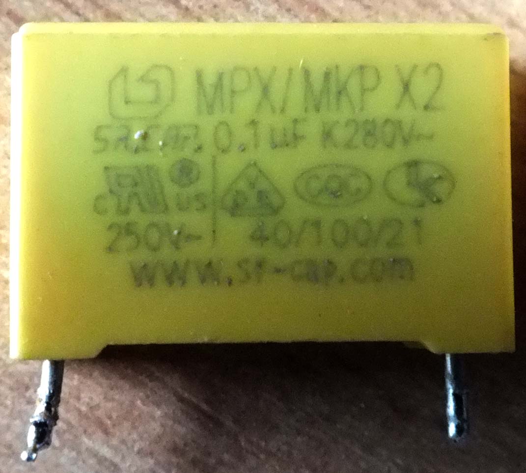

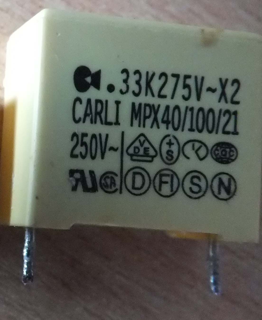

Just as I see it, without any opposition of any kind compared to other different views, it is even simpler to replace the bulb with one from a well-known brand.Much simpler to adopt a "symptomatic" treatment: 99% chances of success, quick, simple, and perfectly legit if you use a X type cap. Life is too short to burden yourself with non-existent problems.
In the unlikely case it doesn't work, you can always come back here to discuss an alternative solution, but I don't think it will be the case.
In addition, the cap will protect the lightbulb against surges, induced by lightning strikes for example. All benefit
That way you do not intervene in any way on the electrical system and you may also hopefully have proof that the electrical system itself is in order (which would definitely be good news).
If it doesn't work then I would intervene by modifying the pre-existing electrical connections by adding a suitable capacitor as already suggested.
