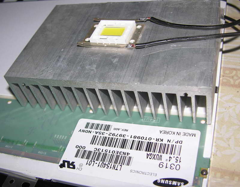

Led projector update
"It's not about heat, it's bulb life."
Actually with the latest arc lamp prices it's all about heat/noise rather than price/lamp life. You need to hunt bargains on ebay or try a deal from China/ywh though.
"This means that I would need 8-9 LEDs to get the same light output"
If only things were that simple!
Right now I get about 8 lumens from the 150lm I drive the led to. And that is with fine optics, because light collection is the challenge. The image is good in the dark, and if I keep it less than 1m I can even follow it with some light on. The upside is the damn thing is pretty much heat/noiseless.
Reallistically I could probably approach 20lm with some effort, but it would still be a far cry from emission displays, light and convenience wise. And they announced 150lm led projectors, so it's just a matter of time. Meanwhile Guy is right: the arc rules the projection world. Non laser leds can't touch its luminance.
Nice to see you still around ozone. Have you measured your light output?
