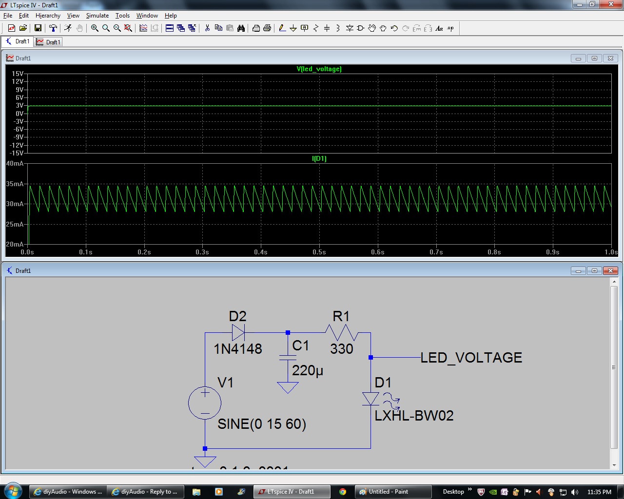

Depending on your particular LED type, here is a sort of dumb, brute-force way to do it:
Tap off of the 15 VAC with a 1N4148 or 1n914 (or almost any other) diode. Follow that with a 220 uF (or whatever) electrolytic cap to ground. From the diode-cap junction, run a series 330 Ohm resistor to the cathode of the LED. Connect the LED's anode to the ground end of the capacitor.
NOTE that the 330 Ohm resistor will dissipate over 300 mW! So you would need to use at least a 1 WATT resistor, OR, use four 1/4-Watt resistors of four times the needed value, in parallel.

How many mA are needed?
With 4k7 the LED will have less than 1mA average current. Lowering the R to about 300 Ohms should give a little over 10 mA avg. But then the R is dissipating about a quarter Watt. Different color LEDs will behave slightly differently since they have different forward voltages. I don't know what color I was simulating.
I had it calculated at about 4mA peak current through the LED with the 4k7. That may be too low admittedly, which is why I mentioned paralleling another resistor. I think 300Ω is too low, in your circuit or mine. The differences with different colored LEDs appear minimal; the final resistor value is a question of how bright the OP wants the indicator.

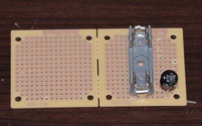

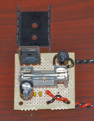

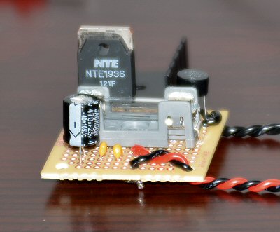

Ok I decided to cheat
I realized that there are 12V LED diodes in blue and red 5mm. SO here is the cheat..... Radio Shack sells the LED in blue and red that I need in 12V with the resister built in. So instead of making a 5V supply from a 15VAC source, I went with a 12V 2A regulator. I copied a circuit from one I found on Google, the AC side goes into the bridge rectifier. The hot from the bridge rectifier goes through a fuse, across to the regulator in. Between the fuse and the regulator I have a 470 uf electrolytic 25v cap and then a .01 uf cap 50v ceramic. From the out of the regulator it goes to the 12+ lead with a .01uf cap between it and the lead. The ground of the rectifier goes to the ground of the electrolytic, the electrolytic negative goes across the negative of the first ceramic, then the ground of the regulator to a ceramic cap then to the negative DC lead.

Cheat? There's more than one way to skin this cat. Yours is one of those ways.
Your circuit could be improved by taking into account what sort of supply the LED really needs.
A 2A regulator is overkill; one of the 78L12 regs in a TO-92 package is all that is necessary. No heatsink required. And actually an LED doesn't even need a regulated voltage. There are better locations for the fuse also. Lastly, you're using the solder side of the PCB for the component side.
But you're DIY'ing & learning and that's the most important thing.
