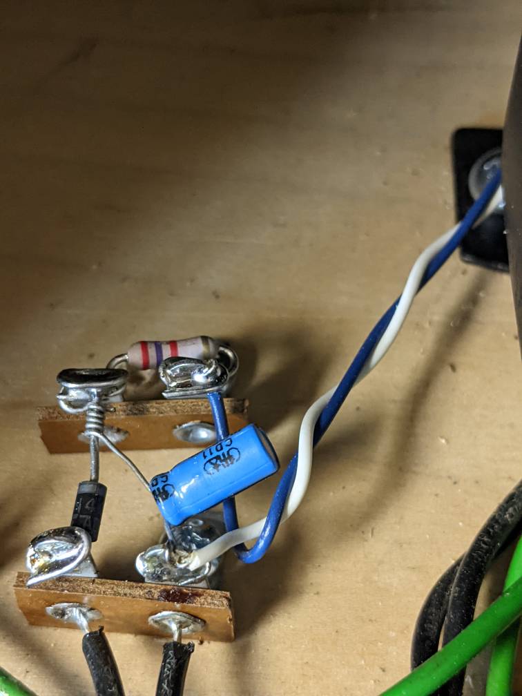

I split my amplifier into two chassis for a myriad of reasons but now I don't have access to the voltage I need to run my led power indicator. I was thinking running it off of an AC heater circuit I have would be perfect given the ac signal being close to 3 volts due to the diode effect of the led.
I am a little concerned with introducing noise since the led will be switching on and off at 60hz. ( or maybe 120hz?)
So is there an easy way to isolate it so it can't put any noise into the heater line or am I worrying about nothing?

This was a 16v winding. Adjust your resistor for 2v to the LED (which is at the end of the white and blue wires. PXL_20210107_222434573.jpg

It needs a series resistor, couple hundred ohms, to control current.
I have run LED on heater power without audible buzz.
However if you move your head fast, you will see the flicker.

This was a 16v winding. Adjust your resistor for 2v to the LED (which is at the end of the white and blue wires.View attachment 910008
Hi it is right to adjust for the maximum current you want through the LED as their forward voltage follows according the known properties of LED. Modern ones start to glow with around 1 mA and their Uf is around 1.6 - 1.8V depending on color. If does not want the whole room to be lit one could calculate with 2.5 mA for the green/amber/red ones. White/blue/purple and all the "blue LED derivatives" have higher Uf of between 3 and 4V. I don't know about their current as I don't use these but a datasheet may help.
(Ubat - Uled - Uf diode)/Iled = R
A diode (to protect the LED from AC and give the LED a longer service life) and current limiting resistor are the bare minimum but the cap you added prevents 50 or 60 Hz flickering which is nice. LEDs die from a too high reverse voltage which is why they don't live long without the series diode.

FWIW I've never had an LED require a series diode for low voltages (<30V). Yes, it will flicker at line frequency which kills me so a small cap and a bridge made from 1n4148 is usually employed if I use the heater winding for the LED.
Yes when using a diode bridge you already have the AC protection as a bonus. LEDs don't like too high reverse voltages so you did it right (coincidentally). Connecting a LED just with a resistor to AC is not OK in general (depends on how high voltage is) as it will then see a reverse voltage. In DC circuits they don't need a diode in series of course.
I used the diode bridge because I didn't like the flicker. The LED will flicker away for years running on a 6VAC supply though.
1: They do survive less than 30V (without using a diode in series). (I see now I put a greater than symbol by mistake or did I? My brain hurts today). I've even had one run off 120VAC for years using a 22k resistor only (we used to make a light for the light switch when we were kids so our parents could see where the switchplate was in the dark). YMMV? Not all LEDs are the same, obviously.
2: Yes I use them on the HV supply. It's DC. No diode needed.
3: Yes, when I do use it from the AC heater supply, it flickers so I use a bridge and cap to get rid of it - nothing to do with protecting the LED from excessive PIV.
4: They WILL work and flicker for years if you run them from a 6V AC supply using a dropping resistor.
