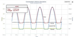

SY, I wasn't satisfied with leaving the "simulated LED circuit" alone; I used PartSim to do a PSpice sim, which … naturally … took far more time than I anticipated.
However, my intuition about the circuit is correct. Excusing for the moment that the transistor part numbers in the attached circuit aren't optimal, I found 3 things:
1. The use of a capacitor between base and collector markedly stabilizes circuit
2. The voltage in darlington configuration at Vcoll varies by only millivolts over current ranges of 12 ma to 55 ma.
3. The voltage-drop is easily "programmable" via adjusting the base-to-emitter shunt resistor. (smaller resistor → higher collector regulation voltage).
Who knows… maybe this, or the MOSFET version, might become the "next big thing", since strings-of-LEDs aren't exactly adjustable after they're all soldered together! Its also potentially quite inexpensive to build.
GoatGuy
PS: My use of a DC supply + an AC sine supply, plus the 1K resistor was an absurd but effective hack in order to produce a simulation of the cathode-current of a tube being run in Class A mode. I'm sure there might be a more elegant way, but this for now was it. Please accept apologies.
In use, the two supplies and the resistor would be eliminated, and the circuit would be inserted between cathode and ground.

Cool… using a PNP as an "upside down" emitter follower. That ought to work pretty darn well. You only need 1 ma or so feeding the Zener in order to realize potentially up to ½HFE milliamps of cathode drive.
PNPs though tend (all things being equal) to be on the slow side. I still would expect recovery in under 1 μS. As you say, the deployment of a Darlington cuts even further then B+ supply drain. To dozens of microamps. One could insert a trimming potentiometer in series with the zener (on the ground side), plus a capacitor across it (not in signal path!) to make a variable zener in a small range. The cap would be there to squash both purported and actual trimpot noise, long term
The cap is what would worry me for overload recovery. But hey, you're the guy with the sim software, tell me! :D
edit: Sorry for the neck cramp.
Neck Cramp ≡ LOL
The cap doesn't affect recovery 'cuz its on the "base" side of the emitter follower, and serves just as a low pass filter for the variable voltage drop potentiometer.
BTW: the combination I put up there that didn't include a Zener gets near-absolute (zener-like) regulation because of the near-constant VBE voltage drop. Kind of like a LED of low forward voltage. In the end, the constant-voltage is straight forward: Vreg = (R1+R2)/R2 × VBE of the darlington pair (1.26V in diagram).
If I leave the R1 (470k) alone and put a 15K "safety" resistor in series with a 25K Allen Bradley trimpot, one can vary the voltage from (15k + 0k) = 40.7 V down to (15k + 25k) = 16.4 V. A plenty broad range for output tubes of ordinary garden variety.
I've included a followup with the Class-B mode push-pull behavior. It demonstrates saturation/cutoff recovery. I used 1 μS sim steps… to catch the glitches.
