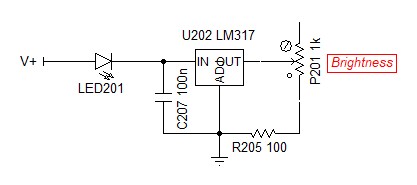

I recommend you use an adjustable current source like this:
This will supply anywhere from 1 mA to 12 mA to allow dimming the LED to an acceptable level.
You can string together multiple LEDs in series as long as you supply enough V+ voltage to overcome the total voltage drop of the whole string.

What source of power is your DAC going to have?

So the design is for a my buffalo dac that has been in a chassis I bought from AliExpress but it’s been getting just too hot. The psu’s run naturally hot but where I live in brisbane it’s just too much for me to be comfortable (it’s in a glass hall cabinet with fans but probably not enough). I was a 1/4 way through putting the dac in a case which would work quite well with a class a amp however I have since decided to put that case to a different use.
I’m entertaining the idea of a layered aluminium chassis with each layer rounded over. In between an undetermined number of aluminium layers I will have an acrylic layer with leds behind. If led heat is an issue there would be an aluminium layer surround by acrylic.
Each acrylic layer would have rgb leds like they do in pc cases these days.
Each aluminium layer would be thermally attached to each other with the psus attached to these as a heat sink. Should be plenty without factoring in the led heat dissapation.
Could I use a placid HD psu for the leds? Current is adjustable with the remainder of what’s used shunted and dissapated.

It would work if the current can be adjusted to the proper level for LEDs...but it would be way-overkill for the application. The circuit I posted is super simple, reliable, and a small footprint on a board but could be also easily be done "dead bug' style. Oh, and it too is adjustable with the remainder of what’s used shunted and dissipated.
