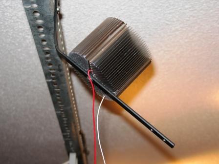

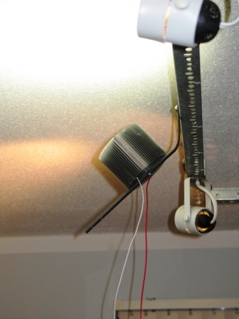

Got myself Cree CX2011 from Mouser and aluminum Heatsink from Ebay (China) for experimenting. I mounted the prototype close to the ceiling and powered up (see photos). So far, so good. Running the LED at 0.43A @ 44V (19W). The heatsink is at about 55C, just perfect.
It is difficult to compare the brightness of the LED to that of the halogen 12V bulb because the radiation angles are different (120 for LED vs. 50 for flood 12V bulb). Subjectively, they are comparable.
I will post a progress report if I decide to go ahead with a project.

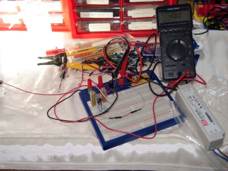

Ordered MV LPV-60-48 switching power supply from Jameco (48V, 1.2A). Connected CX2011 to the power through the current source. I used LM317 voltage regulator configured as a current source (sampling Resistor R=3.0 ohm). The setup is working perfectly. I guess this is the best way to go. LP-PV-60-48 can be used to feed two LEDs and each led will have its own current source. LM317 needs small heat sink (4.7V is dropped on the CS at about 0.4A current).

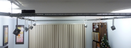

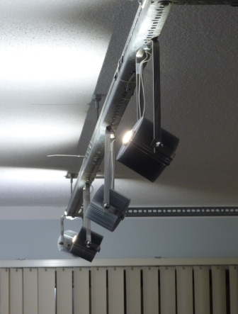

Finally I completed the project and want to share some details. I ended up with 7 CXA1512 (newer, brighter and cheaper!) and one CXA2011 (because I already had it). For 8 LED lights I used 4 LPV-60-48 power supplies. One power supply per 2 LEDs.
Room is super brightly lit even though all the light is reflected from the ceiling and walls.
Overall I am very happy and hope that these lights will last quite some time. On the negative side, the cost of the project is quite high.

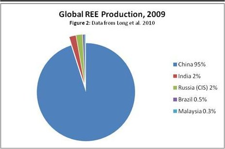

what is the main "ingredient" of the typical LED used in residential/commercial lighting? Is this something that the planet has in large quantities or will we be hearing stories in 50 years of LEDs being abandoned in favor of fireflies?
"Rare earths"
(below) worse than OPEC 😀 !
New mine in BC , canada , S. america (bolivia- owned by chinese).
NO ONE mentions Afghanistan .... they could have more than the Chinese.
One wonders why everyone likes Afghanistan (really ,really, LIKE it ! $$$)😀
OLED's still use a little Indium ... but MUCH less than todays LED's.
They actually did study fireflies as OLED's are similar !
