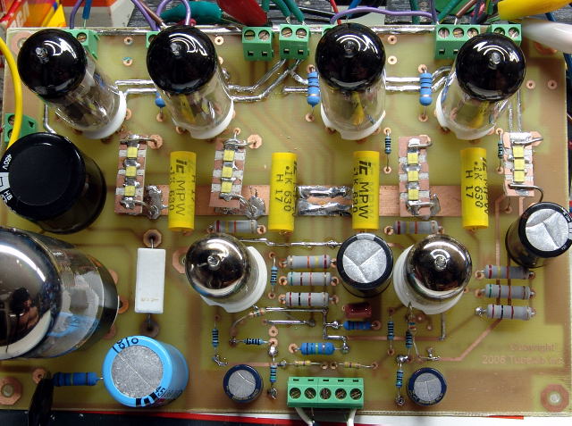

It is indeed possible to use an LED in place of the cathode resistor and capacitor in the Simple SE and the Tubelab SE. As with any amp modification some experimenting is necessary. There is a fairly wide variation in the 12AT7's used in the Simple SE and a really big variation in the 5842 used in the Tubelab SE, which is the reason for the pot. LED's are usually consistent from device to device within the same batch, but exhibit some variation in voltage drop from batch to batch.
The easiest way to do this is to build the amp normally, and then measure the plate voltage on the driver tube. Remove the resistor and cap (or resistor cap and pot) and substitute in several different LED's until a similar plate voltage is reached. If you have several driver tubes, you could try rolling several of these through to find the best combination of tube and LED. I have done this on both amps. The Tubelab SE took a lot of tube and LED swapping to find a good combination.

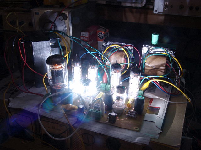

It is possible to use LED's in the output stage on some amps, but this is really only practical with tubes that work with a low bias voltage at relatively low current. The EL84 is one of those tubes, as evidinced by SY's RLD. Of course I had to try this too, so I made the WLD! It is a prototype Simple P-P board. In place of the cathode resistors I used a little ceramic substrate with 3 SMD white LED's in series.
Did you measure the dynamic impedance of the white LEDs?
edit: from the I/V graph in the datasheet for a VAOS SP4W4, which looks a lot like yours, the dynamic impadance at 100mA looks like about 2-3 ohms at Vf of 3.2V. Pretty darn good!
I didn't until I saw this post right before I left work. I connected one (unmounted, no heat sink) across a fancy digital power supply and stepped the current in 10 mA steps and recorded the voltage. The data is below.
10 mA 3.00 V

The dynamic resistance drops with increasing current (expected) and is 2 to 3 ohms over the range seen in an EL84. The ultra low resistance in the 120+ mA range isn't real. The LED is frying!

Unfortunately I have no idea what the specs or the vendor for this part is. A few years ago there was a massive layoff at work (350 engineers in one day). The clean up crews came through afterwords and threw most of the unmarked stuff in the trash. These looked like vendor samples since they were an unreeled strip. I am guessing that these were intended for the flash in a camera phone, so they were not made for continuous duty. The dynamic resistance looks very low above 80 mA but there was some serious chip heating going on which got worse as I turned up the juice. The white light turned bluish at 150 mA and the chip started smoking at 200 mA. The readings and the light returned to normal after several seconds at 70 mA so that is probably a safe current. I had the LED's in my Simple P-P for several weeks until I broke one of the ceramic substrates.
