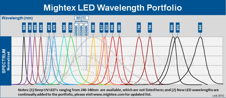

So with the data provided it looks as though chlorophyll A is at highest absorption around 425nm where chlorophyll B is closer to 470nm. They both are absorbed to a lesser degree at 650nm for chlorophyll B and 675nm for chlorophyll A.
This is quoted University of Massachusetts article:
"The vital rays for plant growth are blue-light at 450 nm, red light at 650 nm, and far-red light at 730 nm. The 450 and 650 nm rays are required for plant photosynthesis, the production of food from light, water, carbon dioxide through the catalytic action of the plant pigment, chlorophyll. The 650 and 730 nm wavelengths control flowering through light-induced changes in the plant pigment, phytochrome."

What I am looking for in addition to the wavelengths is the power ratio of the three sources of light.
There is little point in shoving out more power than needed at one wavelength while not putting enough out at another wavelength.

In my own experience to not waste power on certain wavelengths I only use blue light around 450nm for all the early green growth. When plants mature and it's time to flower or fruit that's when I add the red 650nm spectrum in.
I'd throw in a small percentage of red w/ the blue light, and blue w/ the red, to see if the plants were any happier. I need to get some LED's and build a couple red/blue fixtures before fall, to do some experiments.
I've read different plants have different reactions to the red or blue light, too. People on the hot pepper forum say peppers get bushier under red, and tall under blue. That makes things more difficult for a traditional gardener, w/out a monoculture.
