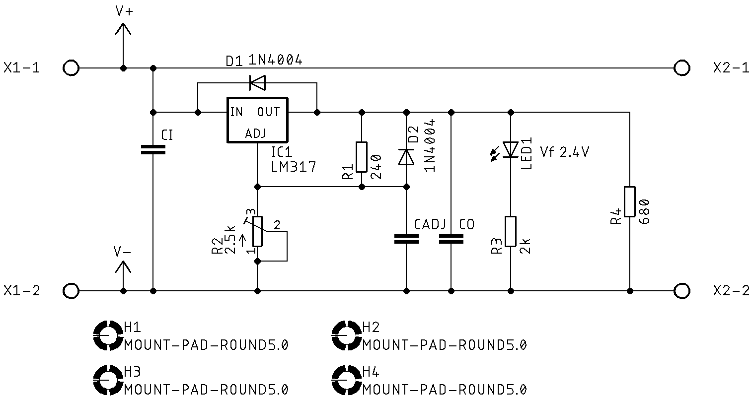

Hello,
I want to design a small led dimmer pcb for the front panel of an amplifier to adjust brightness for supply voltage in the range of 12 V to 24V.
I came up with attached circuit, Load resistor R4 can be adjusted to have min load current of say 6-10mA.
If V out at regulator is adjusted from 4.4 V to 14V, the current through LED can be varied from 1mA to 6 mA.
Will this work?

Anyone working with LEDs should know the simple formula: (Ubat - Ufled)/Iled = Rled. You can do it complex with a lot of stuff but it really requires just 1 (one) resistor. When fed AC you'll need some extra parts to protect the LED and also avoid flickering. With modern green, red, amber LEDs Uf of the LED is around 1.8V and current for normal brightness is about 2.5 mA. With blue, white and purple LEDs Uf is 3...5V depending on color and brand. You are safe to use 4V in calculations. Current for those is already high at 1 mA! The trouble is that those terribly annoying blue/white LEDs are way too bright even at very low currents. They will give your DIY device cheap Chi-Fi looks which is a choice 🙂 A soft glowing green one is more easy to many eyes and it won't light up the whole room. It will just show that the device is being powered on, no more no less.
*If choosing blue/white/purple always search for diffused ones, the clear types are simply search lights.
The diffusion helps with blurring the point source of the emitter inside the LED, but the primary factor affecting the amount of light "projected" in any one direction is the LED's viewing angle as stated in the datasheet. A wider angle will reduce the apparent brightness when looking directly at the LED and will be more visible (and look better) from the side.
