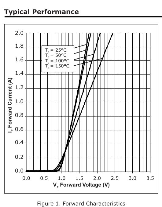

Think about SiC Schottky diodes. The cleanest I've heard to date. Check out the post below.
Vf vs If for Cree Sic Schottky Diode - Measured at cathode-relevant Currents - Maxamillion - Tube DIY Asylum
String of CSD01060A with forward voltage 1.6 - 1.8V and price 1.17 Euro from Farnell seems to be a good fit. However, look at the graph attached from manufacturer's data sheet. At low currents (typical for vacuum tube circuits) forward voltage drop is only 0.8V and have non-linear region which have to be determined with test.
Anyone actually have tried Schottky diodes in cathode bias?
Theory is one thing yet real life could be very different.

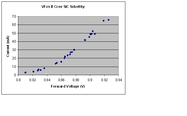

Yes, I use them for biasing the 6e5P driver tubes in my 833C amps. They work great. Sound is very clean and clear. I also used them in a preamp with the same results.
I've attached an If vs Vf curve which I measured myself, very linear in the range of currents I'm using (25-35mA) with a very low dynamic resistance.
Amp build thread with schematics also linked below.
The Midlife Crisis - My 833C Amp Build
