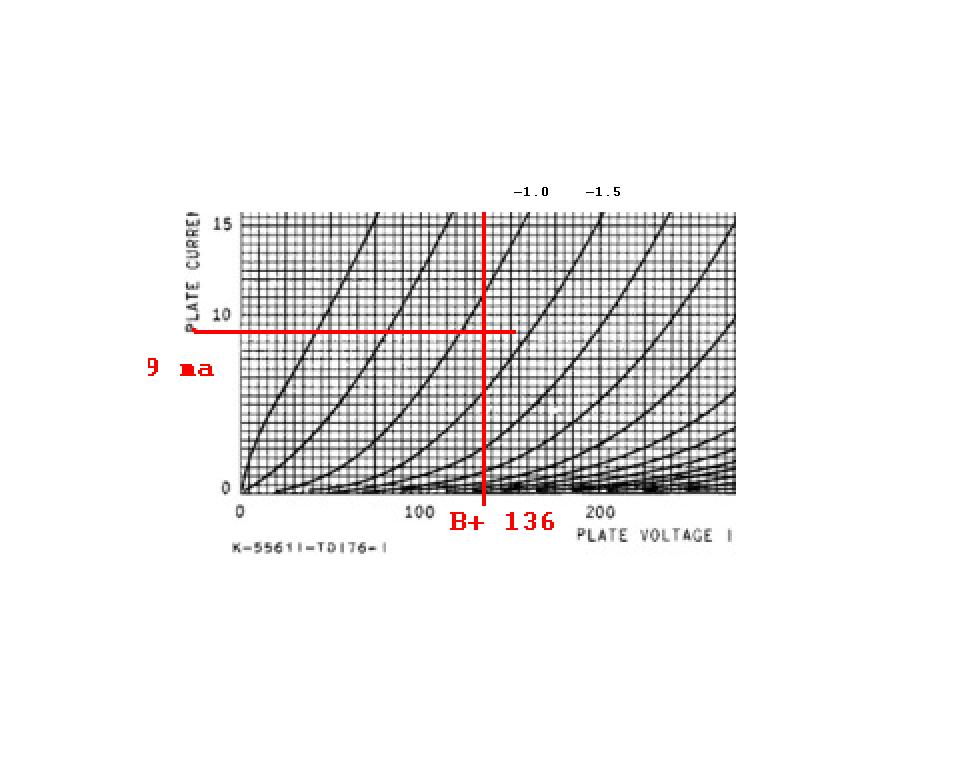

I think I understand LED biasing but rather than ask a million questions maybe someone could tell me if and how I'm wrong? Lets say you are working with a yellow LED that has a forward voltage of 1.2 volts. A minimum current of 5 ma and a maximum of 20ma. I think the forward voltage corresponds to the grid line on the load line graph for a tube? If that's correct then you would draw a vertical line at your B+ and where that line intersects the load line is the bias point. Now draw a horizontal line intersecting that point and then read the current from that line.
I've attached an example, (6GK5) where the voltage is -1.2. the B+ is 136 and the current 9 ma.
Thanks, Kevin

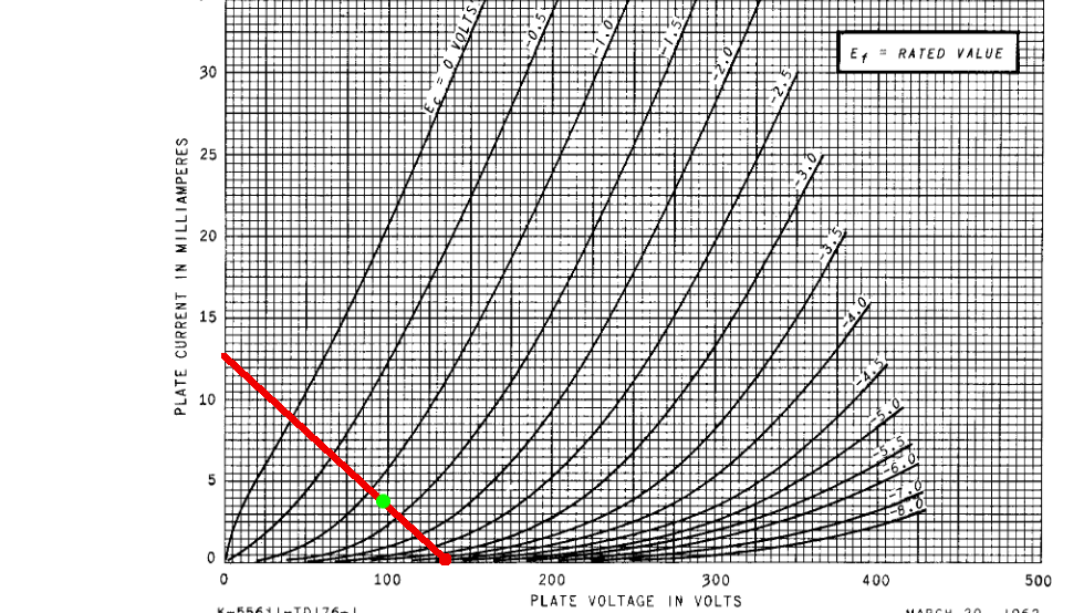

I think you draw your load line normal, so say 10k, B+ is 136, 136/10000=.0136
Now find where -1.2 crosses that load line, looks like 3mA.
Of course I could be wrong, hopefully someone jumps in that knows what they are talking about.

You select the LED based on the required bias point, which is it's forward voltage drop. Different colors (or IR) for different bias voltages. Draw the loadline depending on the anode load as usual. Next, draw the horizontal line from the bias point/FVD on the loadline to the plate current axis et voila, you have the quiescent current passing through the LED.
LED's do have non-linearities unfortunately. The datasheet shows you what current region is most linear. If your in luck, the given tube's operating point will give the necessary current. If not, you can supply the extra needed current with a resistor parallel to the tube (B+ to cathode). A typical red LED used in a 12ax7 stage for example (+/- 2mA) will benefit from the extra current.
Take what ever the B+ and plate load you are using and draw the load line. Since you are dealing with what is effectively a voltage reference to bias with, find that voltage on the load line and see if the resulting current is within the LED limits.

You don't need to feed extra current to the LED. It only increases the bias voltage a bit, which increases rather than reduces distortion.

The LED dynamic resistance non-linearity is negligible compared to the internal cathode impedance non-linearity. Any improvement in LED resistance is more than offset by the increase in bias voltage that comes from running the LED at higher current, so you get more valve distortion. (Not much more, I grant you)
OK, I assumed people would only add extra LED current in order to bring the valve bias up to the correct point, not to go away from the correct point.
So, if the outcome is a correctly-biased valve then increasing LED current will reduce valve distortion just as expected. It will also reduce the (already quite small) LED distortion.
