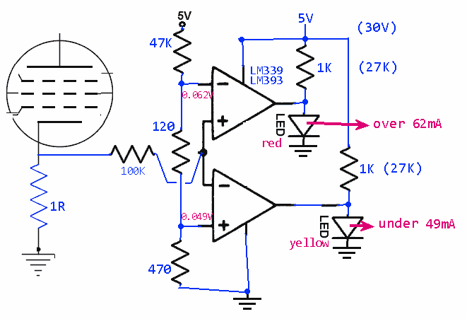

The LM339/LM393 is perfect. Costs pennies, current production (DIP may be old stock). Inputs go all the way to the negative rail. Output is open-collector which allows logic tricks.
The rig below shows red if too hot, turn-down now! Yellow if too cool, no panic, turn up for best sound. When right, it is dark, except signal peaks may flicker.

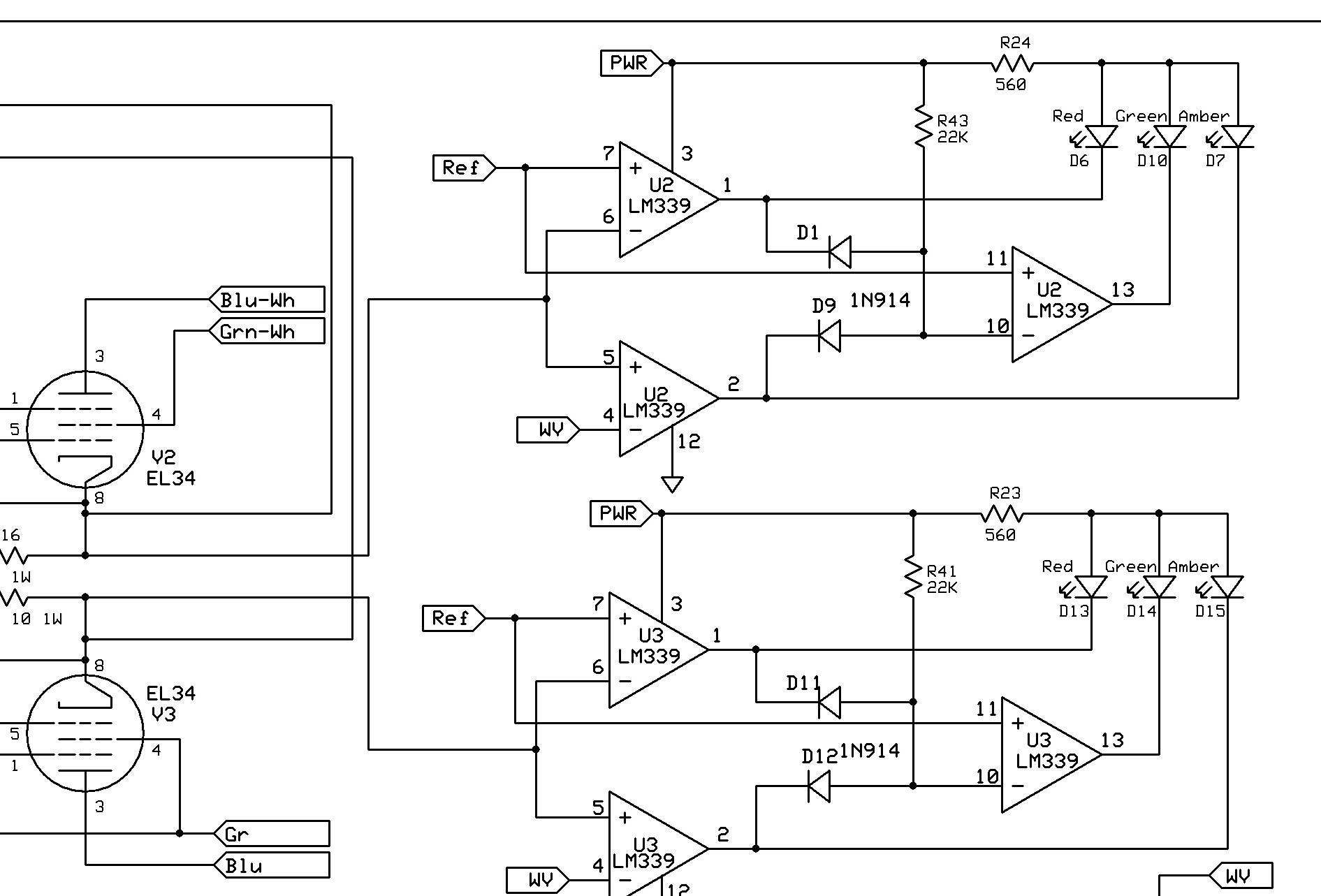

I’ve drawn up a circuit that works really well, it indicates low, high and balanced
Bias. There are two 10k pots that calibrate the window comparators, will have its own power supply, and can connect from a tap off heater winding.

Looks good! I see only a part of the schematic, but if I understand it correctly, Ref is the upper threshold and WV the lower. Depending on the supply voltage, R23 and R24 may have to be changed to stay below the LM339's maximum output current.

Yes, In the YouTube video I posted I was using a 5volt DC Power source,so I used 330R for the limiting resistor. The neat thing is even if the upper and lower window are very close together
Let’s say 650mV and 600mV are my window, the green LED doesn’t shut completely off but the High and Low LEDs are completely off when the target voltage is reached.

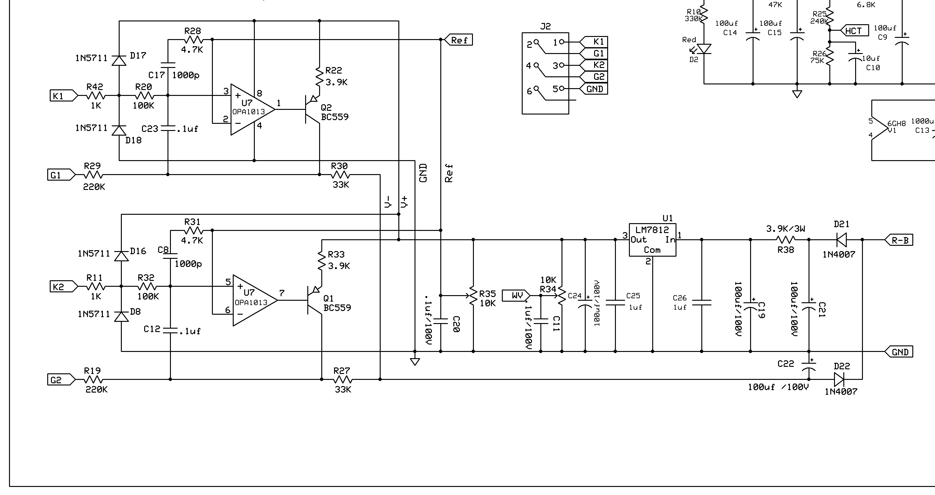

A design maybe using a micro controller instead of an opamp?
This is still a work in progress, there are a few changes in order, possibly changing the overvoltage protection, shunting the overvoltage to ground,instead B+?
