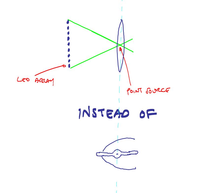

What i meant by the LED array setup is as below. Basically capturing all the parallel rays of each leds an collecting it to a point source. Crazifunguy, could you provide me with the source for the 3000 Lumen LED that you are intending to use and how much are we looking at for that setup?
I think you will find that due to the distances you are working with, you will not be able to focus an array of led's to a point like you want to.
The example as it was explained somewhere else, is using the Sun to burn a piece of paper.
The spot you use to burn the paper is not really a point, its a small image of the sun. The size of this image is found from the equation:
M = -i/o = h'/h
If the image and object are in the same medium it is just the image distance divided by the object distance.
So, back to the sun example, the distance from the sun to your lens is approximately
150 x 10 ^ 11 m
and the distance from your lens to your image is about 0.2m This means your magnification is roughly
-0.2/150 x 10 ^ 11 = -1.3 x 10 ^ -12
(with the negative sign indicating our image is inverted, which we dont really care about).
The diameter of the sun is roughly 1.4 x 10 ^ 9 m, so your image size is
1.4 x 10 ^ 9 x 1.3 x 10 ^ -12 = 0.001886 m = 1.86mm
Which seems about right.
Now we go to your example.
You have a light source which is maybe 100mm diameter at about 200mm from the lens. You want to focus it to a point about 50 mm on the other side of the lens. Your magnification is only 50/200 = 0.25 so the smallest you can make your 'point' is 100 * 0.25 = 25mm diameter.
The second problem is that its not actually a point source at all, its just a smaller image of your LED array. Its not really going to change anything because when you blow it up again on the screen, its still going to have all the uneven lighting that your original light source had.
