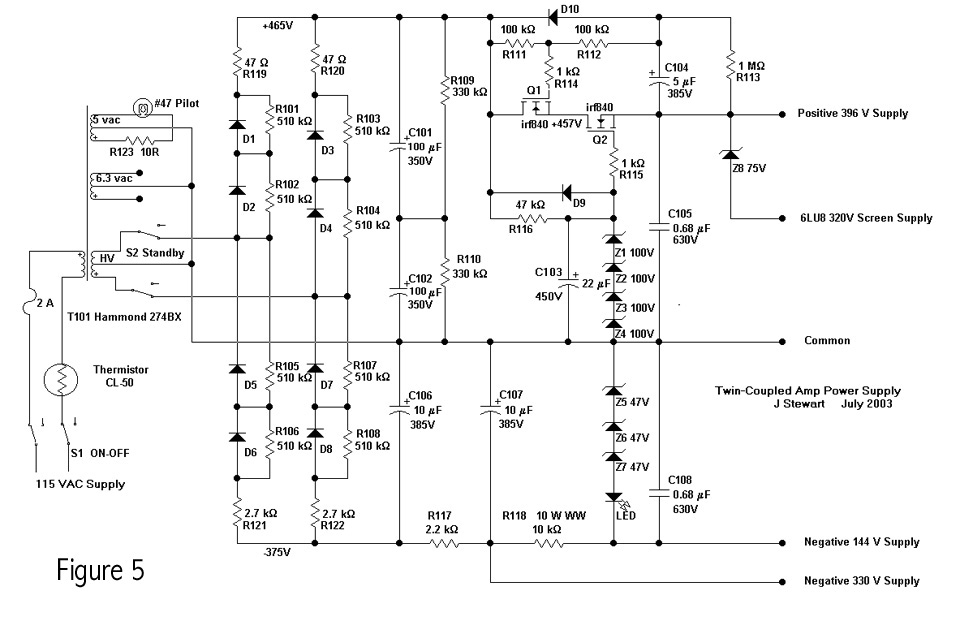

That is a very good point. For convenience I've usually included a B+ standby switch on the experimental amps I've built. So on the clone of the Electrovoice Circlotron with fixed bias I noticed huge currents in the KT88s as the standby switch was activated. I measured some, the scope traces should be somewhere here in my notes from about 20 yrs ago. I'll take a look, might get lucky & find the evidence.🙂
But not a problem with cathode bias, the bias comes on immediately altho the current may be a little higher for a few mS. Depends on the bias resistor & cap time constant.

Don´t forget an important detail:So does a cathode-biased power tube with a cathode bypass capacitor. Sure the inrush is less, but that's a matter of degree, not category.
a cathode self biased tube, by definition, is a self current limited device, which is safer.
Higher than normal current through the cathode resistors automatically biases grid more negative so self limiting current.
Yes, there is a small time constant until cathode cap is charged to cathode voltage, but energy involved charging a cap to, say, 25 or 30V is WAY smaller than that involved in charging one to 300/400V
First the Short Answer. For the curious the details are in the pdf attached from the article published Aug 2004 in AudioXpress magazine.🙂
A solution is possible through the use of a pair of high voltage power FET’s, in this case IRF840’s. I had originally tried using a single FET but found that at turn-on there was more than 500 volts applied to this part of the circuit. That would not be good for reliability since the IRF840 is rated for 500 volts max from source to drain so that there are now a pair of FET’s (Q1 & Q2) in a series connection.
