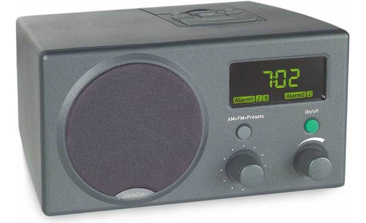

I've got a older Boston Acoustics "Recepter" clock radio.
Nice little product from them, and very impressive, robust tone quality even today.
However, when "turned off" it still draws 50 watts, and about the same when "on".
Not a nice thing in my opinion, so I use it down at my workbench for tunes, only powered up at that time.
For a benchtop clock radio? 😱
Sorry about your losses JM, you live and learn all the time I guess.
As for that Boston clock radio, yes, it's got a large power transformer in it, and since it's all electronically controlled, plus the clock needs constant power, the mains transformer is always connected to the line.
However, I don't care about the clock, I kill all the bench power when I'm done working there.
What IS kind of neat, every time I power up the bench, the clock always comes on at 12:00 (I don't have backup batteries installed in it) and counts down the time its been powered back on...... so if I'm at the bench for 3 1/2 hours, the clock reads 3:30!
So I know how long I've been slaving and soldering etc.
