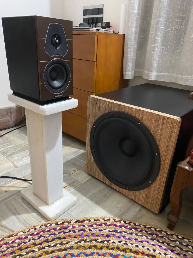

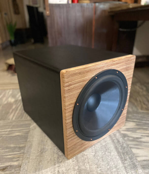

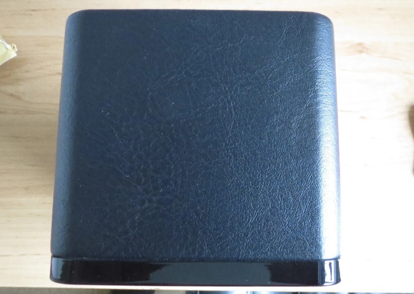

I've used Faux Leather on the body rather than the baffle, inspired by the Sonus Faber Luminas. It could be done on the baffles, but the corners would be a challenge, takes practice and patience, but well worth the effort if done right.

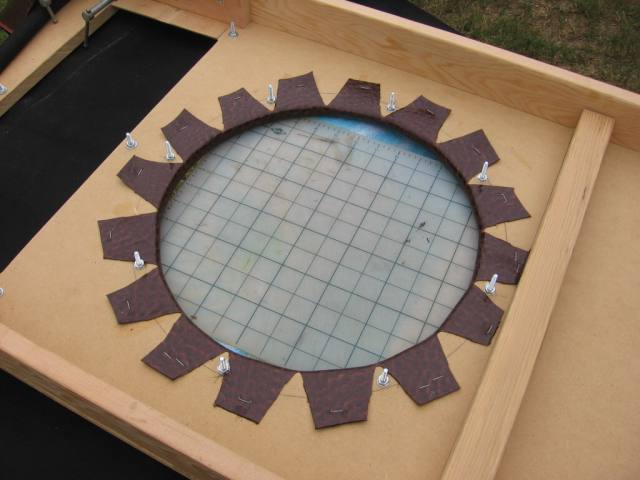

Shouldn't be all that hard I would just make sure to use .5mm leather also would need to use a water based glue that can be reactivated with heat. You could also use thicker veg tan and skive around the holes till your down to .5mm or so then just wet it and mold it into place with the driver.

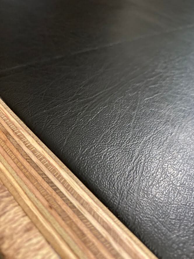

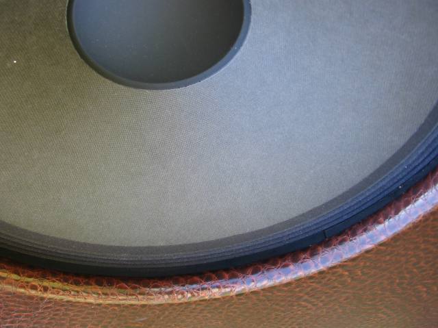

I really had no major problems with vinyl, it's thin - about 0.5mm I think, so probably much easier than leather. The vinyl wasn't very stretchy, either, maybe leather is?
Staples and some glue, IIRC. My wife helped, she is much better at these types of things than I am.

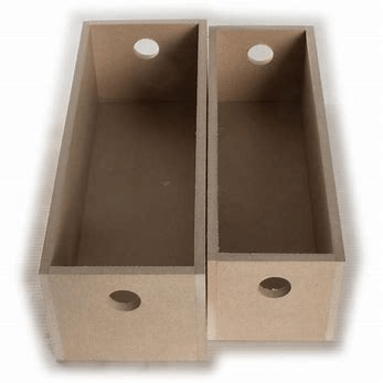

Looking at these MDF boxes as examples- think of the top of my speaker as the inside of this box. (not as much ht)
I made my speakers with additional length sides, with top & bottom (same ht inside). I think I added 1".

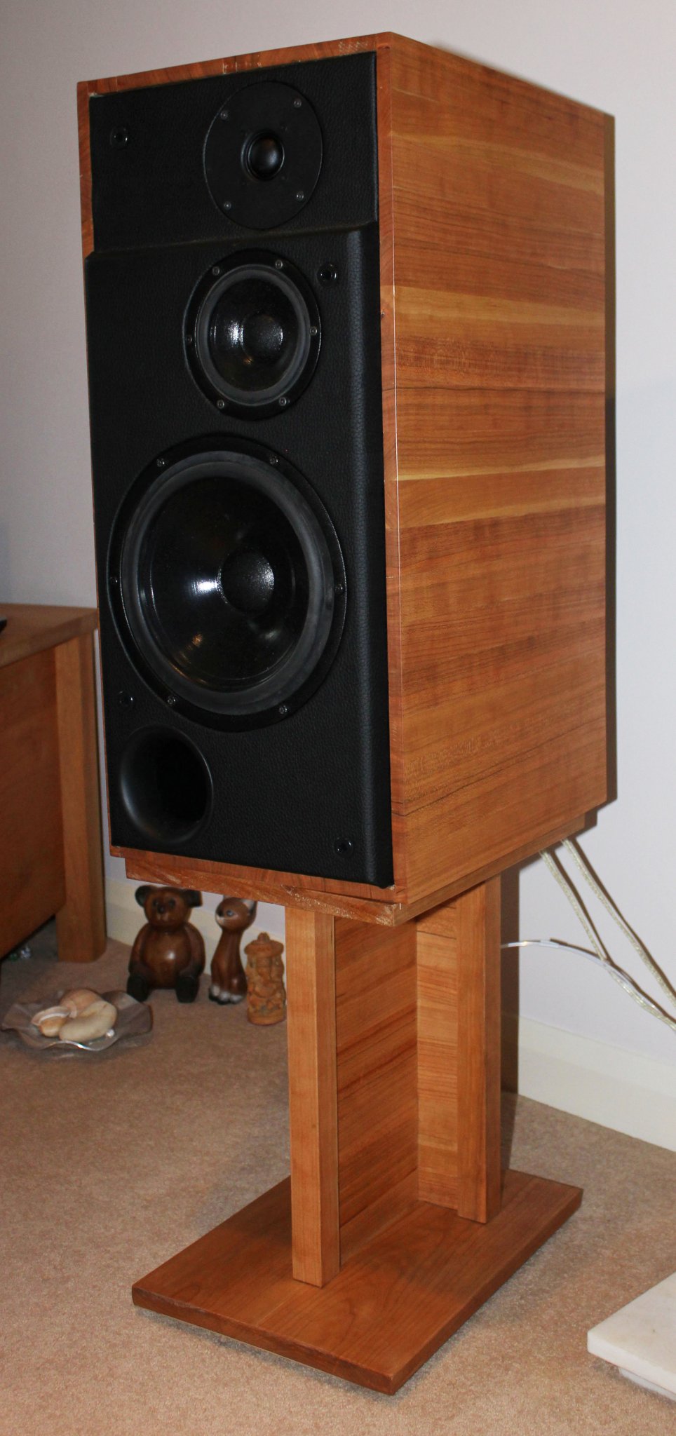

I finished the baffle of my Troels Gravesen's SEAS 3-Way Classic Mk II with black leather.
I made up the baffle separately to the rest of the box, stretched the leather over the front then slid it into place just inside the cherry outer casing, so that the edges of the leather were out of sight. It was tricky, especially with the stepped baffle, but it ended up looking reasonable attractive.
Alex
