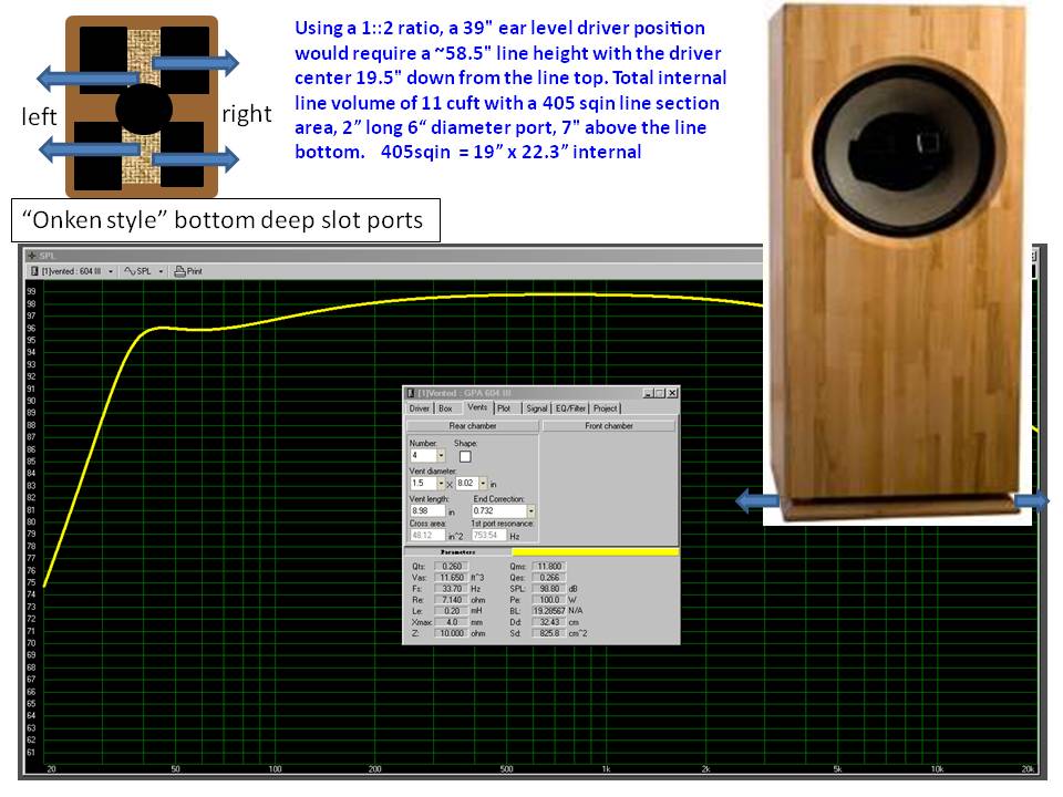

Genius Designer Jean Hiraga's Altec 604E speaker uses a down-firing port that is slot-loaded into the integral base plinth.
Jean’s description sounds like Onken type narrow slot ports(low frequency filters) that exit around the bottom perimeter on 2 or 3 sides. The bottom rear is sealed.

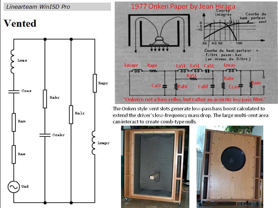

With tools like WinISD and Transmission line Simulator, the subtle difference between a "MLTL termination port", “ reflex ports” and a “low pass filter” cannot be accurately modeled. I hope your research will aid my education.

In this article it is true that Hiraga states that the Onken enclosure is not a bass reflex but a dampened low pass filter.
The second one was also written by Hiraga in 1982 and describes what is called "la petite Onken". This enclosure use an Altec 414. In this article, Hiraga dont speak anymore of dampened low pass filter. There are some formulas given by Koisumi but which differ from those of Small. Some are missing because Koizumi wants to keep them secrets and it is impossible to understand how this enclosure was modeled.
The last one was written in 1982 by Jacques Mahul, who founded the Focal entreprise. This article describes what is called the «mini-oaken» (link). This enclosure uses the 10C01 Focal loudspeaker.
In this article Jacques Mahul has study the «petite Onken» and found that it can be considered as a vented-box following Snyder alignement with Vb/Vas.Qts^2 = 6.34. The mini-onken was designed the same way.
One must be remembered that the original Onken enclosure was designed by Koizumi in 1965. It was before the work of Thielle and Small on vented-enclosures which take place in the early 1970. It was therefore not surprising that the modeling differs.
